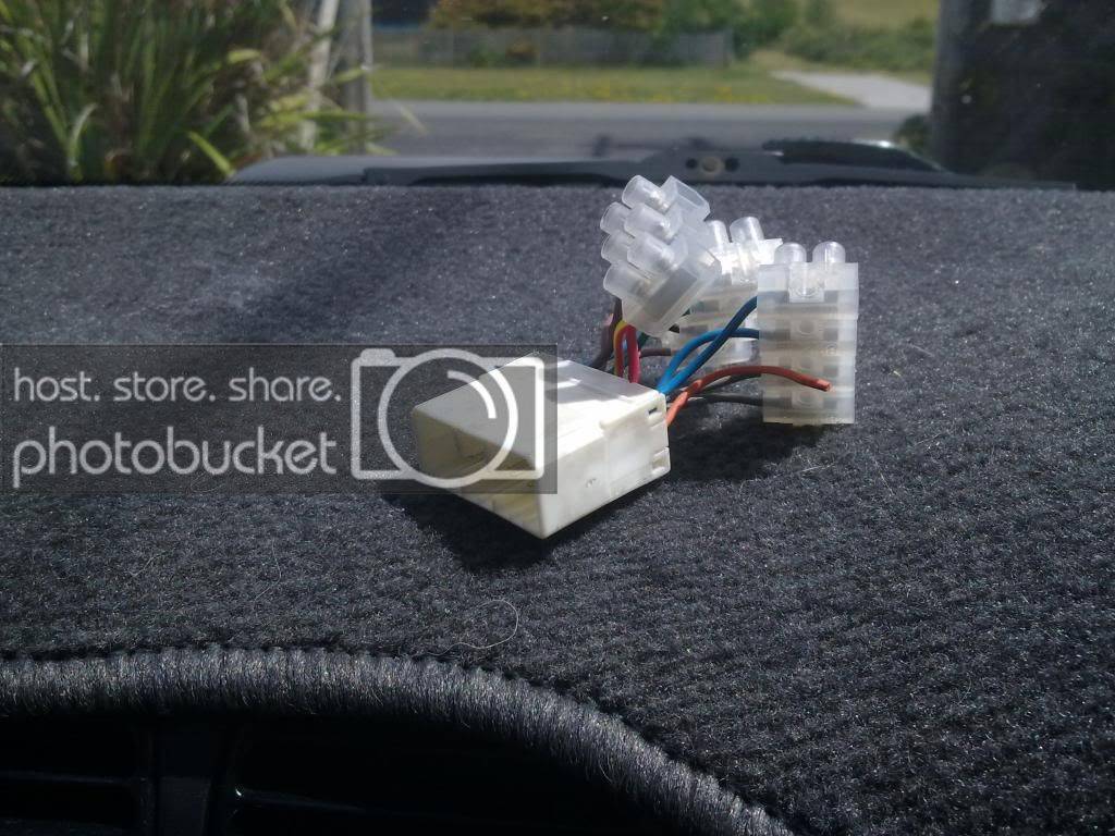

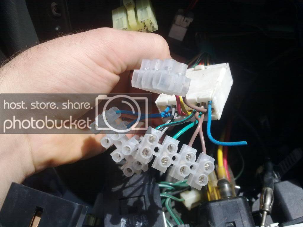

Had no issues removing all covers and what not, nor any issues with making the stereo fit... However just an issue with the wiring harness, it seems the one they installed is 110% dodgy as.... LOL! Look at how they did it:
And the harness on the Sony Xplods colors did not even match the wires on the adapter that runs to the cars harness.... Never the less i have fixed the issue //content.invisioncic.com/y282845/emoticons/smile.gif.1ebc41e1811405b213edfc4622c41e27.gif Now i am just waiting for the arrival of the amplifier and amp kit. I have fitted the four speakers to their custom boxes.
