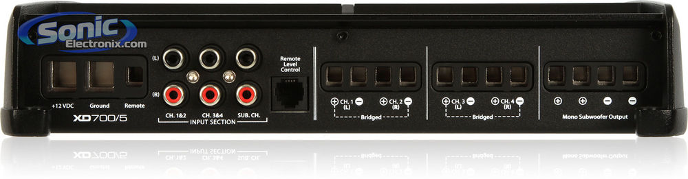

I've been looking at amps on sonicelectronix and I've filtered them to only show amps with a pre-amp output/pass through and I'm looking at the pictures of the amps and I can't find the extra output.
For example -
Where the hell is the pre-amp output/passthrough?
