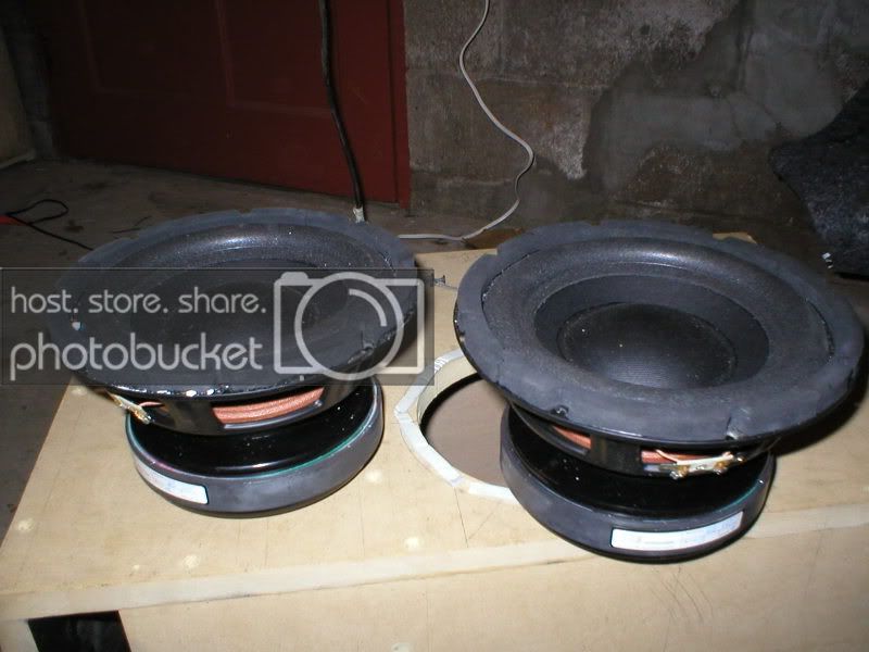

it felt like it took me forever to find some 8's that i wanted to pay a decent price for
8.) these are the tang band 8's
9.) another shot
10.) them in the box. the box is a moe lester design......... 1.65 cu ft @ 28hz. the box is little but heavy as fuc!!
