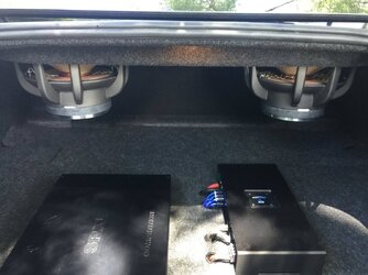

I recently purchased a 2006 chevy cobalt, and to my surprise, the car battery is actually in the trunk of the car. I planned on adding 2 Massive Audio GTX124's on a Brutus amp in the car I am also using copper-clad wire (yeah, I know it's bad), but I worry that all the juice from the battery will go straight to the subs instead of the car's other electrical needs. Should I find a way to mount another battery in the front of the car, or is there another way to go about this? Thanks all.
My battery is in the trunk spare tire well.
