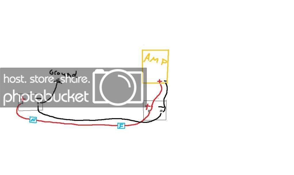

This is the correct way to wire up another battery right? Is the 2nd fuse necessary? I dont have the ground the second battery again, it will ground out through the other battery?
2nd fuse is necessary. and i would also fuse the wire from the battery to the amp. i don't like un-fused pos wires. bad things happen to them

depends on how much power you are running. i only have the pos run and neg thru chassis. aka both batteries grounded to chassis so i have no neg run (for now).
u dont need to run another ground. look at my pic. u only need a pos run and just ground the second batt to the chassis

it's debatable. it depends on how well your car conducts the electricity. personally, i say if you are 2-3k+watts i would go with a pos and a neg run between the batteries.
they say u need a ground wire as big as a neg right??? ok well if u have 4 1/0 wires run back there for pos and only one 1/0 ground then what do u think is gonna happen....
same = same
and yes, you want them to be equal. thats why i wouldnt recommend upgrading to 2 runs pos and still running the neg thru chassis. that creates a bottle-neck. if you want to run one pos run, and ground to the chassis, that is (generally) ok. but more pos runs means you need more ground to complete the circuit. so (IMHO) if you run 2+ pos runs, you should do the same for the ground
