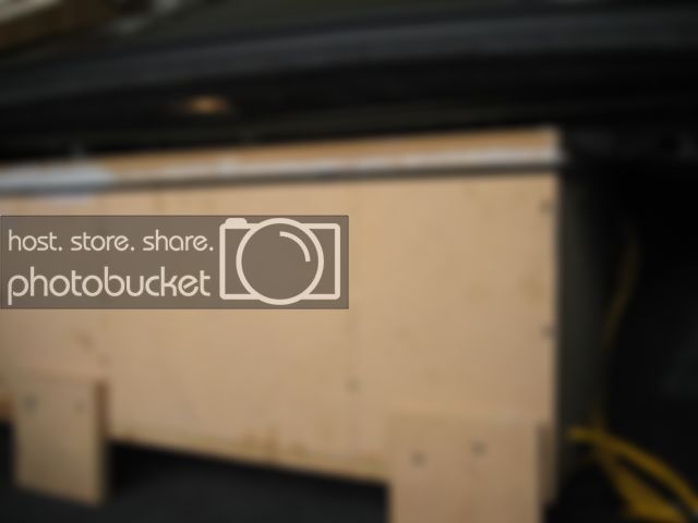

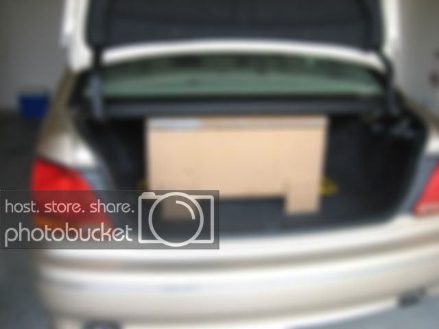

i built a box (designed by mob) and i didnt add the plexi glass. now i want to. is it possible to do it with out ruinning the box?
here are some pics:
so cut where i want the plexi to go. then through the back cut another hole. stick the plexi through there and drill it through that hole to the front? and then ad a second piece of mdf to the back to cover the hold that i made to get the plexi in?
its a 4rth order bandpass by the way. so its all completely sealed up. except a whole at the top where an aero goes through.
i was thinking about cutting a hole where i want the plexi and then using a large piece of plexi to kind of "patch" up the hole. it wont be flush to the box or anything, but thats the easiest thing i can think of? too much maybe?
yea basically cut the hole lets say 10" high by 15" wide make a second mdf baffle full height of box included top and bottom. then cut the second mdf larger like 12x 17 so the plexi will fit inside it nice and flush.
lol a little confusing but i think i got it. i guess that could work. **** i should've added the **** plexi to begin with!!!!
