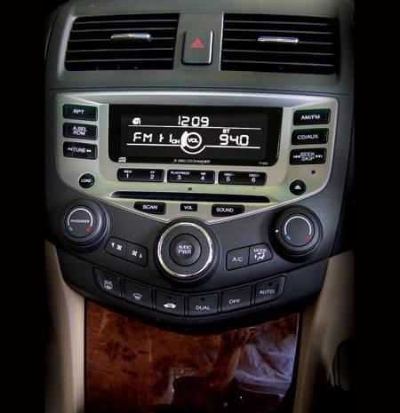

[quote name='Boomin_tahoe']@Jeffdachef another one lol
I'm wondering how a stock HU has the climate controls? Should be separate....unless it's within the same area. Can you post a pic of the stock HU?[/QUOTE]
Boy do I hope that "another one" is not a bad thing, heh...
Here's the stock head unit/radio:
Boy do I hope that "another one" is not a bad thing, heh...Here's the stock head unit/radio:

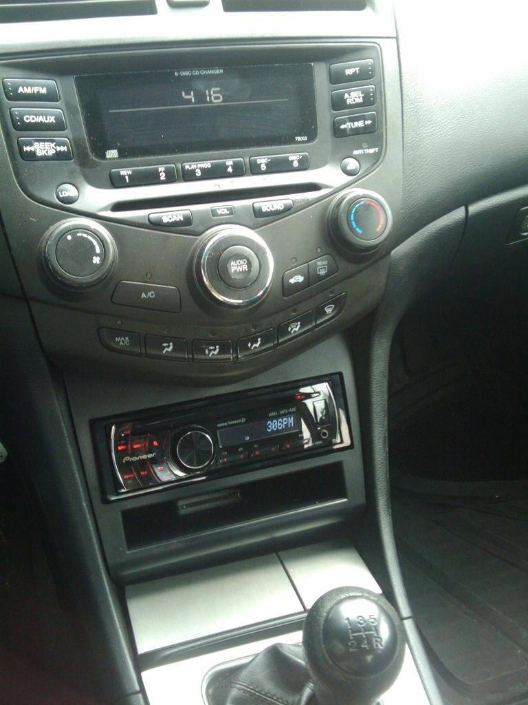

Holyshit...how would one disassemble that? These newer vehicles, they're getting harder and harder to work on and sometimes even impossible to add aftermarket anything.
That bottom Pioneer HU looks idealish tho...it looks a little modified, a Metra kit or Scosche kit would be needed.

@Boomin_tahoe
Can't really disassemble that. Well, technically you can, I mean, it's possible to take it apart, but I certainly wouldn't... :)
As far as the Pioneer pic, it is modified, yes. Those 'adapters' don't cost much. A quick google search netted this:
https://www.amazon.com/gp/offer-listing/B000KL113O/ref=dp_olp_0?ie=UTF8&condition=all
$25 is pretty reasonable, but I'd have to find one EU-side, otherwise I'd be paying a 'ton' to have it shipped (relative to the item price at least).
