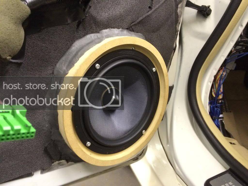

-Image Dynamics CXS64 V.2

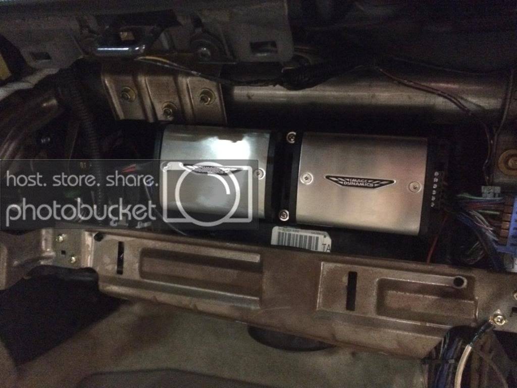

For the front stage, I'm taking the FL and FR signals (full range) directly from the factory headunit. For the sub, I'm taking the factory SW signal from the HU. The factory amp has been completely removed. In its old location (passenger kick panel), I soldered RCA ends onto the speaker wires from the HU (using Kicker KISL RCA adapter and Rockford Fosgate RFIF2SW). From there, Stinger 4000 series and Stinger 8000 series RCAs are run all the way back to the trunk on the passenger side (away from power wire on the driver side).
Both amps are receiving power from the battery via distribution block. Both are grounded to the frame (sanded) via distribution block.
The front stage is using passive crossovers (installed behind glovebox), and is being powered by the F300 (4 channel, bridged). The sub is powered by the M500.
