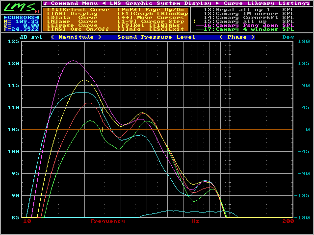

I do have Camry measurements although i think this is a 2000 camry. Also this is not the transfer function but the response in vehicle. There are multiple curves based on which windows were up and down and unfortunately it's not so clear as the colors don't all show in the legend.
You can go through some of the measurements here and get a close idea in a round about way. There is a comparison between the regal and camry. Then there is a transfer function for the regal. So between the measurements you could get close.
