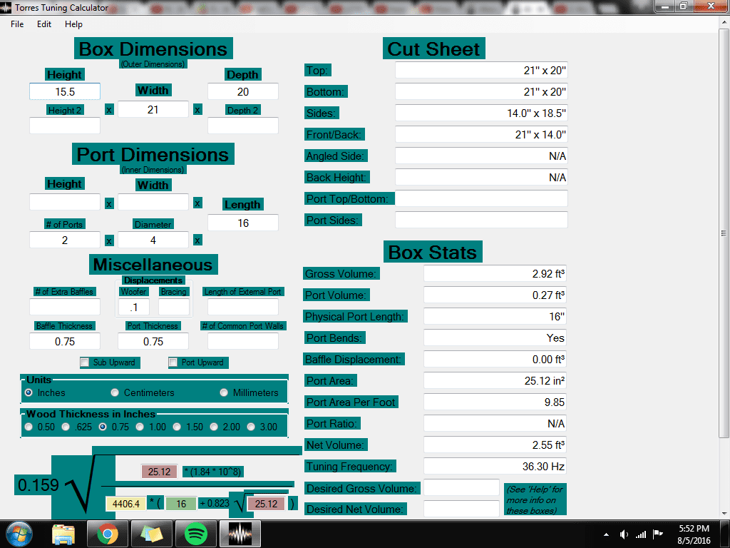

Do you know the answer to my original question? I want to go to HD tonight to get it all cut out but idk how I should have them cut it.

here's a cut list
