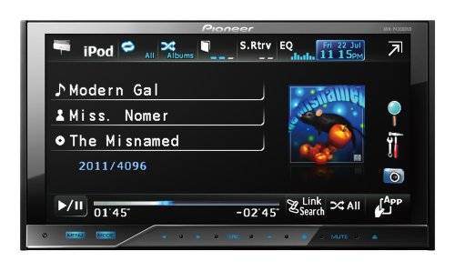

yep, din is a standard used to describe the outer dimensions of the head unit, mainly referring to the height. The images I linked in this post show different widths, but that’s only due to scaling. Both units are the same width, but the bottom one is exactly twice the height
single din
double din (aka 2 din)
most touchscreens are double din
