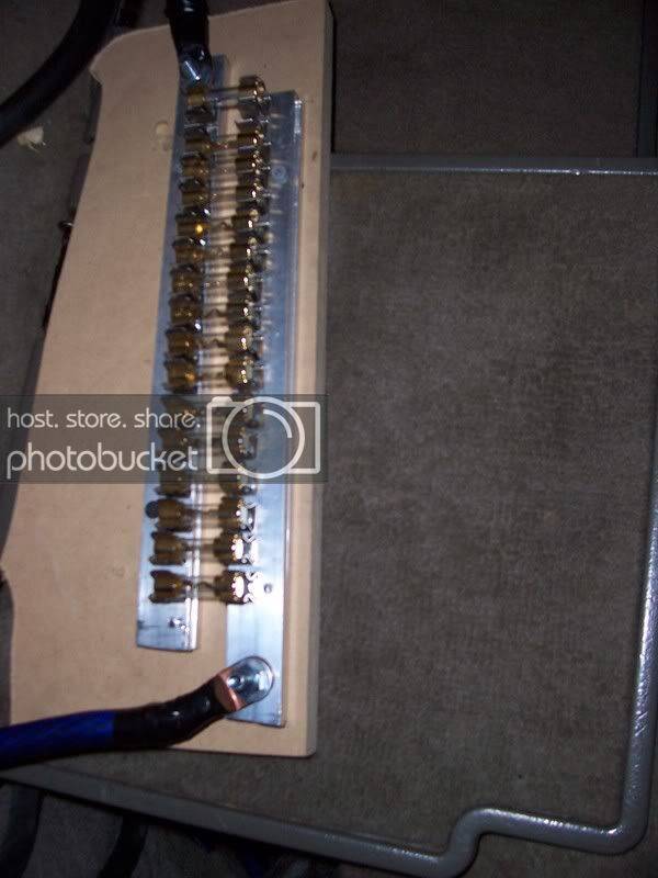

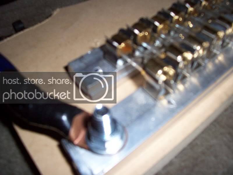

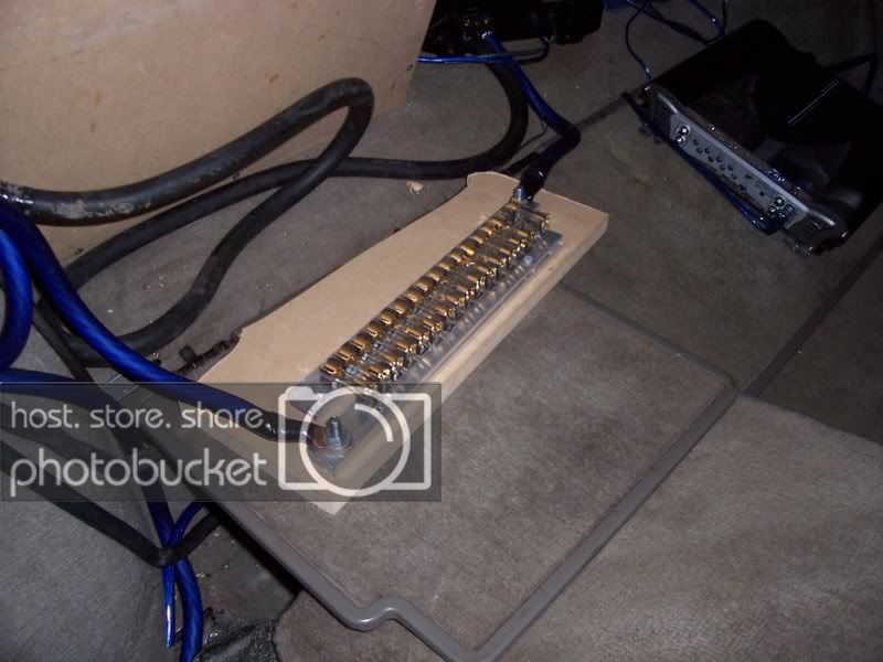

A real fuse block *pics*
Lakota
Doesn't Know $hit
Just thought that I'd share:)

My team is running 3kW+ of power on 55A of fusing or less. As far as the current draw, I haven't clamped any of our amps yet. But, I do know of a competitor that is running 6kW of power off of this same setup with 55A of fusing:) The block in the pictures is from a Blazer that does a 146.5 (should do more soon) in AS2 with a Powerbass 3000 amp @ 0.5 ohm and a hdc315. Keep in mind that score is with the car off, music and a single battery. A 2500.1 and Type R is in there right now and it just did a 146.0 at a show.

Is a fuse setup like that harder on your equipment, would you use something like this in a daily??
so headrest is better than dash, guess it makes sense, my car gets louder if I sit up in my seat (I ride reclined a bit)
The headrest is typically the hardest place in the car to meter. There's nothing wrong with using a fuse setup like this for daily. The only thing is that it's better to use these fuses for a show because if you pop all of them it gets expensive. We throw in bigger fuse ratings for daily.
