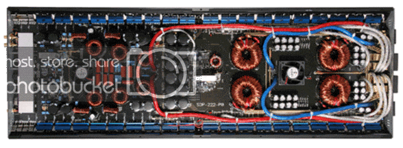

dont wanna burst any bubbles about those amps peeps but they are chinese built not too bad but for the size and money i know you can get ALOT better as we do here in oz we use 5000rms and 7000rms aswell as a 9000rms all built for us buy Offcourse Zenon and they are still beating most things for outright power and useability here in oz
zenon built amps i mean
There were amps in the 90s that used the same principle. The principle is that the voltage rails that the output devices modulate to create the output signal varies with the signal instead of being fixed. The difference between the fixed rail voltage and the output signal voltage is where you get your output stage losses in a Class A or A/B design. By varying the rail voltage so it is only fractionally higher than the output voltage, the losses are minimized.
Just curious, what amps in the 90s used this principle in their designs? I don't recall seeing any, but I really wasn't into audio much in the later 90's only the early 90's.
my friend Zenon based amplifiers are everywhere now.
there is nothing overly special about them
every company and their mother use that build house for their amplifiers //content.invisioncic.com/y282845/emoticons/laugh.gif.48439b2acf2cfca21620f01e7f77d1e4.gif
there isnt really a need to even list them //content.invisioncic.com/y282845/emoticons/rolleyes.gif.c1fef805e9d1464d377451cd5bc18bfb.gif
they are good amplifiers but they are not the be all and end all that you make them out to be either //content.invisioncic.com/y282845/emoticons/wink.gif.608e3ea05f1a9f98611af0861652f8fb.gif
