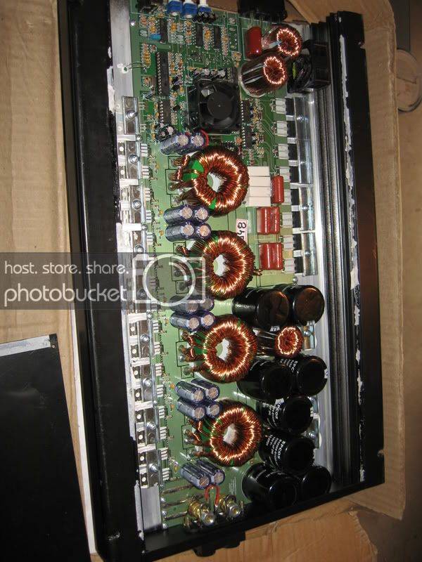

the 12K you guys are refering to
How many watts RMS "continuous" is this beast?? Not 8,000. Thats for sure. Maybe "bursts" but not continuously.
Those Switching Powers Supply cores are only good to maybe 1,000 watts each.
And there are 6? So??? The other 2 cores our output inductors for what is known as an "anti-aliasing filter".
Basically a 3 pole filter in the output stage to filter out the "hash (garbage) at slightly below switching frequencies.
Otherwise there would be just ugly white noise coming out the speaker leads.
And I counted 12 devices per side for switchers. Even if they are 70 amp continuous current (like an IRFZ48 device)
that is 840 amps of current , or about 7,000 watts.
And an even BIGGER questions is:

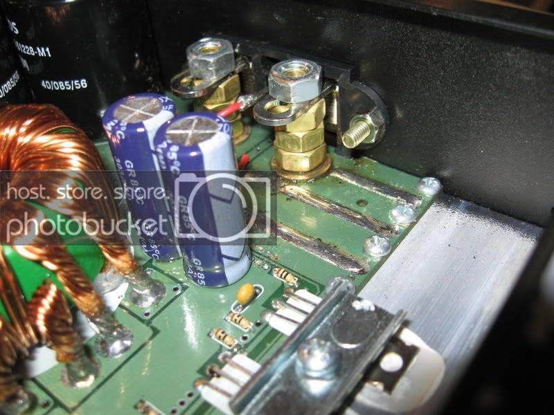

How do they PULL over 800 amps of current thru 1/8 thick PC board? And what gauge wire will be necessary?? Its gonna take WAY more then those "wussy" buss bars, that is for sure.
Hmmm???
And it doesn't matter what they say (or any other amp manufacturer), an 8,000 watt amplifier WILL pull 933 amps.
NO MATTER WATT!! Its Physics (not my fault)..assuming it really makes 8000 watts RMS .
Which is 89.5 volts out at the speakers (1 ohm)
Amp looks good, but will NOT be reliable. Short term, sure. Long term...not a chance in hell.

Whoa! It is NOT possible that this amp swung 130 volts AC out!
Do the math, that is 130 times 130 divided by impedance (even if you use 1) that is 16.900 watts.
Smoking CRACK!!! Look at the devices. 16 FETS (bottom of picture) only 8 are on at any time,
so 8 times 70 amps (assuming IRFZ48's) and that is 560 amps of MAX current draw.
4 cores, the input connections, the "soldered" up PC traces.
16,900 watts or 13,000 watts is 1971 amps and 1516 amps respectively of full power current draw.
Thru that "nut and bolt" connection? Say what?? SMOKING CRACK!!!!!!
I do applaud them for using meters (good ones too!) But no O'scope and no test conditions ,
like what was the load? what kind of load? (meaning speakers or load resistors).
Test tone? All bits high (0dB) What??
Have you guys ever seen 12,000 watts of load resistors!! Neither have I and I can tell you it would be BIG!!!!
And I have seen a LOT of test setups. No one I know (other than Audison in Italy, Kicker and Rockford)
could even power up 13,000 watts of amplifier to test it.
Reality test here folks!!!

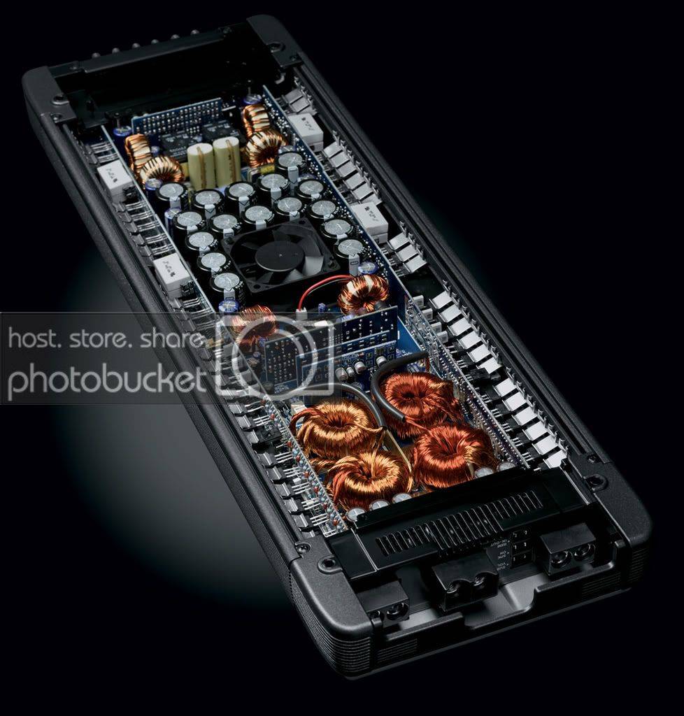

Below is an Audison LRx1.2K 3,200 watts CONTINUOUS into 1 ohm. In the power supply there are 2 pieces of copper one on top, one underneath that cover the ENTIRE power supply area (about the size of a girls hand print) so that the needed 373 amps of current can flow safely...and continuously.
Under the switching FETS are thin ceramic plates to better transfer the heat off the transistors. each device is clipped down with spring type clips.
Thats how it is done for real. It ain't cheap, but it is "da kind" way. (and retails for $2,000.00) And not that big 22" X 8" X 2.25".
