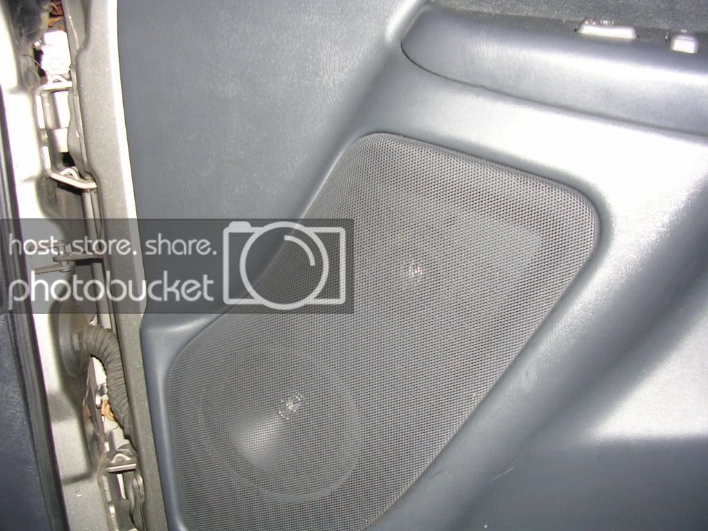

Boston Acoustics 620 (6.5")_Front - Re-used from my previous install
Boston Acoustics FX7 (4x6)_Rear - Re-used from my previous install

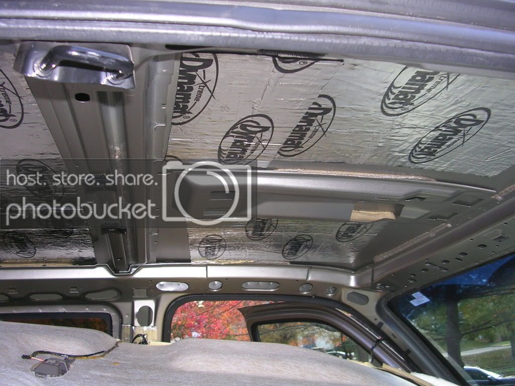

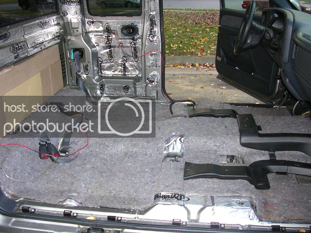

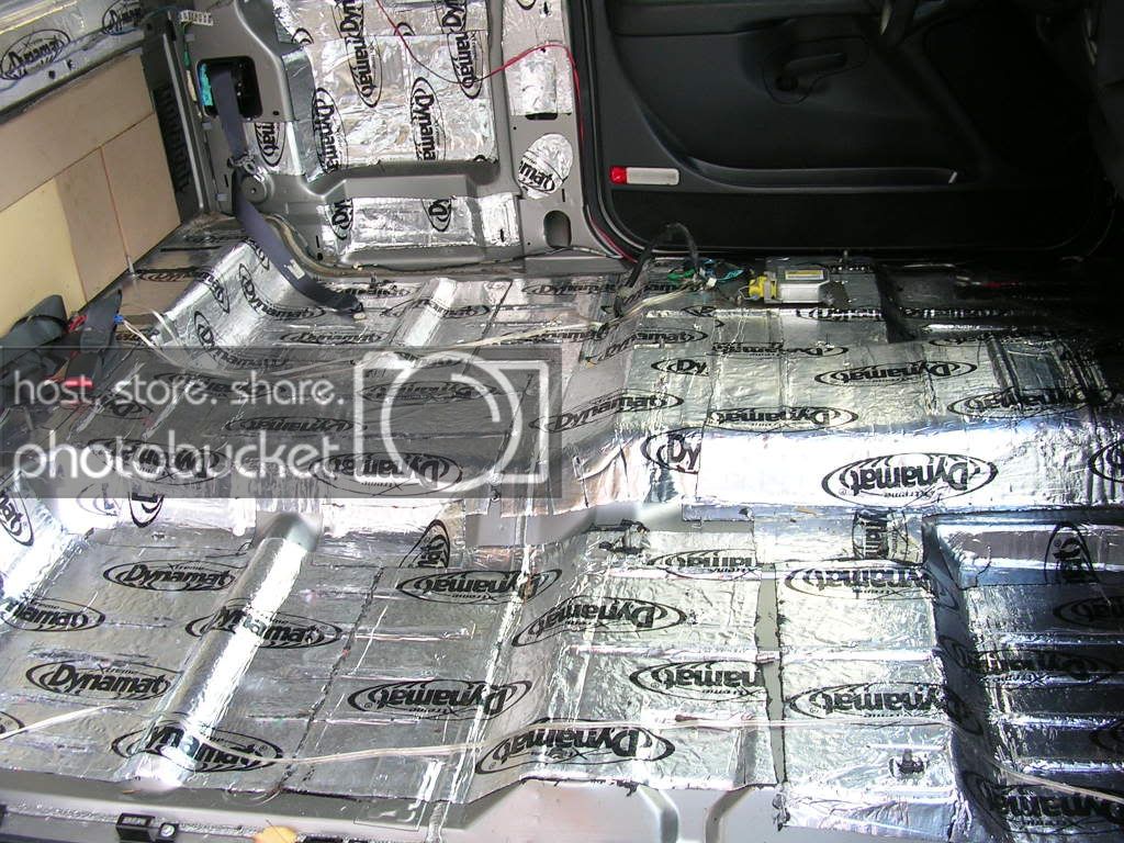

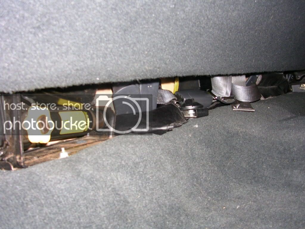

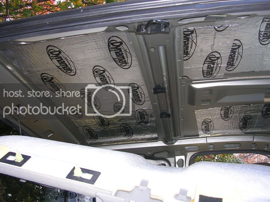

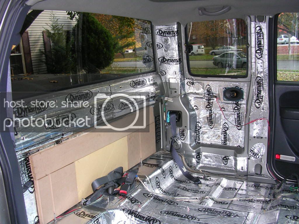

It took an entire day and tylonal to install 4 boxes of dynamat to the entire cabin. No vibrations or rattles at all. However, if you are looking for a quiet ride in a truck, consider covering up the vents behind the seat. I chose not to cover the vents. The ride is not as quiet as I wanted, but at least it does not sound like a bucket of bolts.

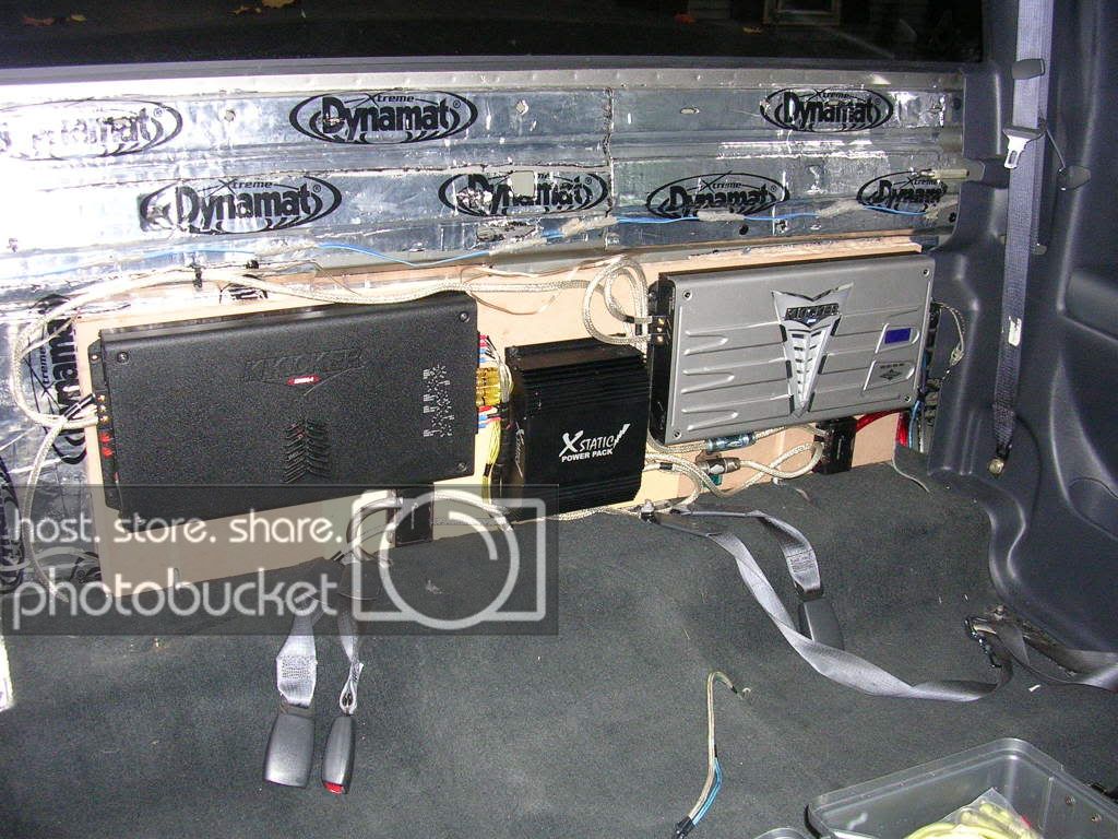

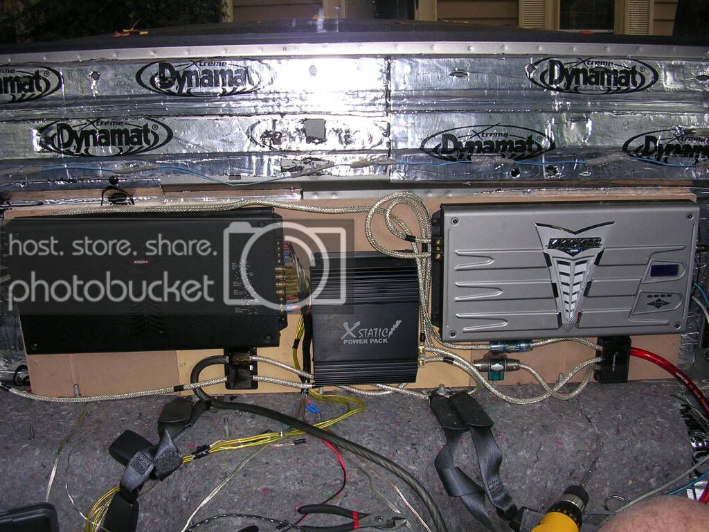

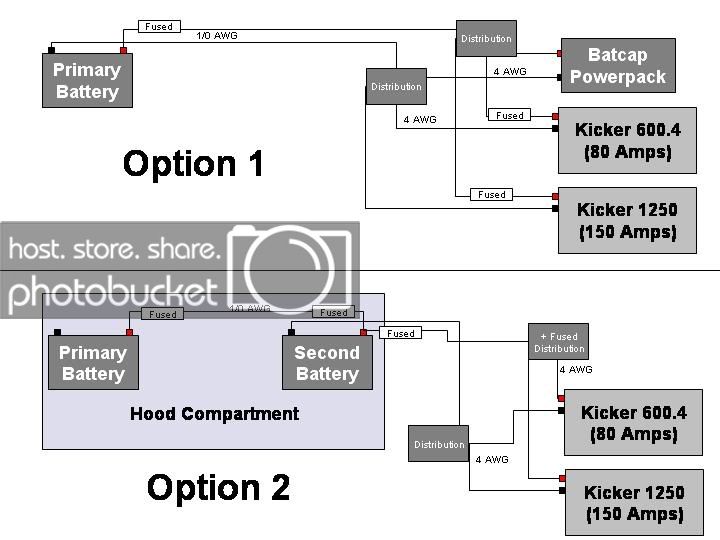

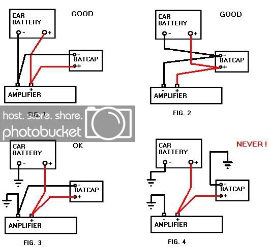

I chose the Xstatic Powerpack (option 1)

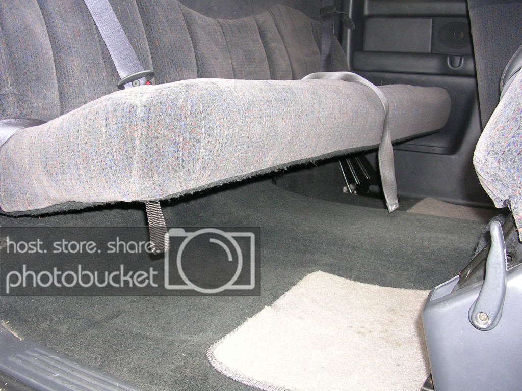

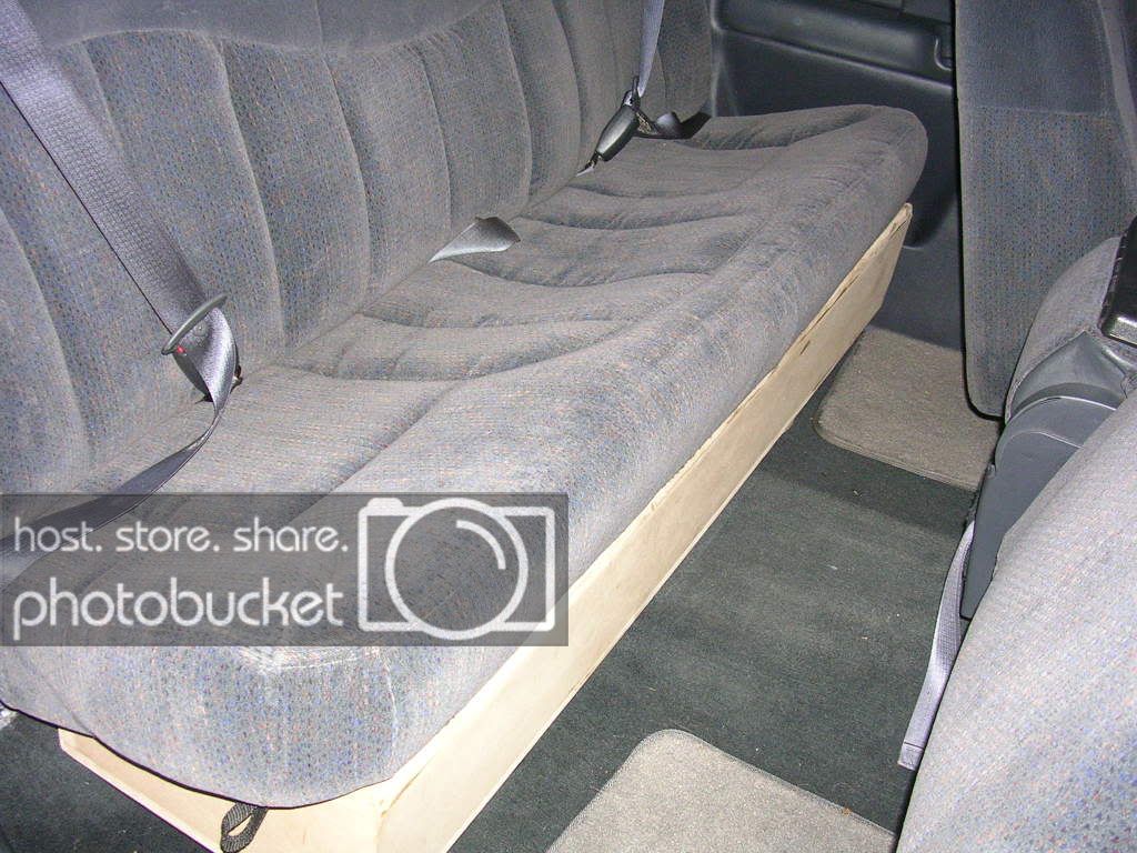

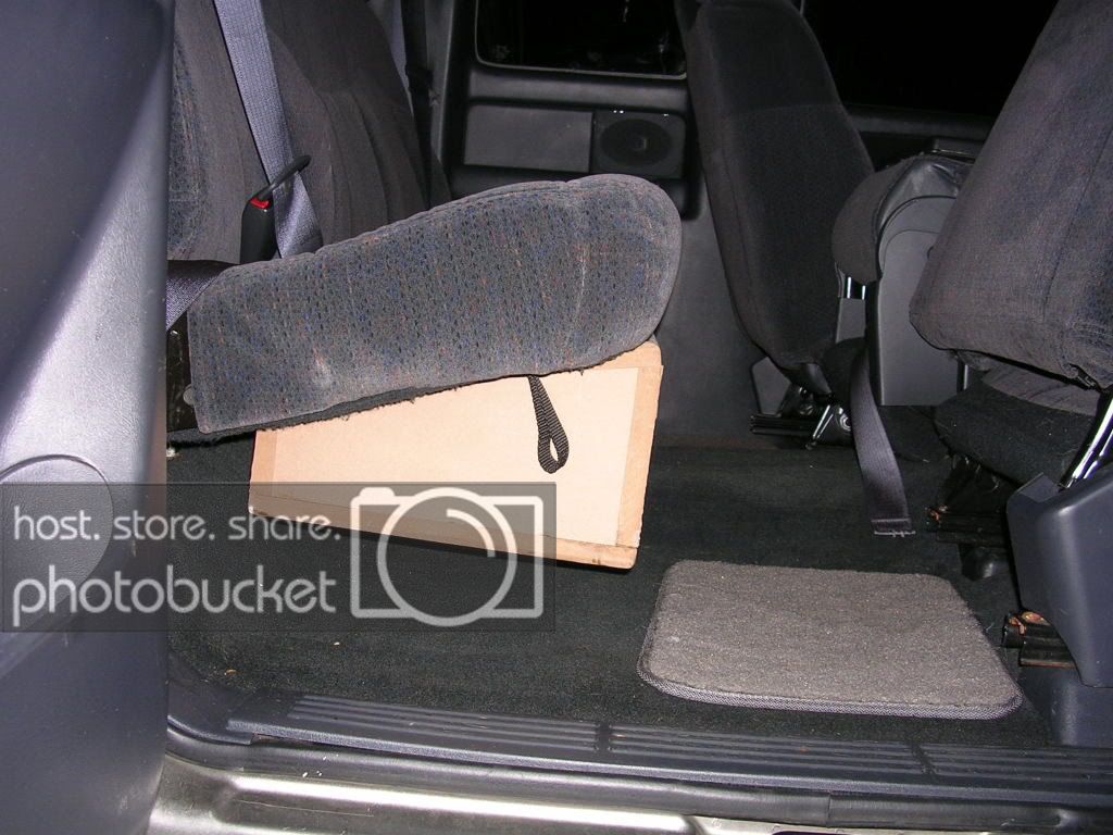

Beneath the rear seat after installing the other equipment.

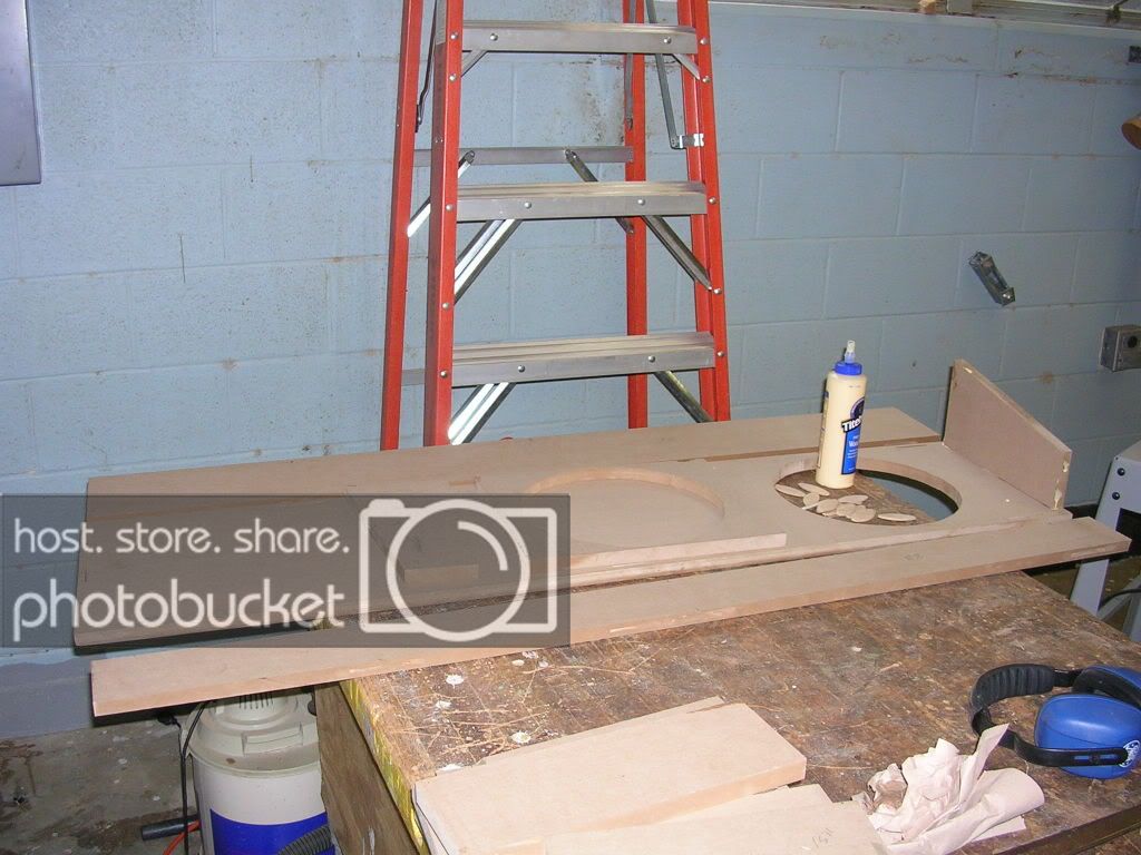

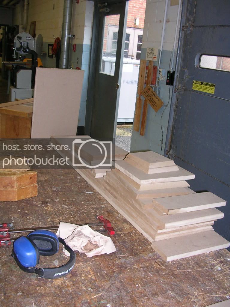

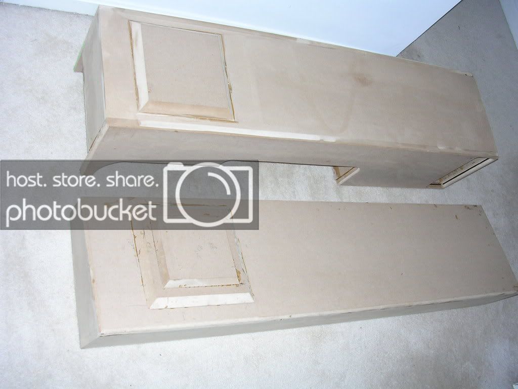

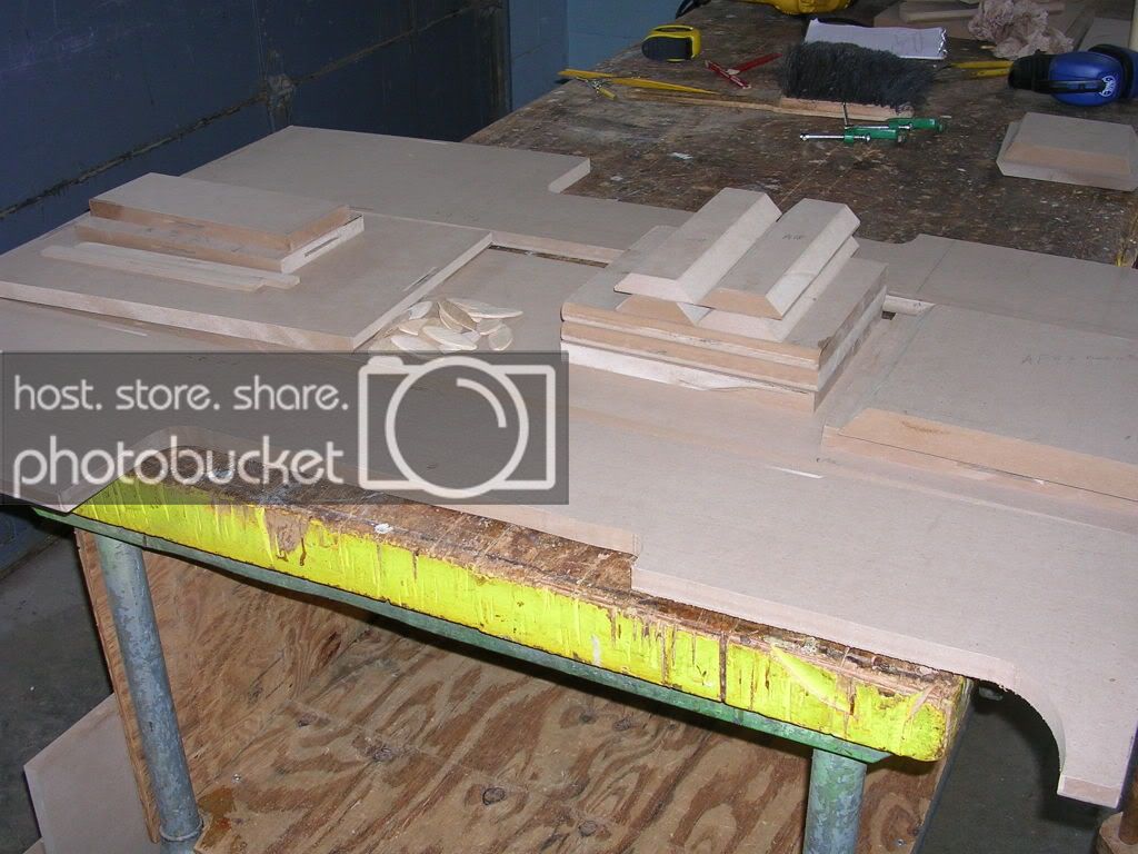

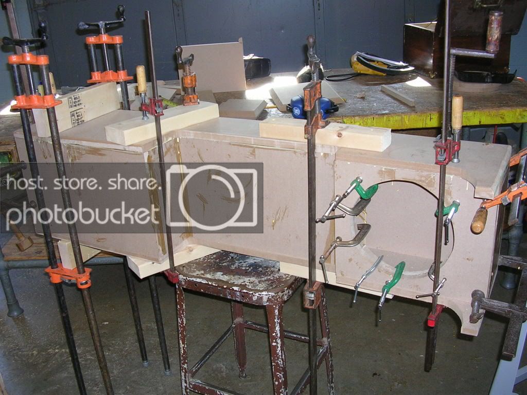

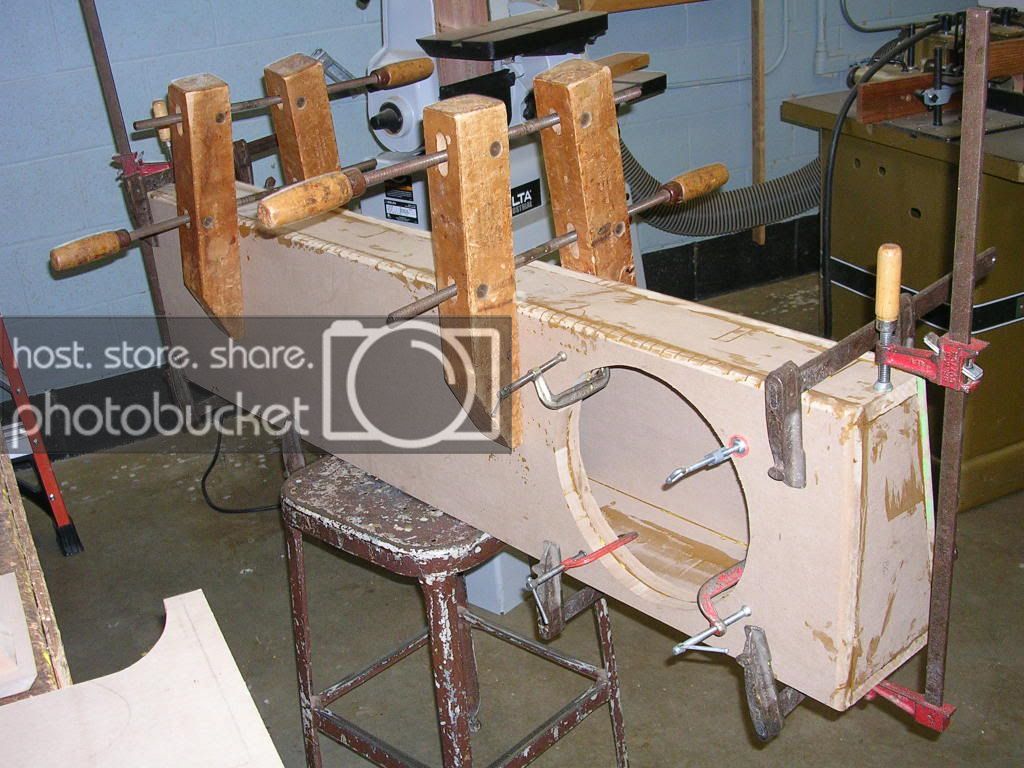

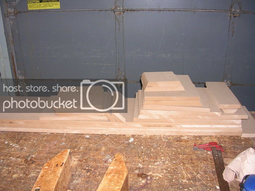

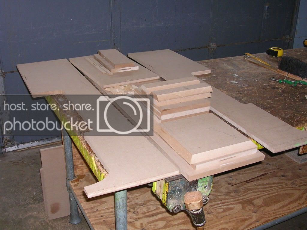

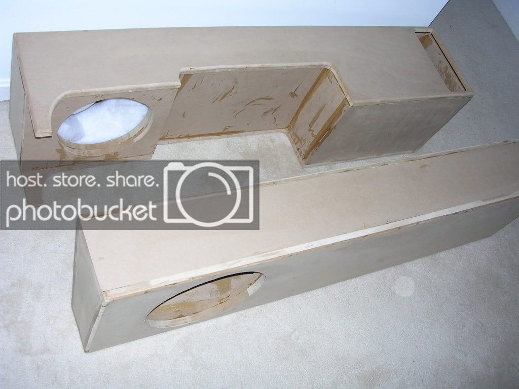

Keep in mind, I did my own calculations and built the enclosures myself. My only disappointment is this...the vent calculator on the carstereo/help website http://www.carstereo.com/help/Articles.cfm?id=31 is not so accurate when calculating vent length. For example, tuning a 1.5^3 enclosure to 35HZ using a vertical slot vent 4"w x 9"h, the calculated length is ~46". If the same vent is turned horizontal, the calculated length is 43"; resulting in a 3" varience for identical port areas. If someone logically understands why, please share.

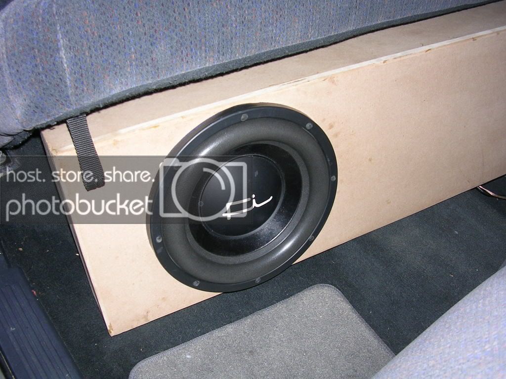

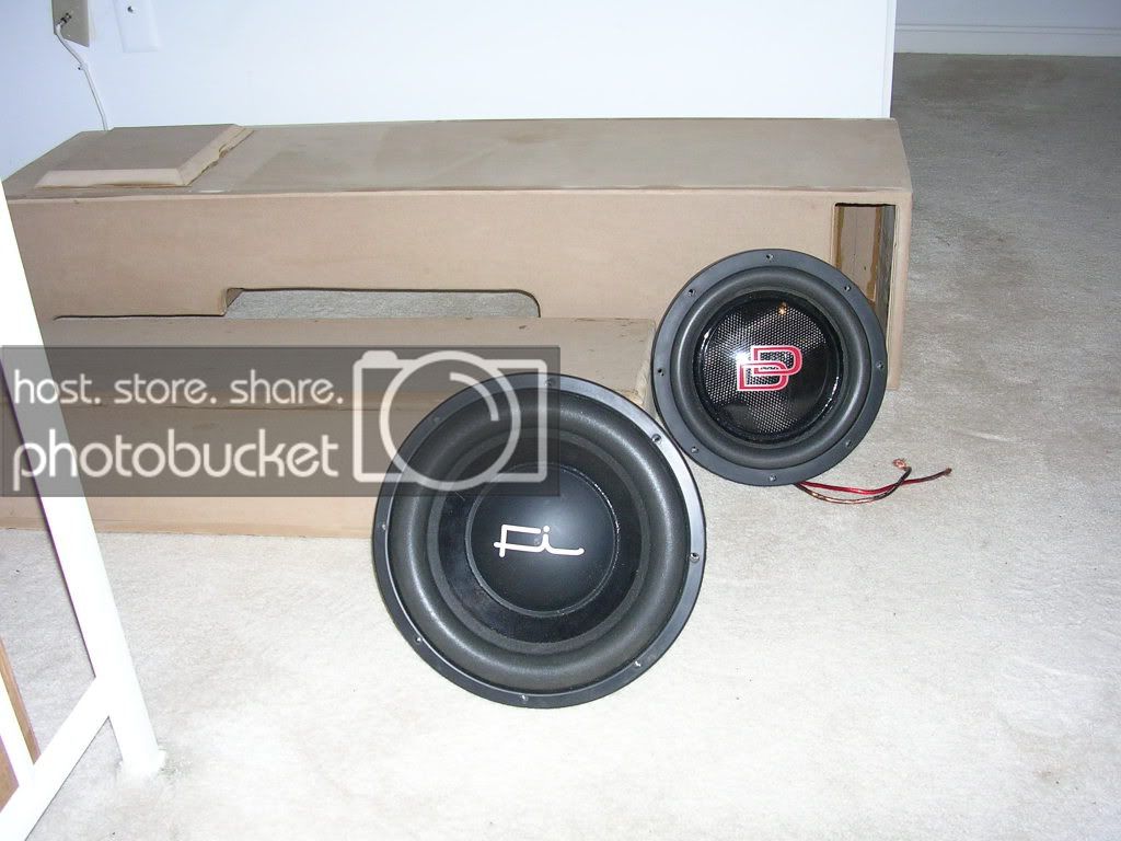

The following two pics focus on the Fi 12Q enclosure...
I'm so glad I paid attention during my high school geometry, algebra and wood shop classes.

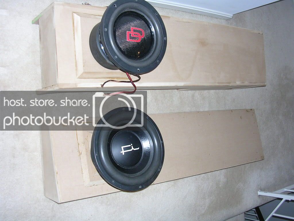

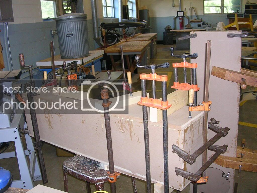

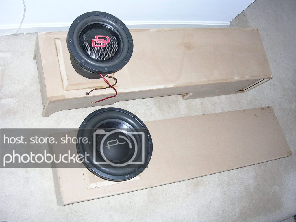

This is the DD3510 build project, with a bending slot port...
I chose to design two systems. The variable surrounds two different sub setups. One setup included Fi 12Q sealed. And the other included a Digital Design 3510, ported at 38hz. I will keep the better sounding design and sell the other.
The better sounding enclosure will receive carpet.
[My benchmark is a Fi 15BL on 2000w in a hatchback.] The Fi 12Q sounds great, but it's still not enough bass. The Kicker 1250 gain is set at 6,5, with a 2.5db bass boost @ 35hz. I hope the system will produce a bit more bass with additional tweaking to the system. However, it sounds so much better than my old 10L5, bridged off of the 600.4.
