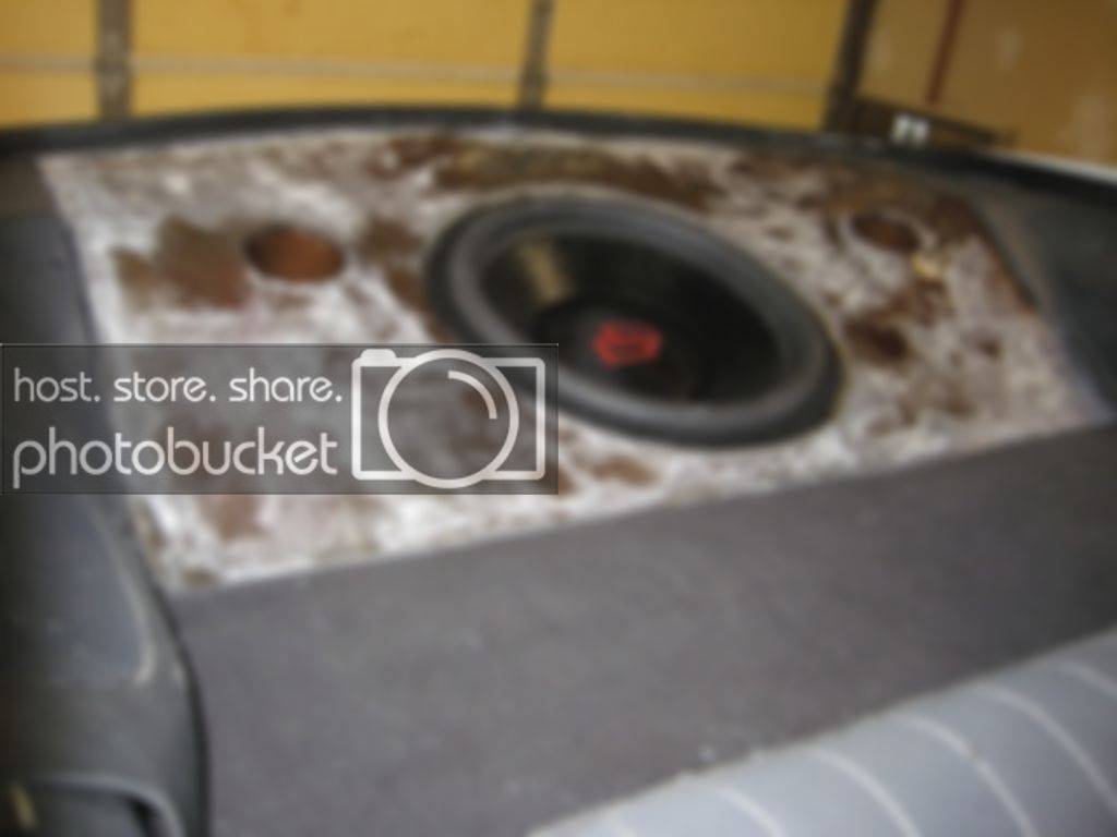

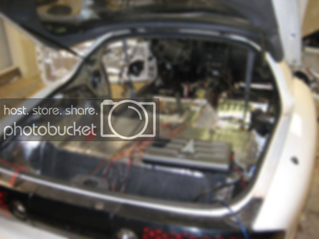

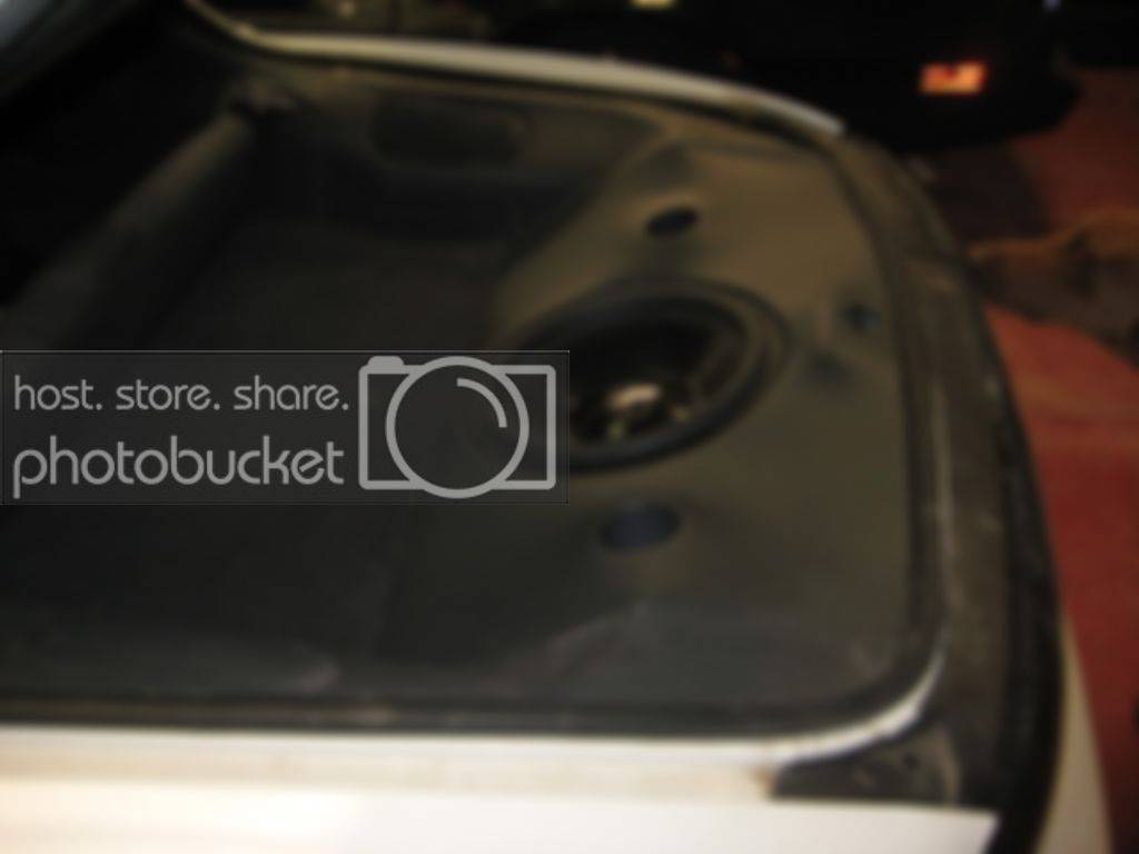

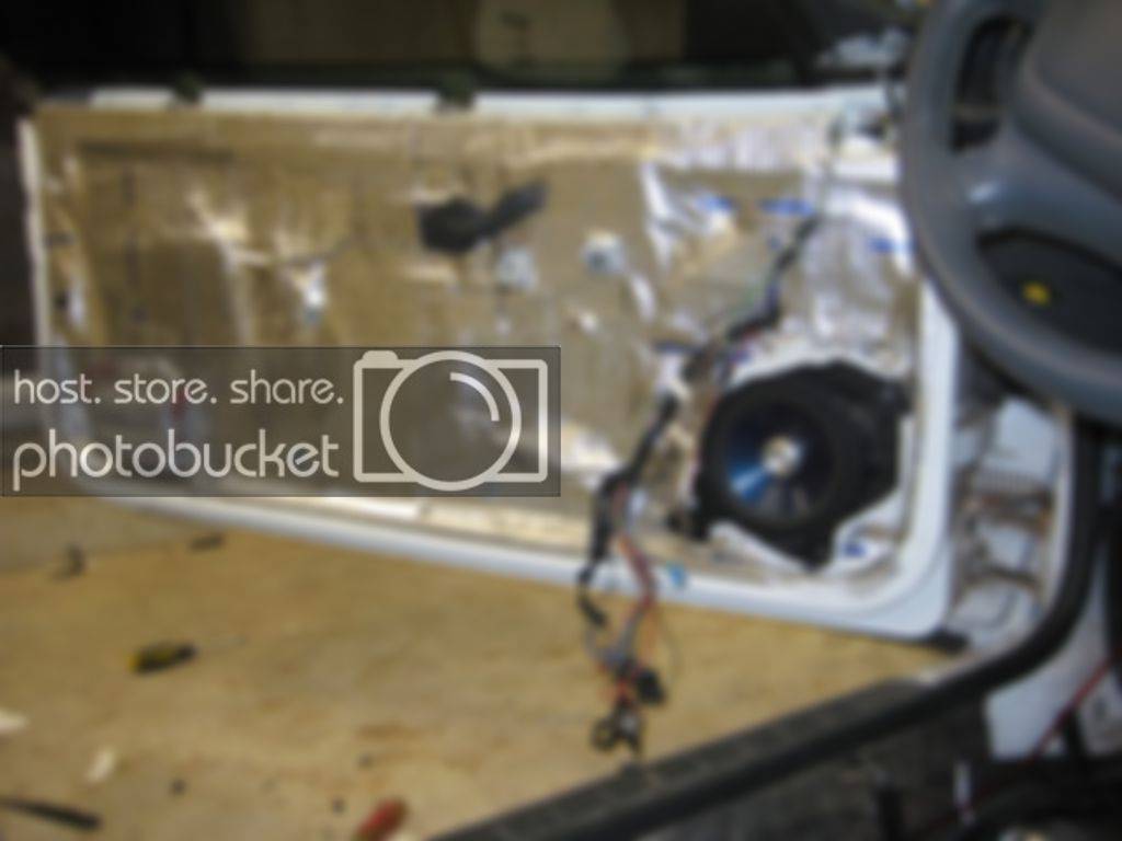

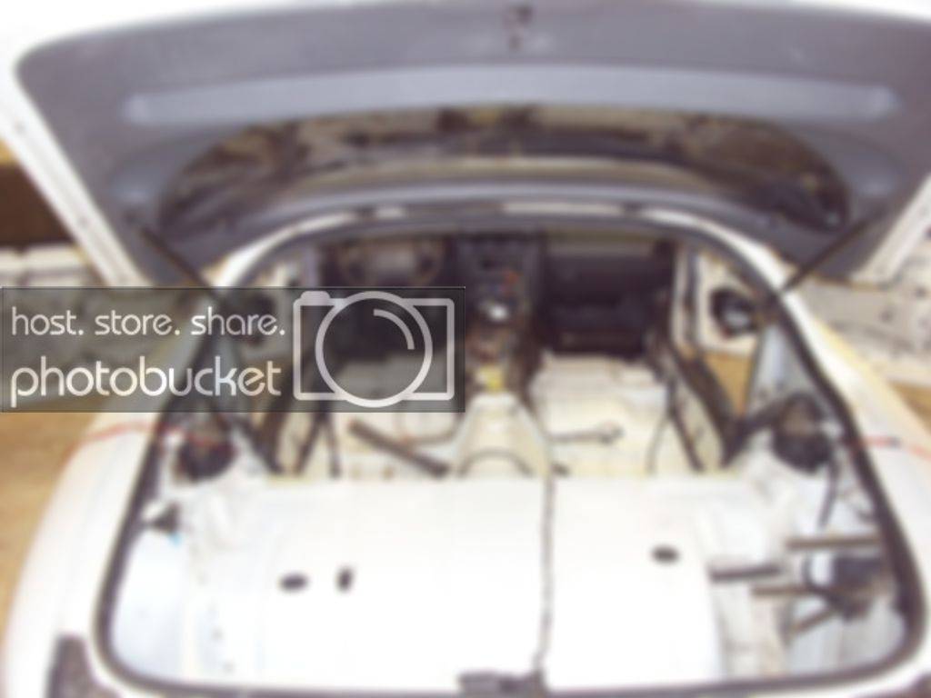

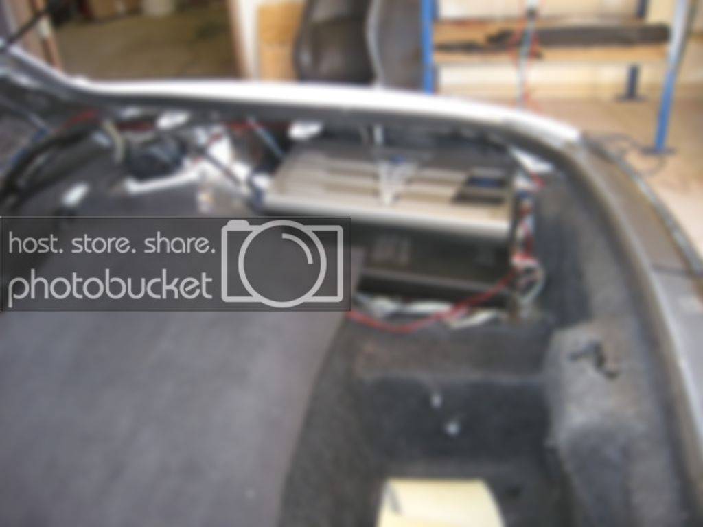

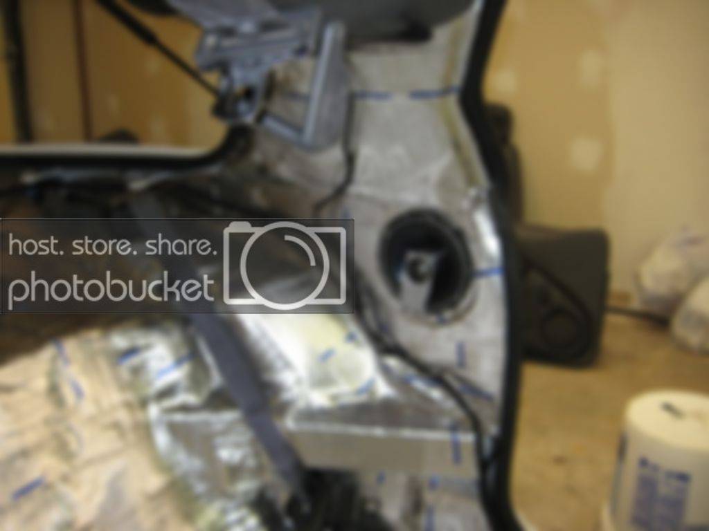

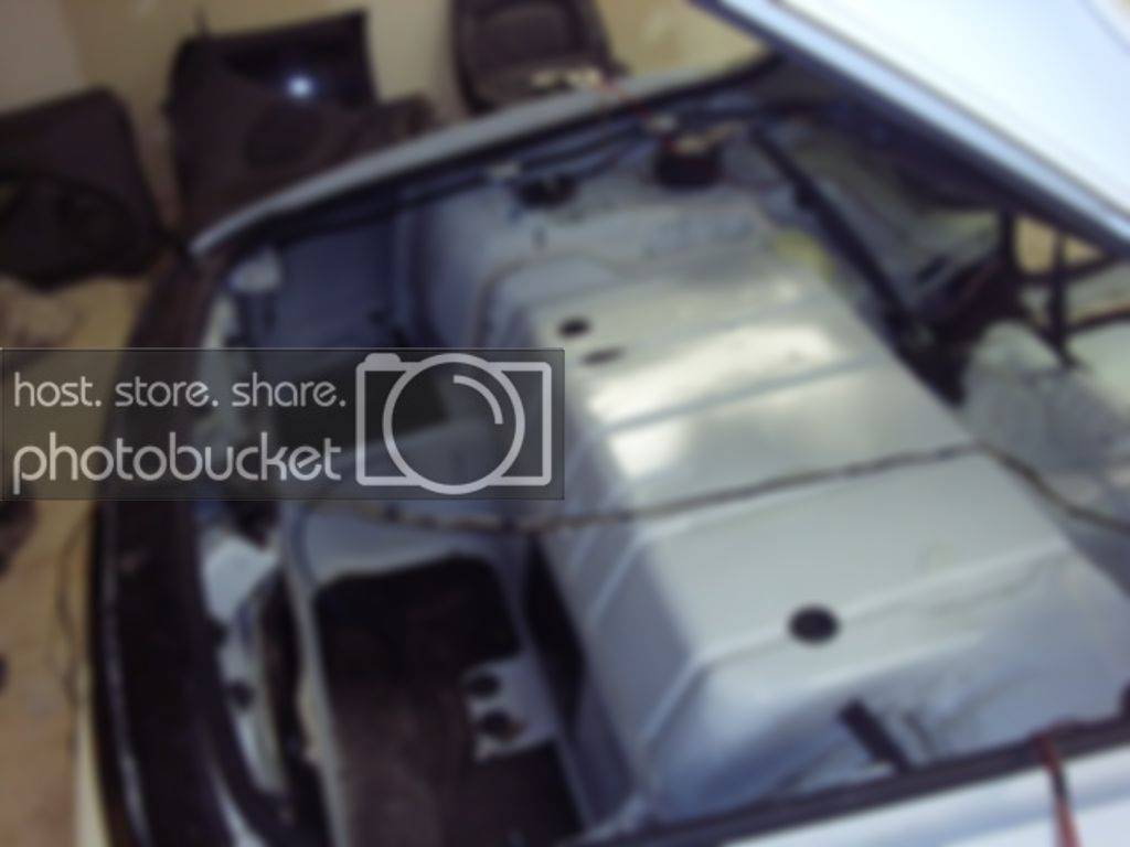

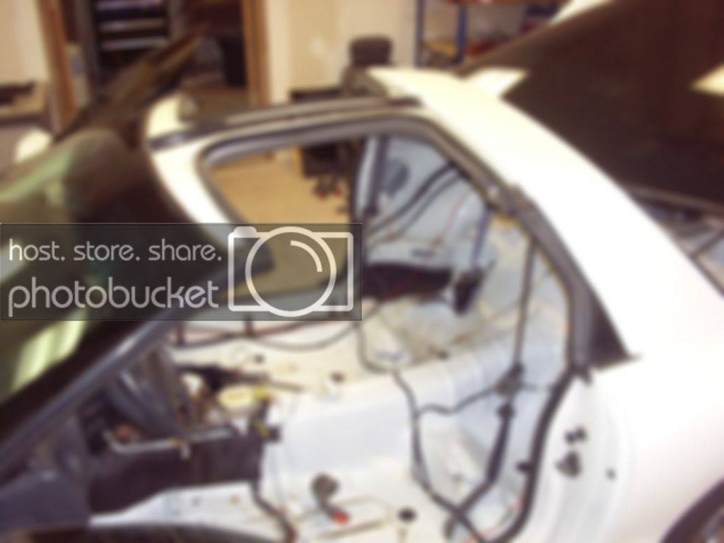

I did all the work myself, just looking for something clean and neat, and wanted to get the most sound out of my limited space. I had several installs under my belt before this one, but this was my first attempt at sound deadening and fiberglass. I started by taking out all the interior and sound deadening every square inch. I used peel-n-seal roofing material for sound deadening, and I think it has worked well. It stuck to everything well, only smelled for the first few days, and didn't come loose during the hot days of summer. I used 200sqft, about 3 layers total.
I used four boston pro 60 6.5in components, run off of a Kicker SX700.4 amp.

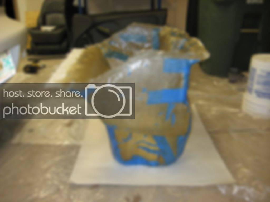

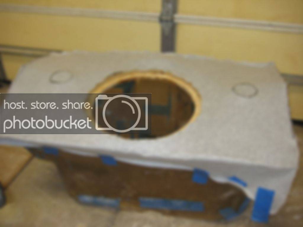

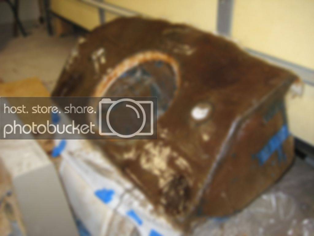

I coverd this whole with blue paiters tape and made a mold with fiberglass. I put the back interior pieces in when I made the mold that way the box would match up with the interior.

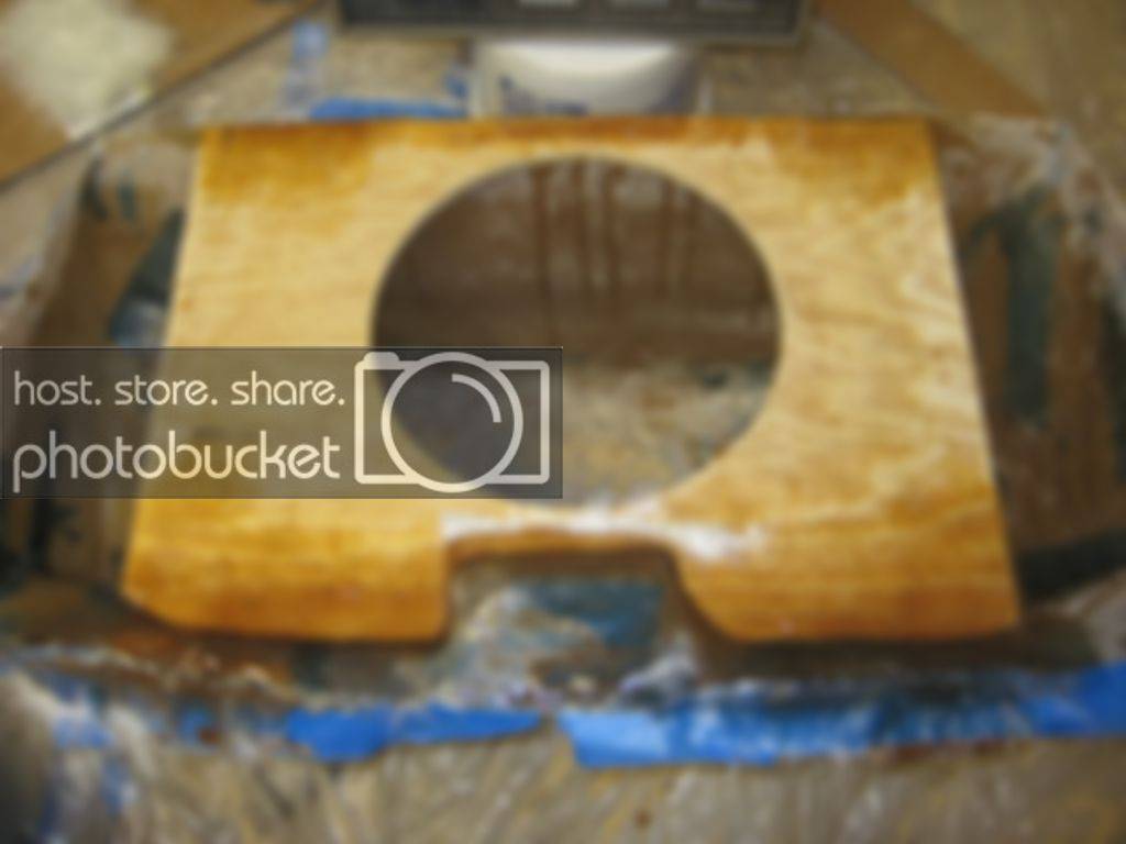

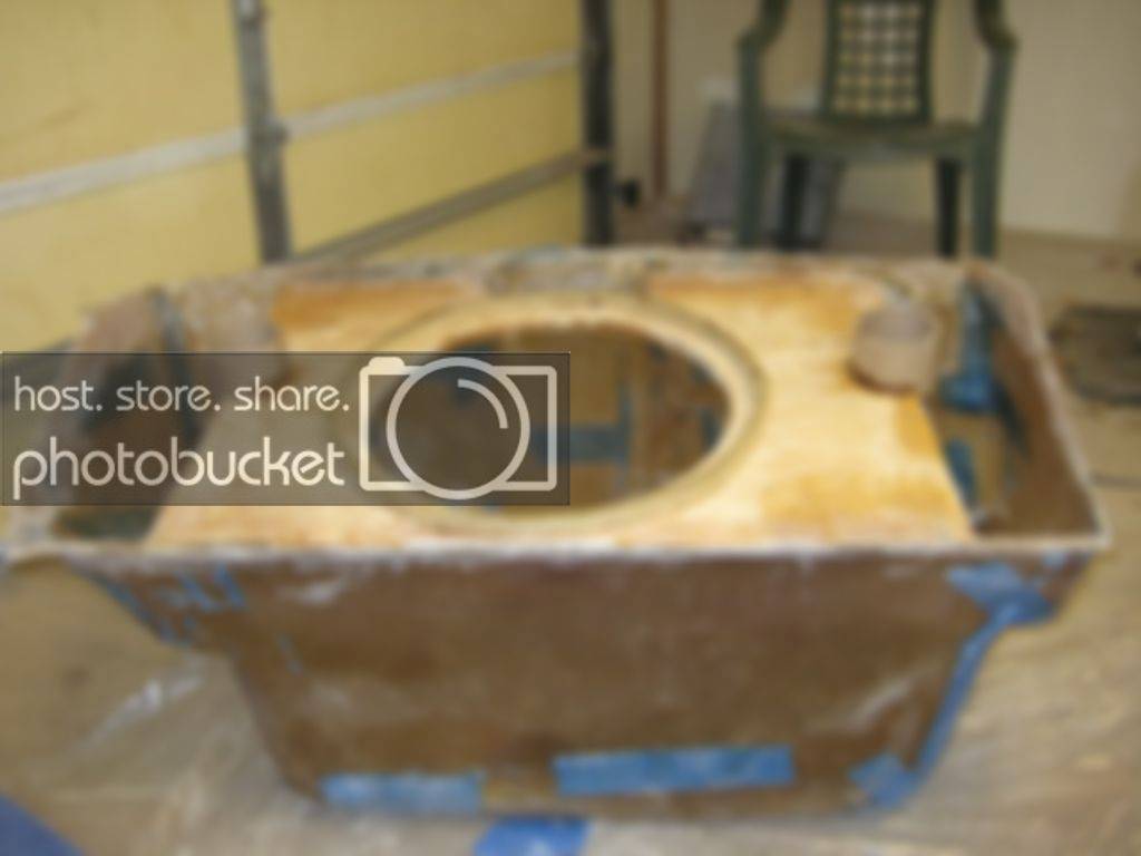

Once I had the mold made I covered it in several more layers to give it strenght and then cut a piece of wood to mount the speaker in. The wood was to help give it strenght and give me something to mount my ports to and run my fiberglass onto to make it look good in the end.

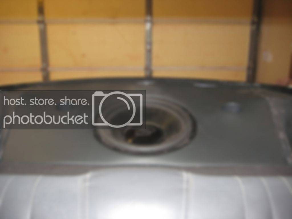

I sanded down the fiberglass until it was somewhat smooth and then gave it a test fit. You can see that it ended up not quite matching up with interior, but it wasn't too bad and I was able to get it evened when I put the body filler over the fiberglass. I sanded the filler smooth and then took some thick exterior paint and a roller that would give a texture similar to that of my interior and rolled it on. Then I mixed up some automotive paint I had left over from previous paint jobs and got a color that matched the interior pretty close and painted it. I took the pictures of the finished product before I got the interior panels all cleaned up, they still have dust all over them.
I welded an amp rack where the spare tire used to be, and mounted a Kicker KX1500.1 for the sub and Kicker SX700.4 for the components.

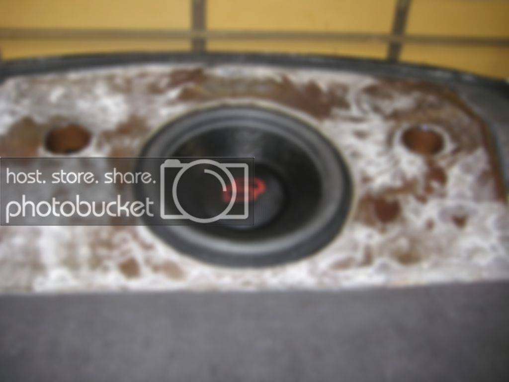

what's up with the tiny ports?
x2, im sure that DD is having a asthma attack at full volume, lol.
But, overall nice work, im all for cost efficient builds //content.invisioncic.com/y282845/emoticons/biggrin.gif.d71a5d36fcbab170f2364c9f2e3946cb.gif
The ports are 2in diameter, wanted one on each side to make it symetric.
The box is 4.3cuft. Tuned to 38hz. I don't think it would be possible to get any more volume out of that space.
is that before displacement ?? wow you fit more back there than i was told i ever could you have given me hope was it hard to work there ?? i looking to fit 4 before displacement tuned to 36htz
