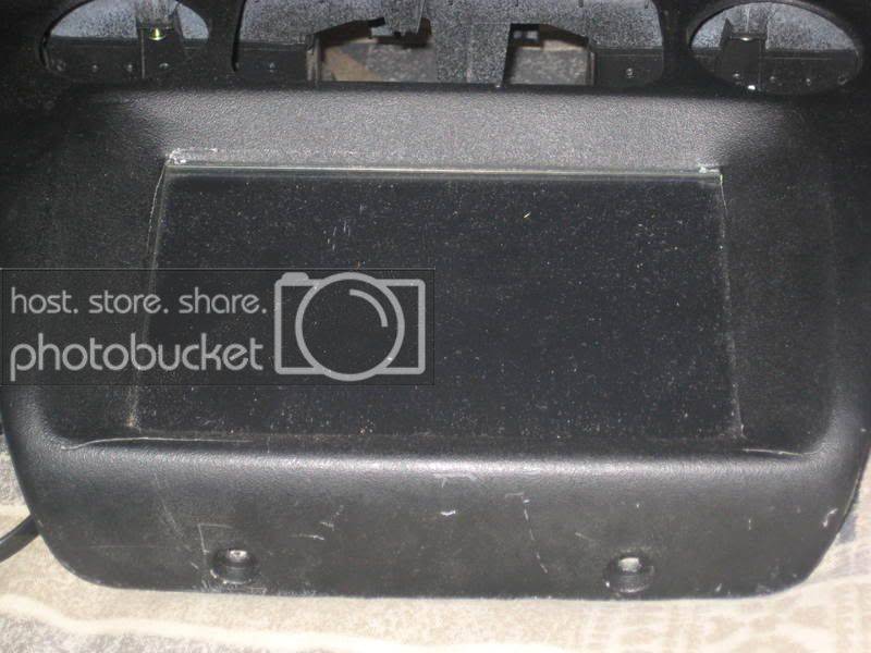

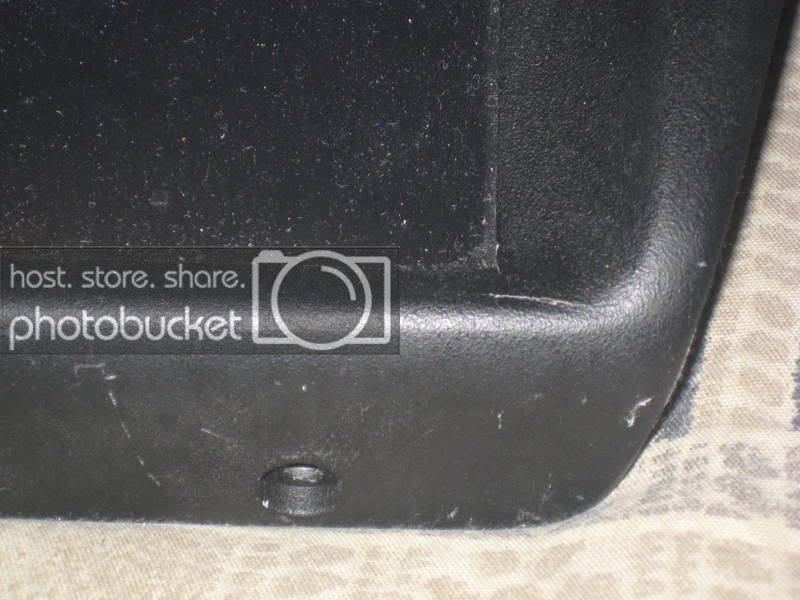

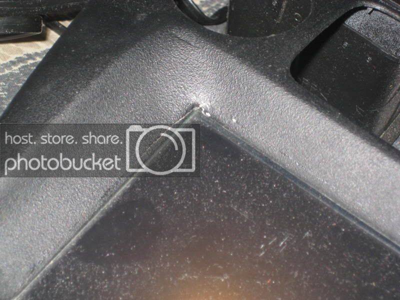

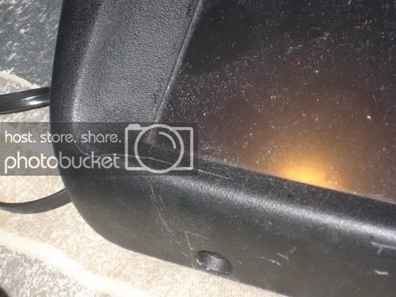

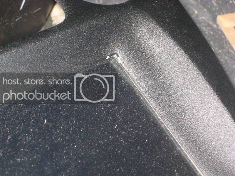

yes its awesome. see nothing bonds easy to plastic. The Durmix 4040 is a plastic urethane. Plastic shrinks and contracts in different temp, where as the bodyfiller does not(same with fiberglass). so cracks happen.
here is a link to my dash build when i had a carputer, my friend did most of the work(dohcrazy) i took the photos, i learned a lot!
http://www.mp3car.com/vbulletin/fabrication/68510-98-accord-dash-7-lilliput.html
we took a short cut by using the rage for the skin coat instead of the 4058(its thinner paste than 4040), and end result is this 1 tx summer later:
Duramix is no longer made anymore. SEM has their own product line that is the exact product, i have to look up exact name and get back to you by tomorrow.
edit: I have a Glassman DVD i will upload and send you the link tomarrow, it talks about this stuff
