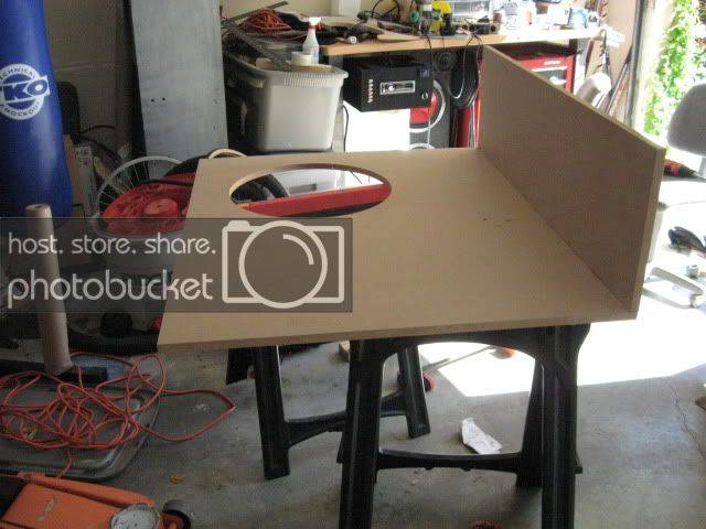

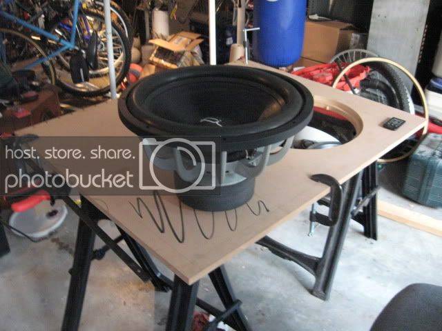

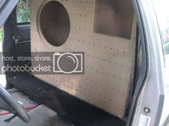

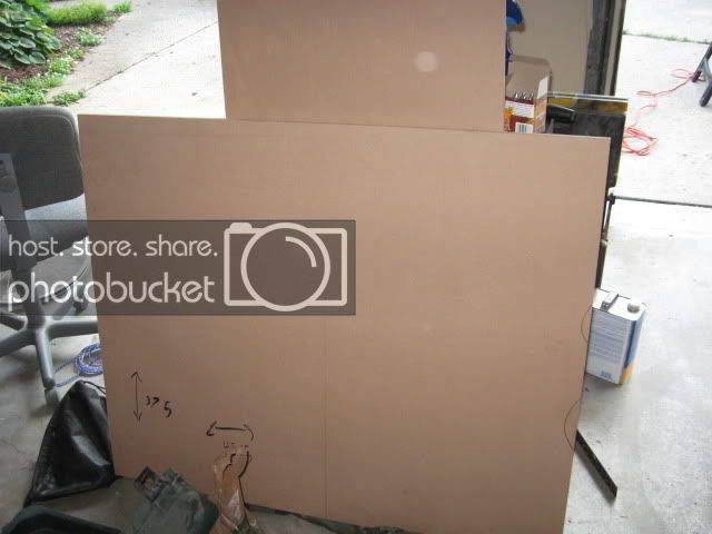

I have been workin on this for a while now but i thought i would finally make a build log. Ok so i am working on wallin the old Dakota with an 18" Fi Btl fully loaded. The box is just a bit under 7 cubes with 144^2 inches of port tuned to 33hz. It is going to be slow going because i leave for school in less two weeks.

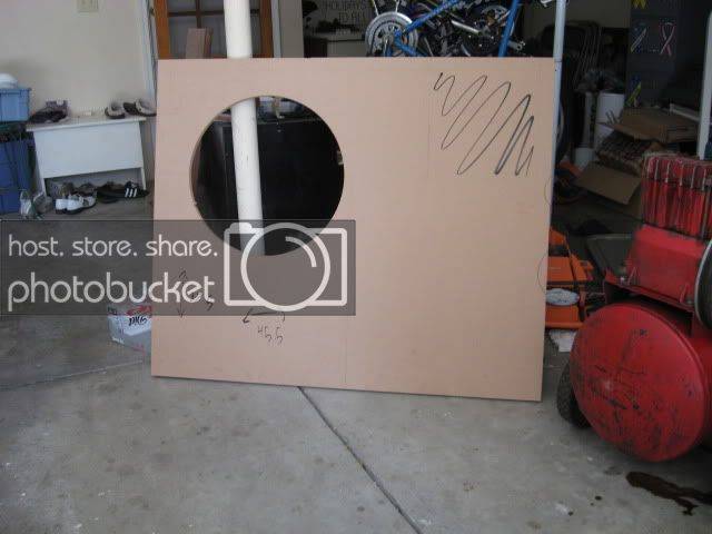

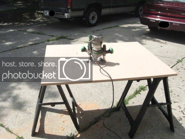

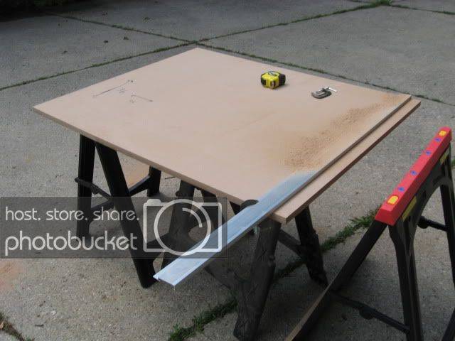

getting the cuts made

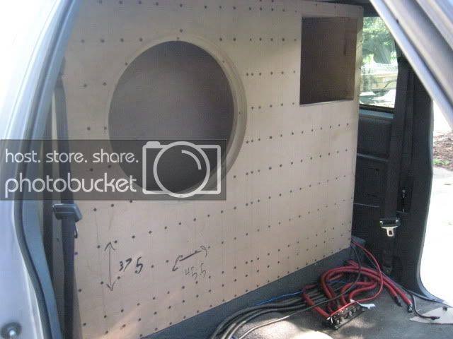

now the cut outs

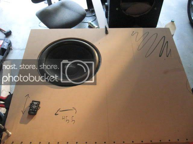

The sub
test fit
Your really going to want more than 14sq inchez of port. //content.invisioncic.com/y282845/emoticons/smile.gif.1ebc41e1811405b213edfc4622c41e27.gif
Hopefully you meant 140". //content.invisioncic.com/y282845/emoticons/smile.gif.1ebc41e1811405b213edfc4622c41e27.gif
n/m he edited
lol ya I meant to say 144:D.... 14 would be *******

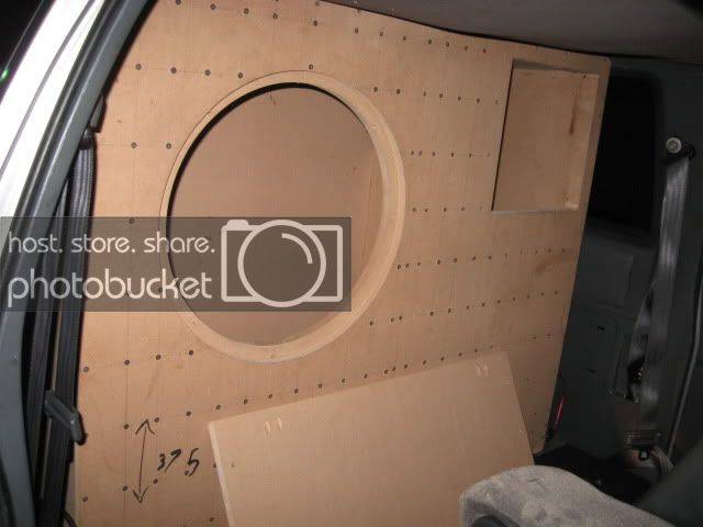

Well lets fast forward a little to the truck...lol:cool:

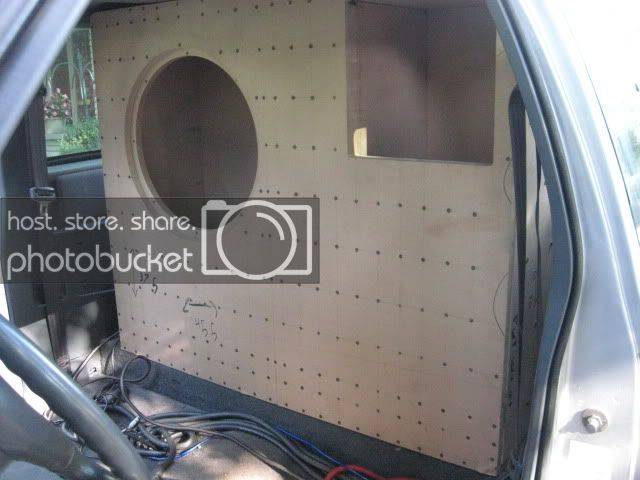

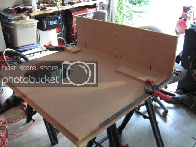

test fitting the box(had a comp to go to)

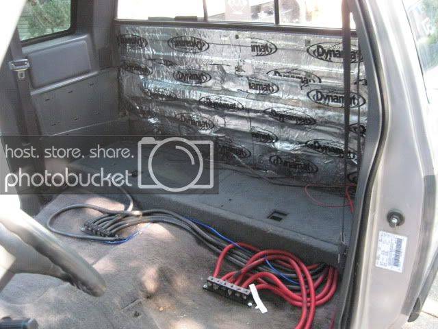

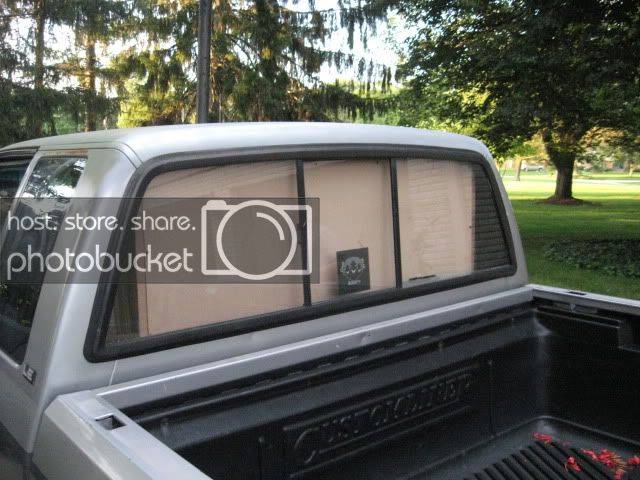

the rear window, I plan to just paint it black and eventually limo tint it

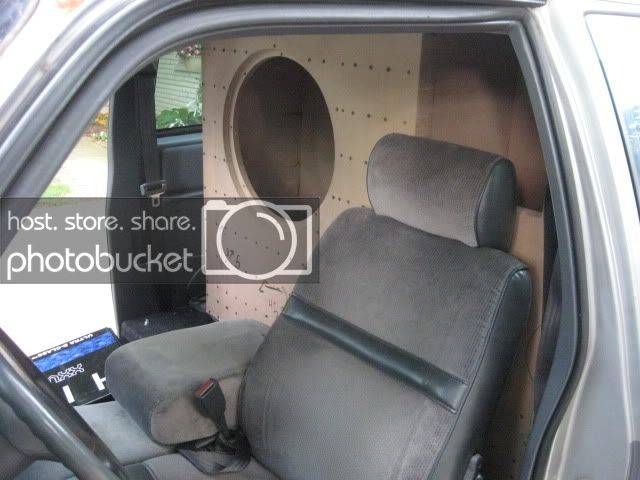

test fitting my seat...lol head is right in the port

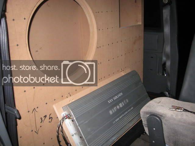

makin a temp amp rack for the comp
installing the Goliath
//content.invisioncic.com/y282845/emoticons/eek.gif.771b7a90cf45cabdc554ff1121c21c4a.gif Holy Screws !! //content.invisioncic.com/y282845/emoticons/eek.gif.771b7a90cf45cabdc554ff1121c21c4a.gif
X2!!!
Wow!
looks loud
hope so... we will have to see. i am going to meter it and if it doesn't do what i want i am could to build another one before i fiber glass it in.
that port looks small //content.invisioncic.com/y282845/emoticons/biggrin.gif.d71a5d36fcbab170f2364c9f2e3946cb.gif
Sucks we didnt get to hear it yesterday
ya it ****... I am pissed that i blew the Goliath with under an hour of play and never got to hear it go full bore, didn't even have the gain turned up because i was letting it break in.
