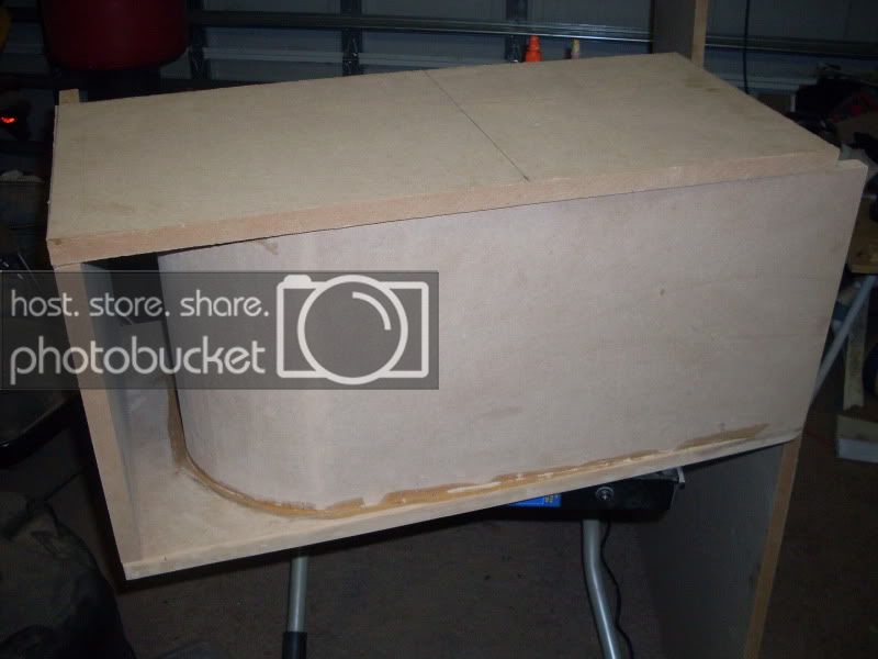

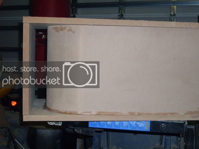

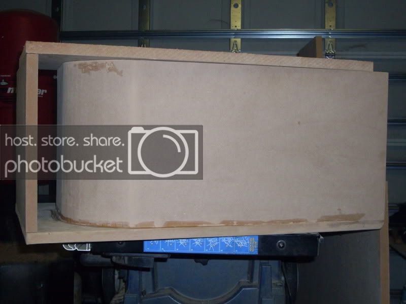

Could someone take the time to explain this port style to me. I'm interested.
I've made a pretty successful box for 2 pioneer SVC 10's. built a sloted vent onto the back and tuned it to 36 htz. Sounds pretty nice.
Want to go to a single 10, Probably going to get an L5... Or something similar.
Something that would be perfect for 450 RMS @ 2 ohms underrated. anything D4 that would be perfect for 450@ 2 ohms.
any suggestions?
curved just gives you a smoother port transition, less port noise.
If you cut slots in mdf about 3/4" apart and then moisten the other side a bit you can bend it like that.
or you can also buy type of wood called bend-a-board thats specifially made to do that with.
//content.invisioncic.com/y282845/emoticons/crap.gif.7f4dd41e3e9b23fbd170a1ee6f65cecc.gif//content.invisioncic.com/y282845/emoticons/nono.gif.eca61d170185779e0921b0faa9704973.gif
moisture and MDF dont play well with each other. . .
rather, just kerf it then bend the wood, it will go without trying to pull out other tricks as long as your cuts are good.
