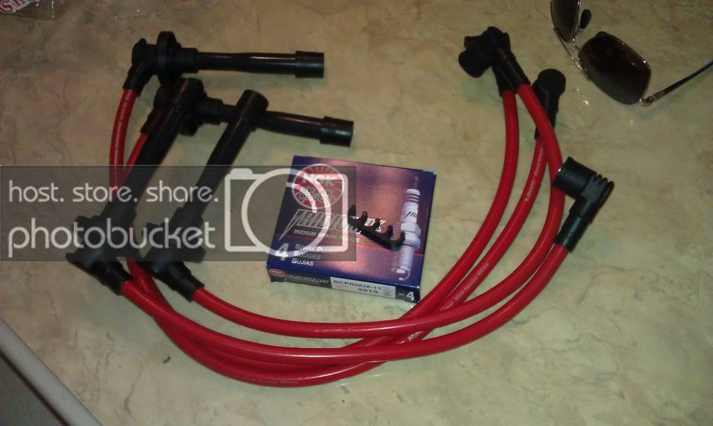

So got my spark plug wires and plugs in the mail on sat which was much sooner than i expected,
but when i went to go change everything i ran into a little problem.

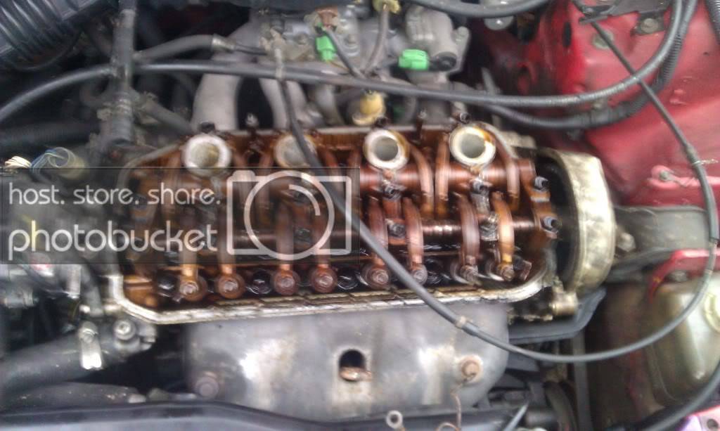

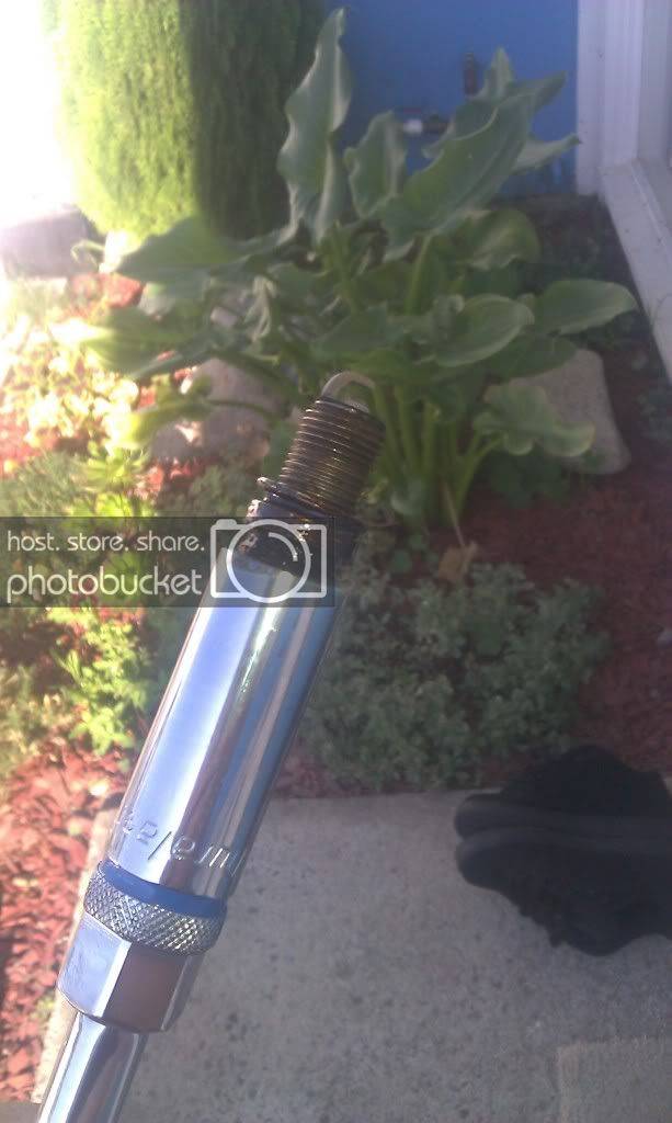

3 of the 4 spark plug chambers were completely flooded with oil so i will be changing the valve cover seal today then the plugs and wires
more than likely a piston ring, hopefully the valve cover does it. i just put plugs in my civic yesterday. what kind of wires are those?
more than likely a piston ring, hopefully the valve cover does it. i just put those same plugs in my civic yesterday. what kind of wires are those
yea im hoping its just the seal around the cover too, i dont remember off the top of my head about the wires but they are from a seller on ebay. they are a lot thicker and feel a lot more durable than the stock wires. hopefully im able to take care of this today.

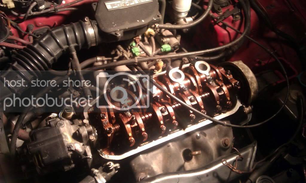

OK put a little work in last night. First i popped off the valve cover.
cleaned off the oil and dirt that was were the new gasket would be going.

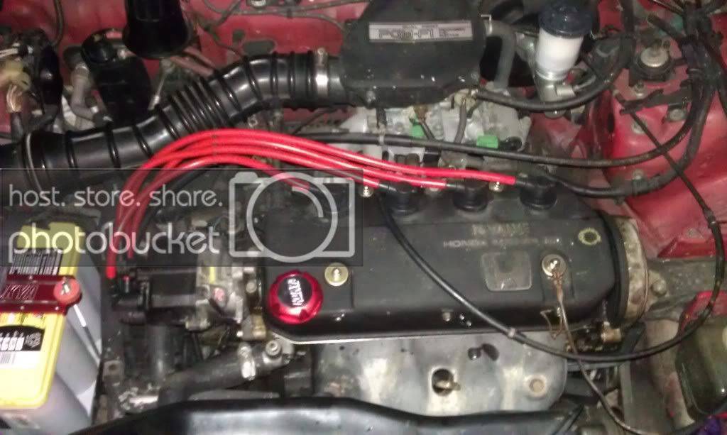

then put the valve cover back on and installed the new spark plugs and wires.

the odometer has a lot of miles but the engine is only 3 years old since it was rebuilt. and now that there is no oil in the plugs and the upgraded plugs and wires it actually drives amazingly better. i did not expect such a dramatic difference with such a small fix. i think next up under the hood is gonna be the alt then the short ram intake. or vice versa if i don't think i will need the alt very soon. maybe ill have my girl get the alt for me for our anniversary ha ha ha
