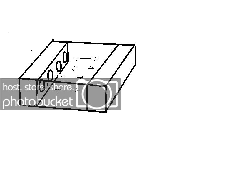

ok if i make a box that is 5 cu.ft @ 30 hz, port 15'' high 2'' wide 13.5 deep for one sub and then i add another sub the tuning will go to about 42 hz?
If you have 15 cubes, why not just use 4 15"s at 30-40hz.?
what do you guy's think about this? 8 15s
anyone
no if the box is tuned to 30hz it dosent matter if u drop 3 15s or 12 10s in it still 30hz. there is only the matter of the displacement of the sub in the box but what is that in a 5cf box .1-.18,lol.
the thing you should be looking at though is that isnt much sq" of port for the cf of the enclosure. say if you wanted to put in 2 entry level 15s you would be fine. if yo want to put in 2 high end 15s ur gonna hear port noise with the amount of air that is going to be moving...
