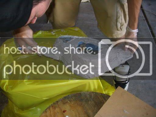

I got payed $200 up front + more once it's finished to do some easy work on my friend's uncle's caddy. He wants me to fiberglass some door pods, run all the wires, and simply install it all. I just started a couple days ago.

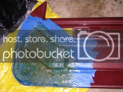

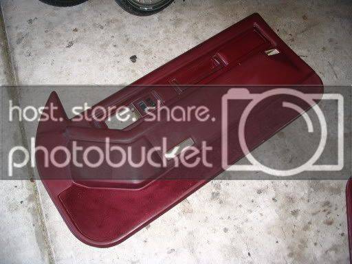

Door panels I'm working on:

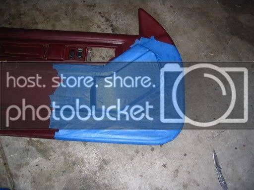

Tapped up and ready to glass:

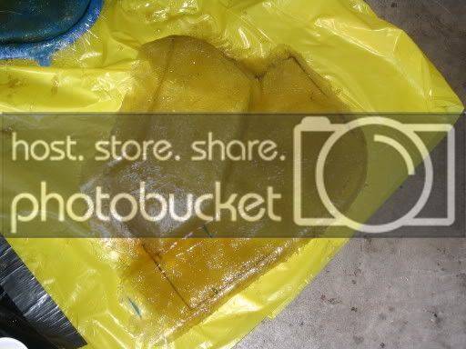

After one layers:

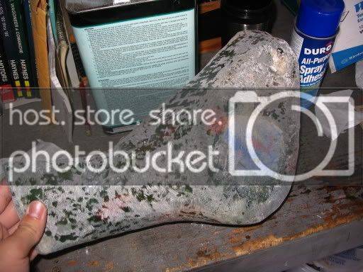

Pulled it off the panel and ripped off the tap:
Here are the speakers going in them:
They're boston acoustics. I'm not sure what model, but they're old and probably used. They'll sound good though. I don't have the tweets yet, but they're bostons too.
I know what you're thinking, what's up with all the teaser pics and no pr0n? Well, I did all that work today and yesterday. Then I'm going out of town for a couple days, then I've have 4 days to finish them (deadline). So you'll get the goods soon enough.
Like I said, I'll be getting around $200 for them (at least), tell me if you think this is a fair deal.

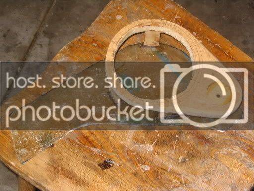

Cut out the fiberglass molds (tossed alot of the mold I thought I wanted but decided I didn't), made some baffles and mounted them-

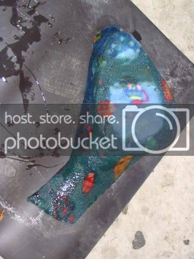

Streched some fleece over it and got to work-
And yes, those are tea pots on the fleece //content.invisioncic.com/y282845/emoticons/biggrin.gif.d71a5d36fcbab170f2364c9f2e3946cb.gif. Should ad a couple db's-

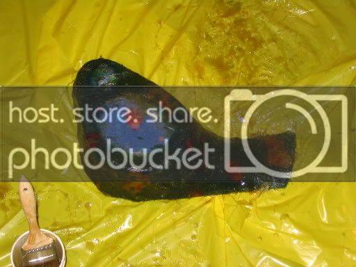

And this is after 3 layers of glass-
I just finished oh...half an hour ago. I've been working all day and all yesterday in 105-110*F weather, not fun. Tommarow is bondo and sanding time //content.invisioncic.com/y282845/emoticons/crazy.gif.c13912c32de98515d3142759a824dae7.gif Yay! At least I'm getting payed. //content.invisioncic.com/y282845/emoticons/greedy.gif.5a53e6246569d7ab79867170f3b06629.gif

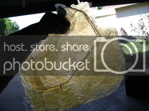

And here is today's work

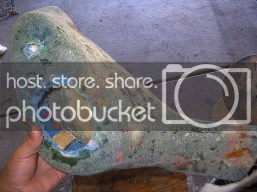

After they hardened overnight, I sanded them down a little. Far from smooth, but a good start-

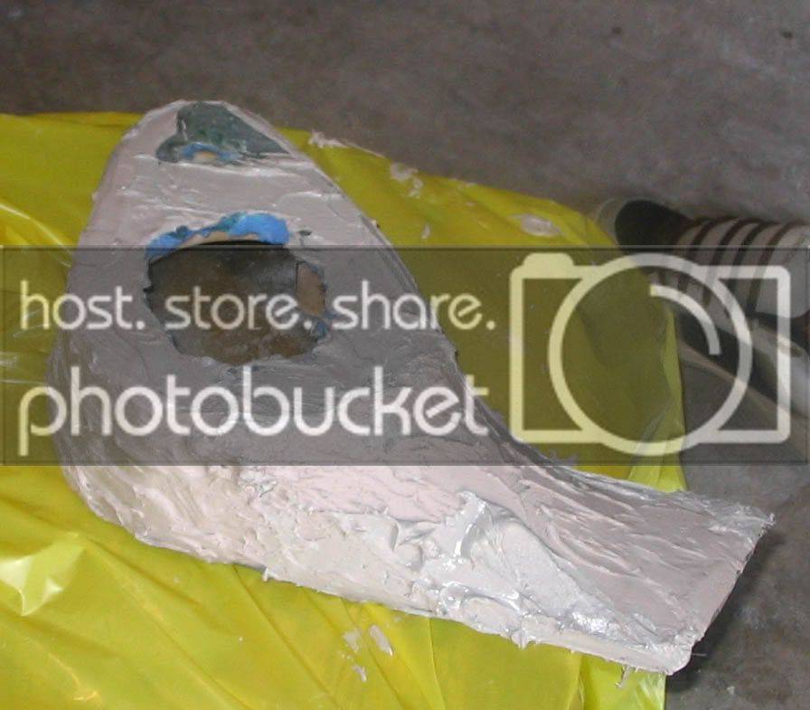

And then I got started on the bondoing-
And that's all I did today. It doesn't look like much, but I worked my *** off. I have to sand all the bondo smooth tommarow and wrap in in some kind of fabric. Bottem line: they have to be done by the end of the next day.
holy mess of bondo! //content.invisioncic.com/y282845/emoticons/awesome.gif.4430a219d9aaaa6cadc75e9290979dfb.gif Hopefully you are using some extremely sandable stuff or you'll be at that for hours just getting the big bumps out. But looks good so far, kinda hard to judge until they are complete
