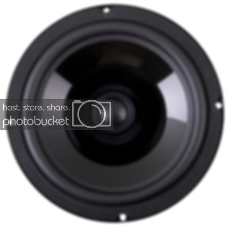

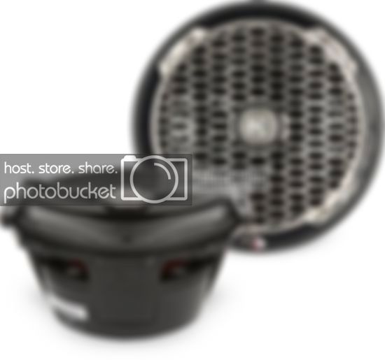

I am looking at a decision between 8" round speakers instead of 6.5" for the rear deck of my 1967 Camaro build. The three I have come to are the Rockford Fosgate 8" M282B Rated at 100 RMS 200 Max and the Soundstream Audio SST 8.2 Rated at 170 RMS and the JL Audio VR800-CW 125RMS
I am running a four channel amp with 125 watts per RMS.
Has anyone actually listened to these? Is there a good reason to choose one over the other?
I do like the sound of the silk tweeter, and I did get to listen to the Rockfords, but I have not been able to hear the soundstream speakers or the JL Audio's. I like that the Tweeter on the Rockfords are not punched through the Speaker cone, it is actually suspended above the cone as a component seperate. On the other hand I have been told not to run a tweeter in the rear, Hence the JL Audio ZR800-CW

Rockford Fosgate® - M282B
Rockford Fosgate M282B 8"
• 8" 2-Way Full-Range Rockford Fosgate M2 Series Marine Coaxial Speakers
• CEA-2031 Compliant
• Power Handling:
o Peak: 400 watts per pair / 200 watts each
o RMS: 200 watts per pair / 100 watts each
• Frequency Response 48Hz - 22kHz
• Injection molded mineral filled polypropylene cone
• UV and Salt-Fog resistant TPE (Thermo-Plastic Elastomer) surround
• 1" Bridge mounted component grade coated aluminum alloy tweeter
• Corrosion resistant gold plated polarized input terminals
• Moisture, tear and fatigue resistant aramid fiber spider
• 4 ohms impedance
• 1-1/4" Dual layer voice coil
• Linear, high excursion matched motor magnetics and suspension design

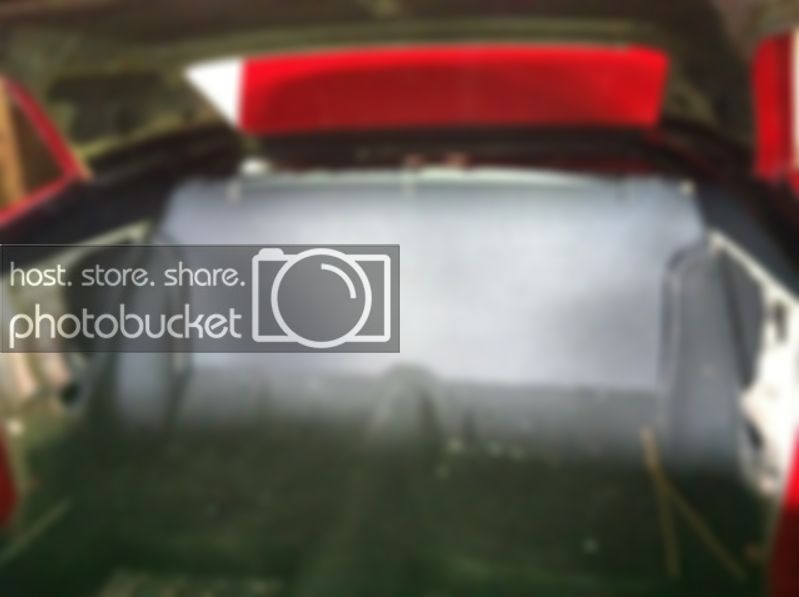

Tweeter. He told me that I should consider the JL ZR800-CW instead. These are going to be rear fill I know, but I tested the speakers in my BMW to see what I really listen to, and I have my rears at about 60% of my fronts. Of course my BMW doesn’t have Hertz in the front either. I know it makes all the difference in the world, but the 8" speakers are going in the rear deck of my 1967 Camaro. It is isolated from the trunk, and the deck itself is reinforced with a solid piece of 5/8 MDF. I am looking for stronger bass. Not Sub Woofer Buzz but a good solid sharp hit. I can cut any size hole in the rear deck. It is currently solid on the deck and covered with Dampening Hushmat on top and Alpha Damp between the Metal and the MDF on the under side..

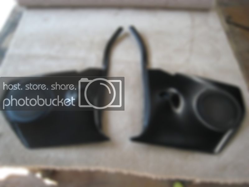

The dash really kicks back on this car, and really opens the area up for the Tweeters, yet I may still move them up to the top of the dash in the pillars. At the moment I am looking for them in the kicks, But I want to wait till I have the system installed, and then I can make a decision on Front tweeter location. I just have to make a decision on which rear speeker to use.

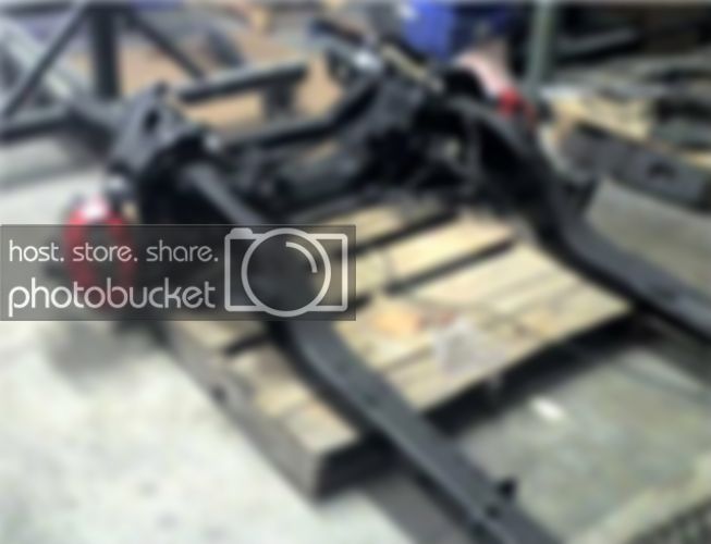

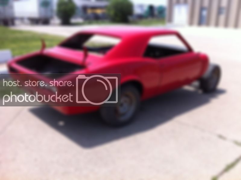

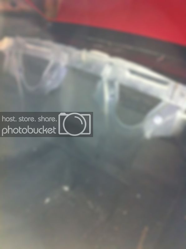

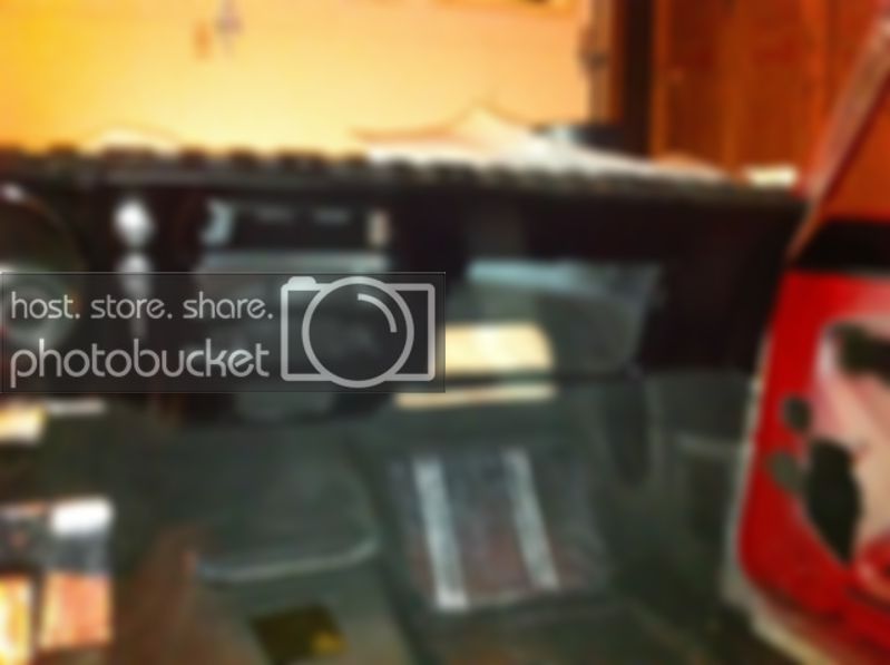

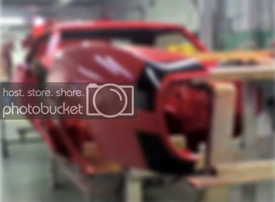

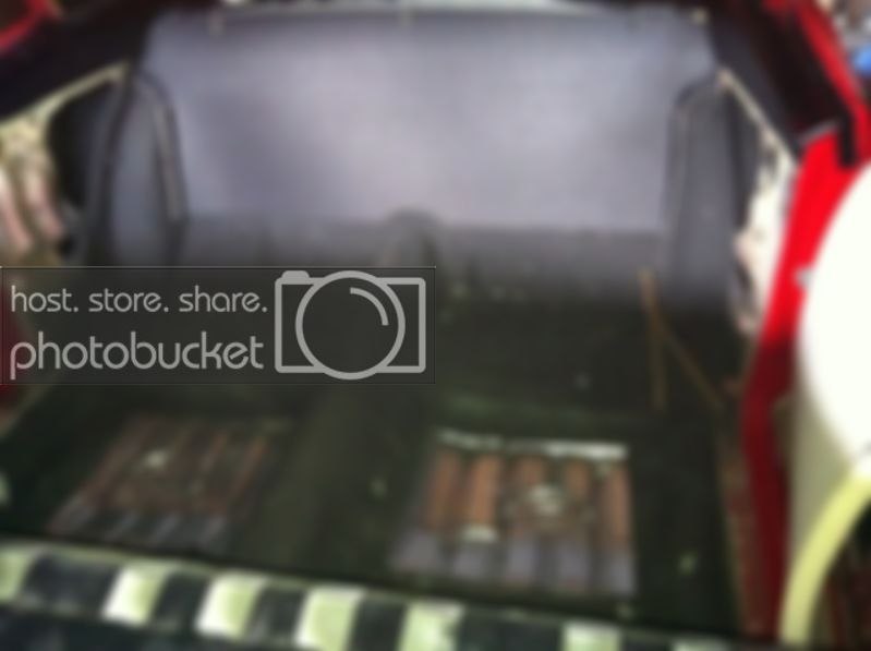

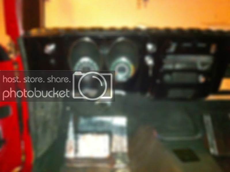

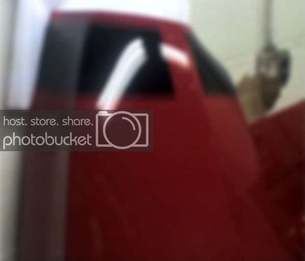

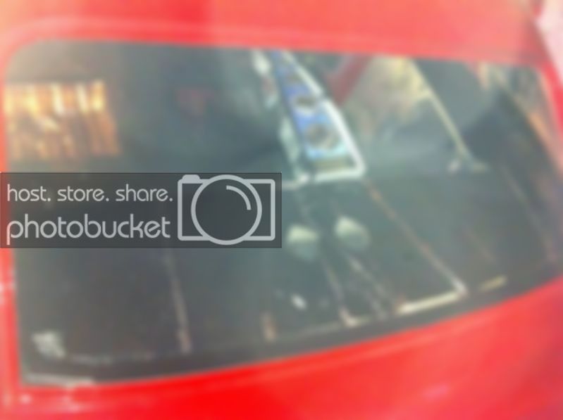

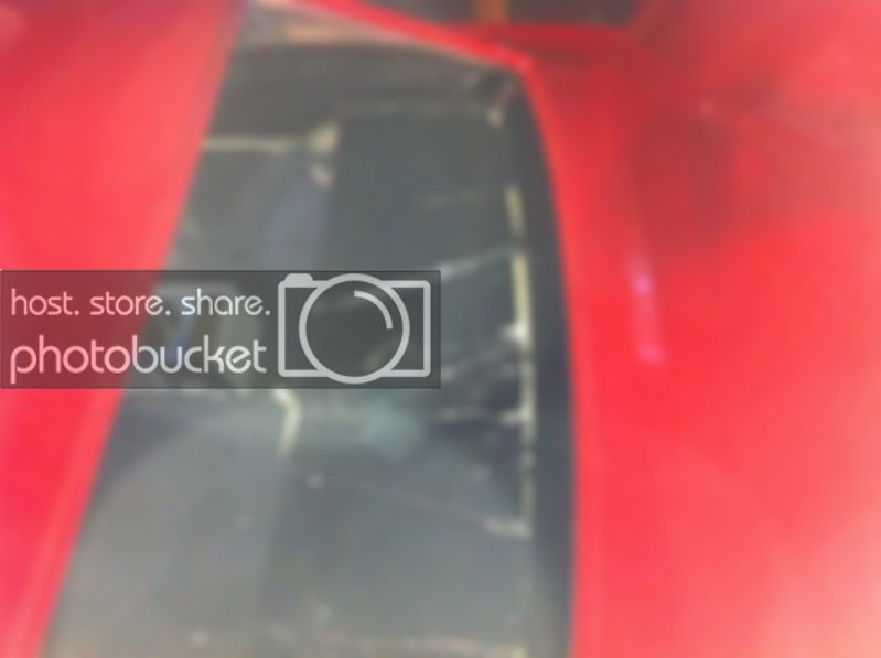

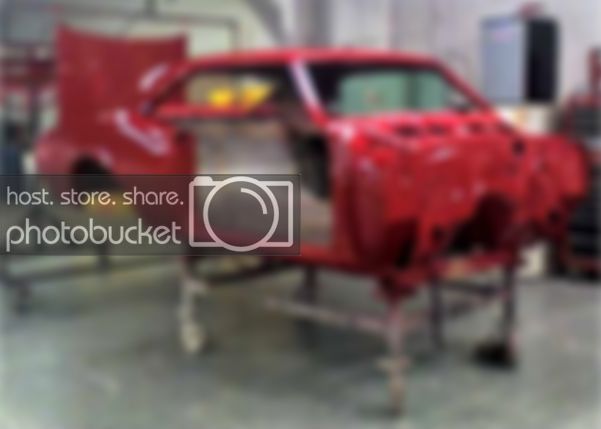

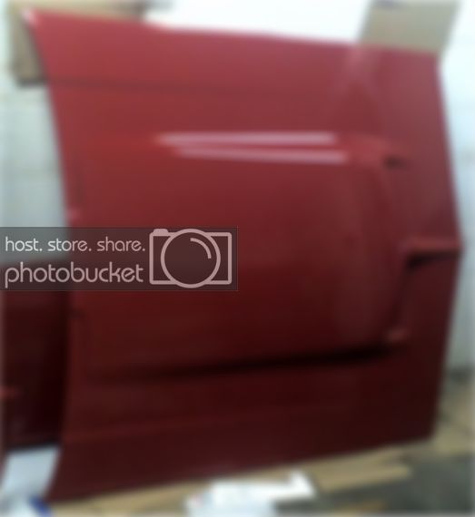

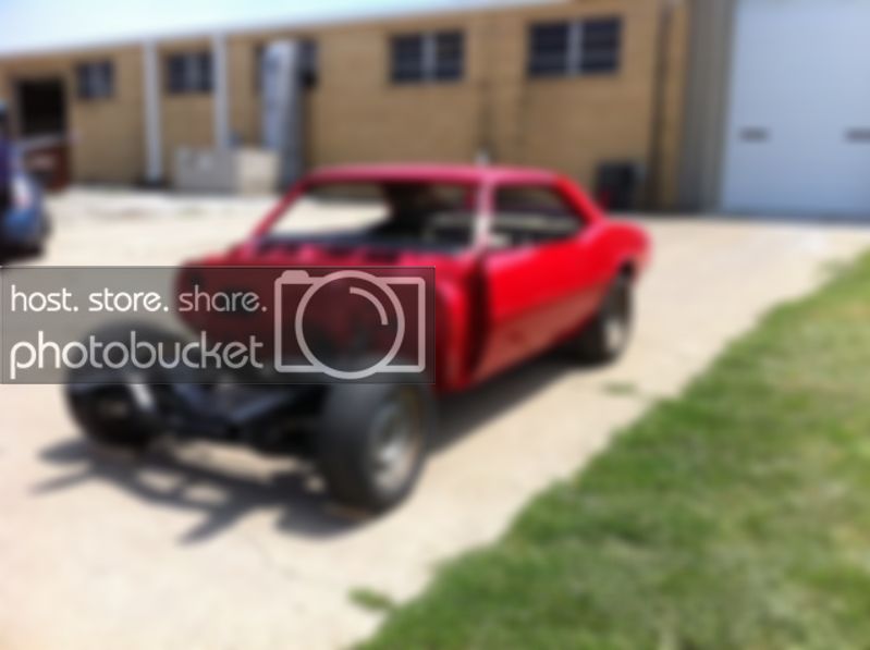

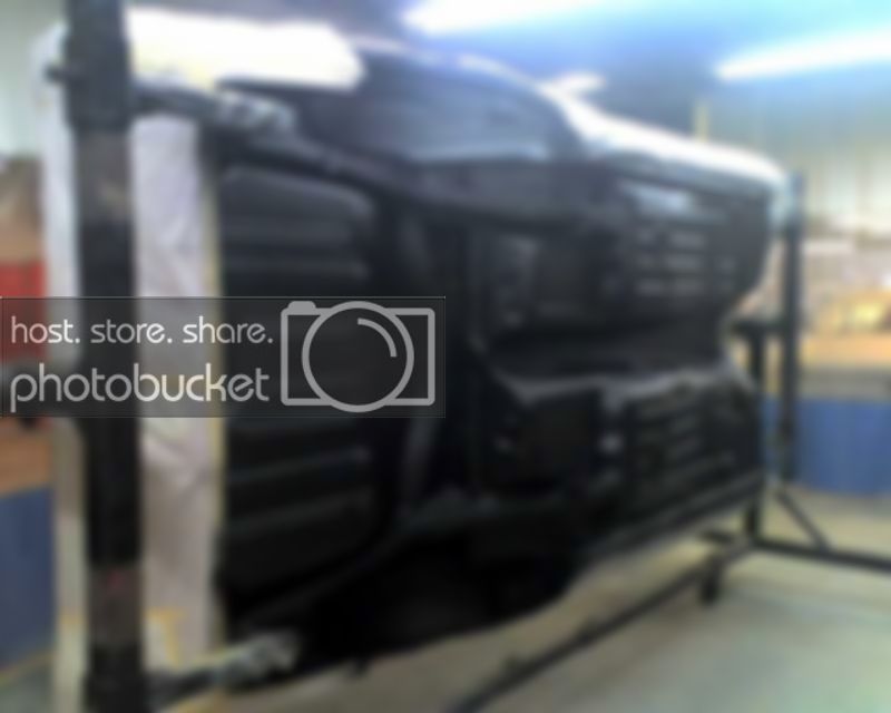

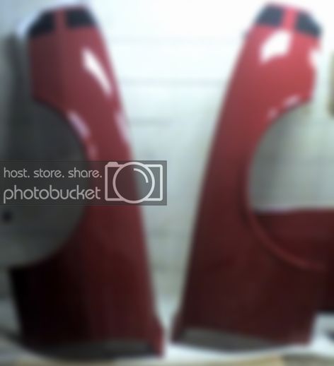

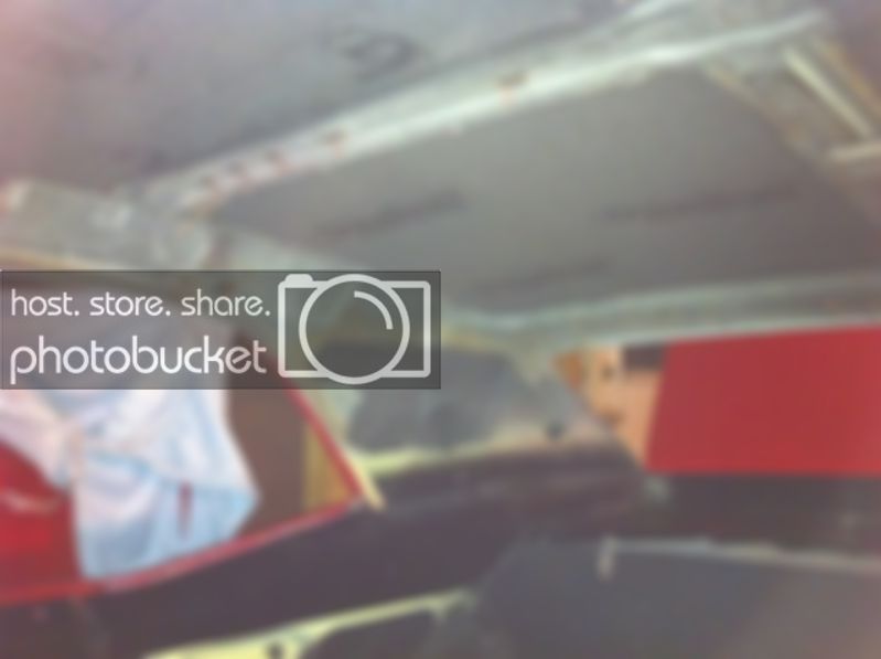

Here are some pictures of how the car came to this point of the build.
See I seem to do everything the hard way!
I just purchased a new Infinity KAPPA Four to power my speakers. This is to replace my older Hifonics Amp. We will see if it makes a diference. Now I have to lay out the Trunk and build a place to keep the batteries, and show the Amp.

OP - from your description it sounds like you want more midbass. the MLK 165 can provide plenty of midbass if properly enclosed. what is the airspace volume for your kick locations? is the airspace airtight relative to the cabin? you can add some 8's behind you for more midbass if you want, it can achieve your goal if the back airspace is airtight relative to the cabin. i wouldn't call it "rear fill" at that point. My local shop has some of those ZR800-CW BNIB for $140 each, they had 6 left. are you running these 8's in lieu of a sub?
