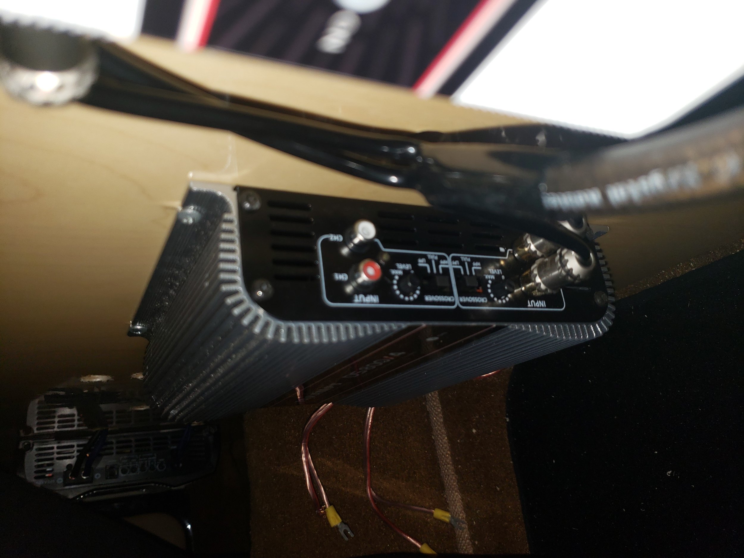

This is what I usually do before I put my main gear in. For my temp setups, Ill thrown in what I have close by out of my stash.
