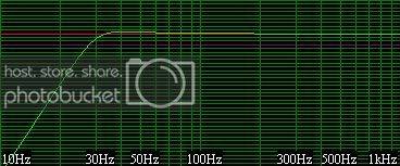

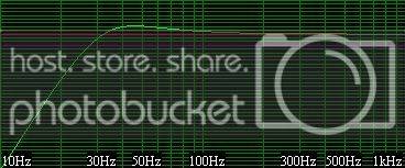

decided to go with a dual 8 inch setup in my s10. narrowed it down to 2 subs. both would be in around 2 cubes ported between 30-32hz. i thought i had decided on the dayton sub, but the tang band aluminum 8 seems to model up better in winisd, at least ported. in 3 cubes the dayton models up good, but i don't want that large of a box. now i'm leaning towards the tang band. the dayton looks great though.

i had those exact sentiments, until i modeled them both ported. dayton is far better sealed in winisd, so i think that sub was never really built to be ported. i can get a flat response down below 30hz in winisd with the dayton, but that's 2 cubes per sub....double the tang band.
The Dayton sounds wonderful. They have a Qtc that's a little on the high side for stuffing into a vented enclosure unless you can make it large enough and tune low enough to keep it from being peaky. They sound great in sealed enclosures and transmission lines with line length supporting around 26 to 28Hz. They also have quite a bit of copper in the motor so inductance and distortion is quite low. Very musical drivers.

largeness is the issue. winisd is telling me that it needs ported boxes in the 2 cubes per sub range. i could do a 12 in that. what did impress me a little, is that in 2 cubes ported, it's flat to around 25hz, which is lower than alot of 12's.
