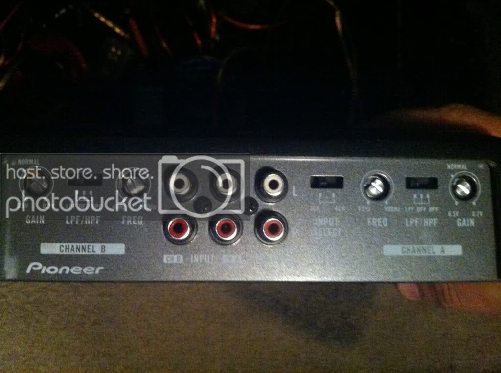

6x9's 800w d
heres a picture
HPF means high pass filter. Whatever point you set it to only frequencies above that point will pass through. For 6x9's you'd prob want to set it somewhere between 50-90 hz. Try it & see what sounds good.
