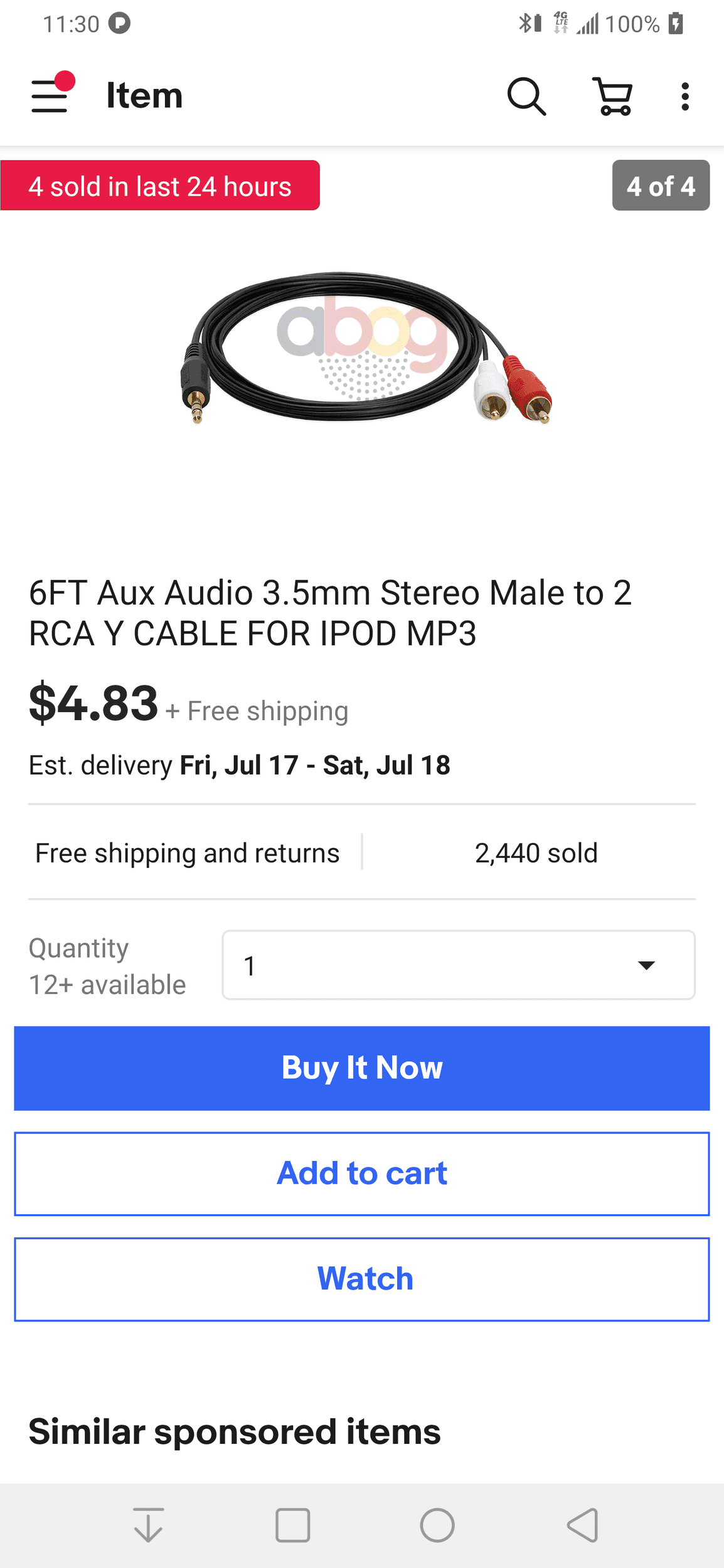

So i tried the gain, and turning off the crossover and nothing is happening still, im not sure what the issue is as i have checked the wiring inside the boxes and they seem ok too, how do i hook my phone up to the RCA's? might help me diagnose issue
