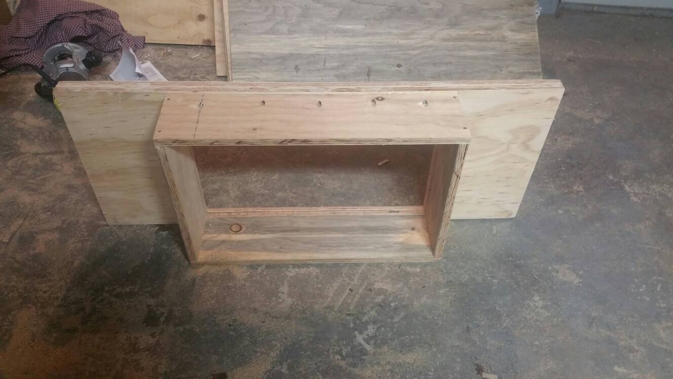

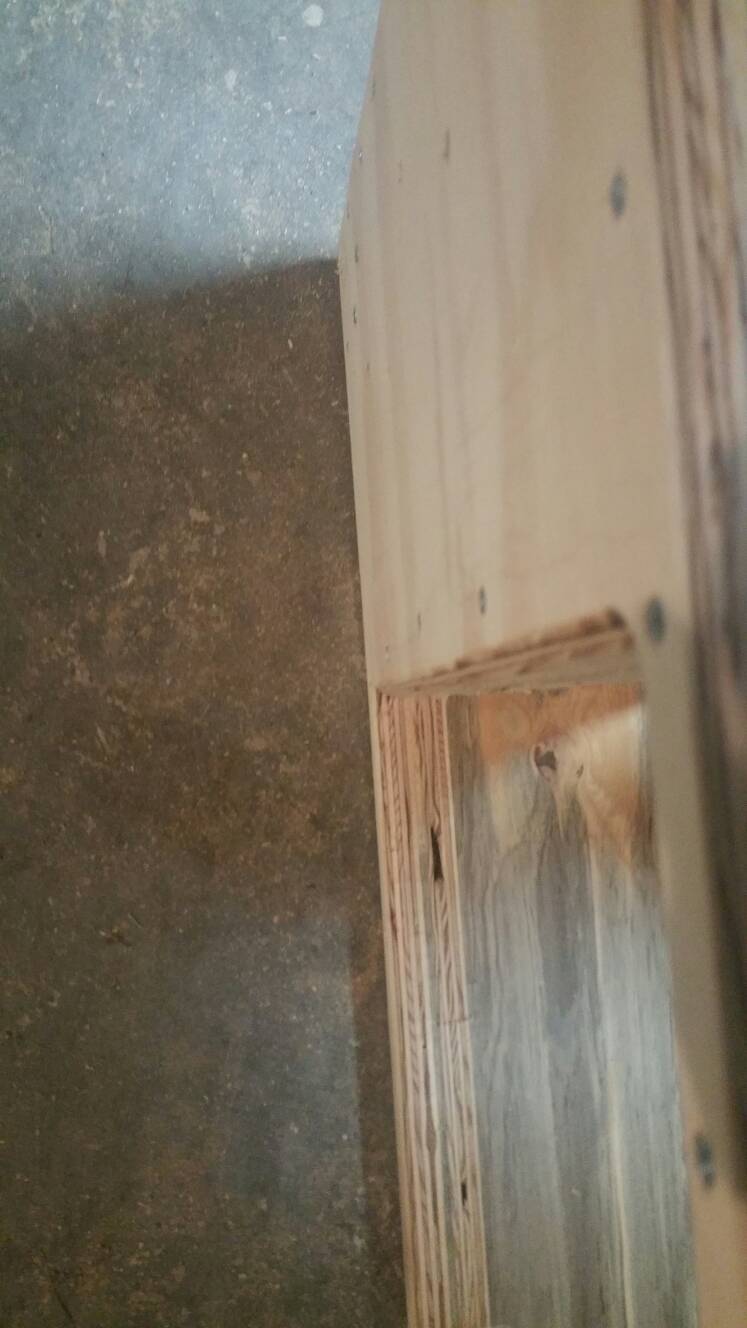

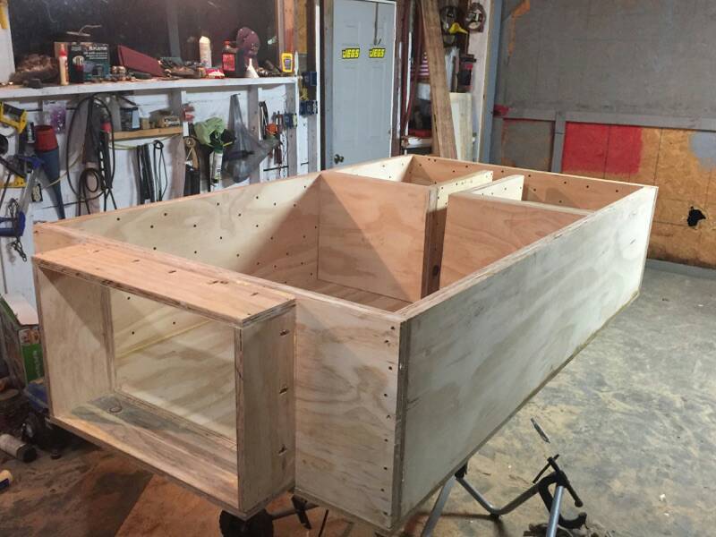

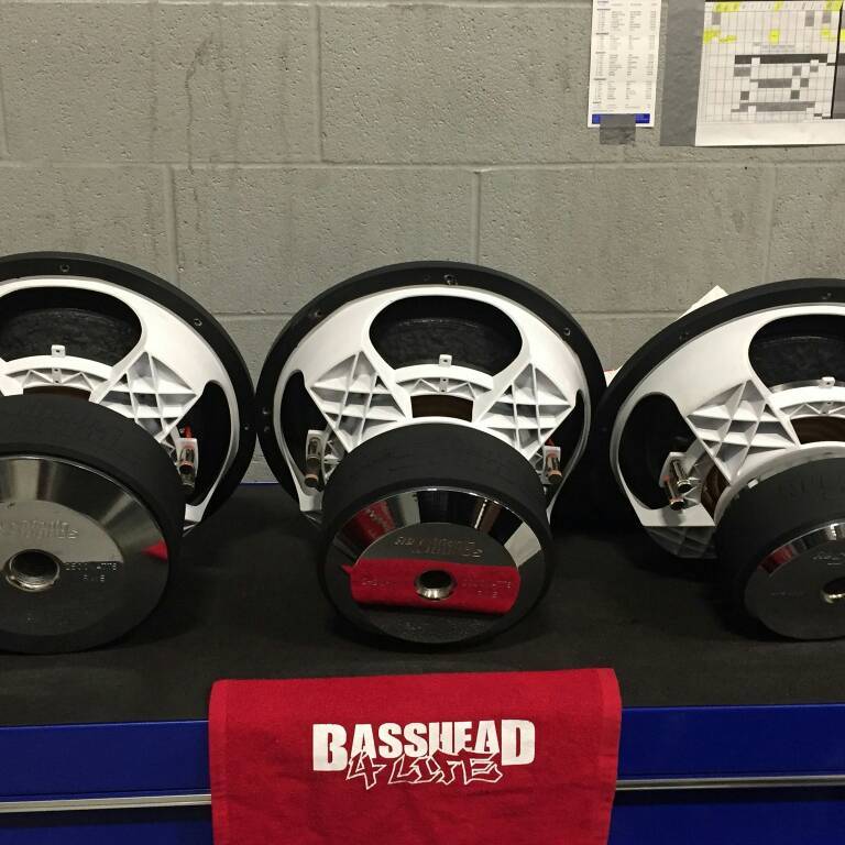

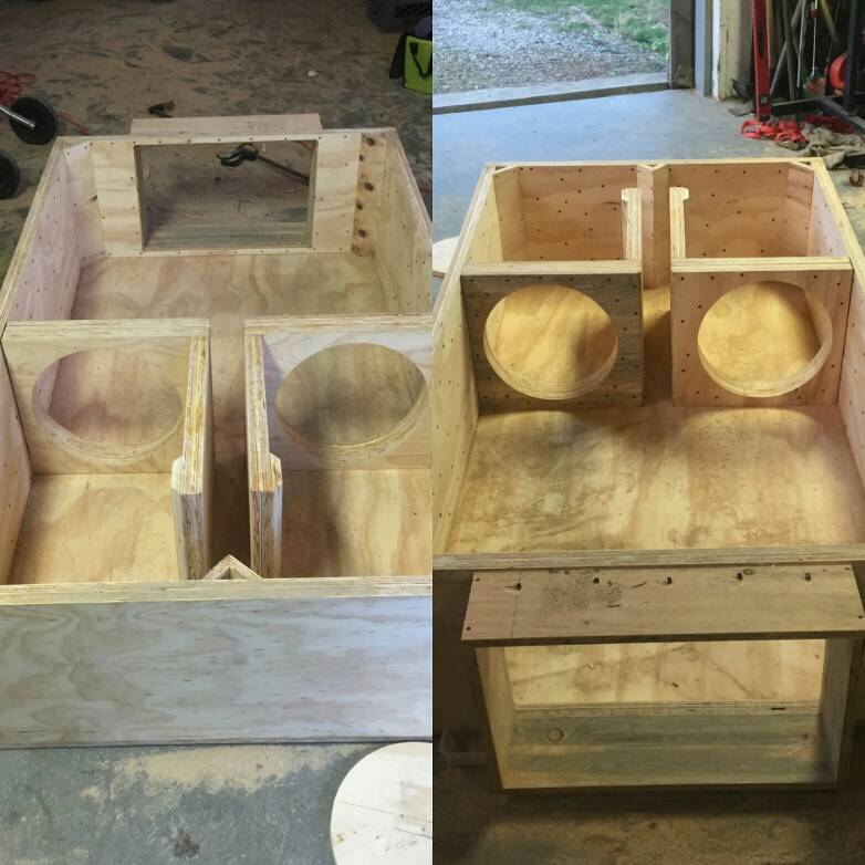

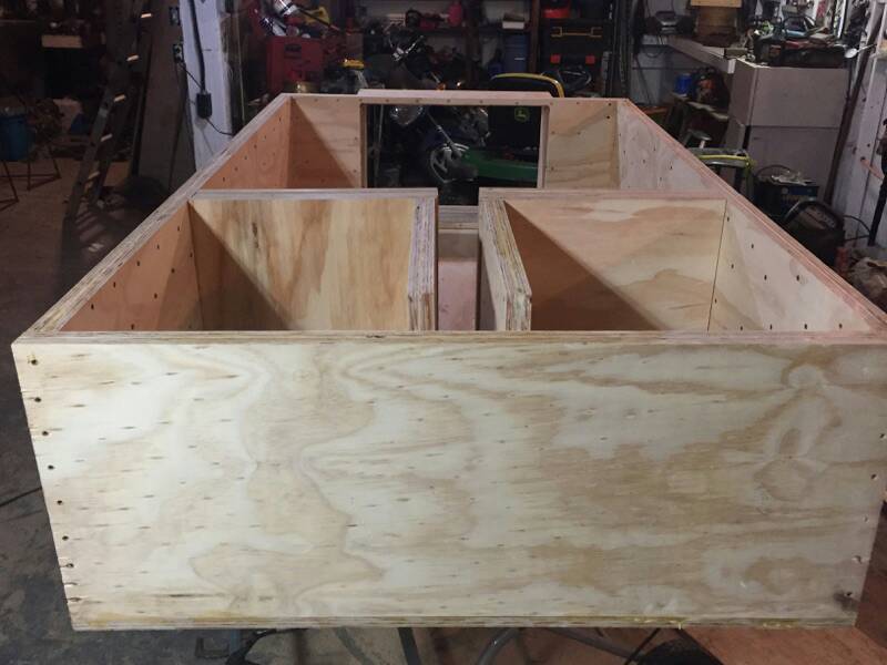

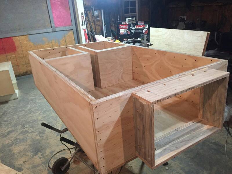

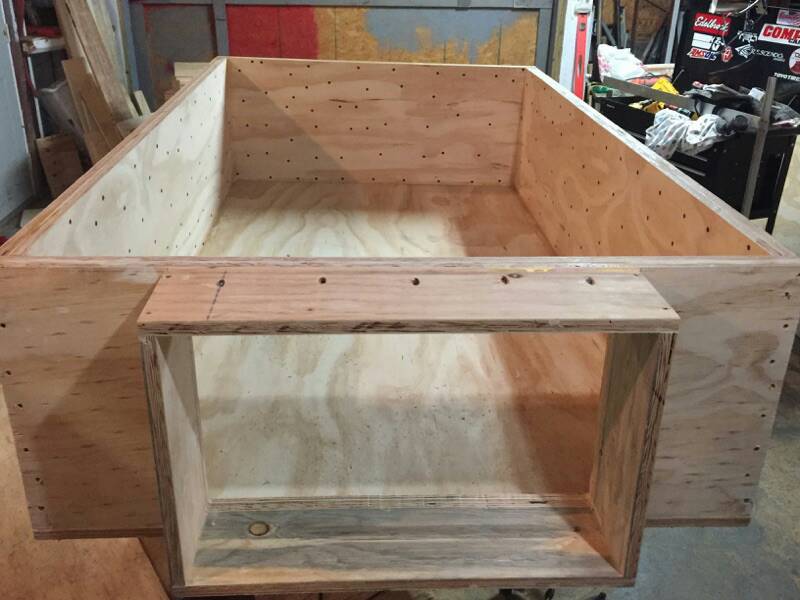

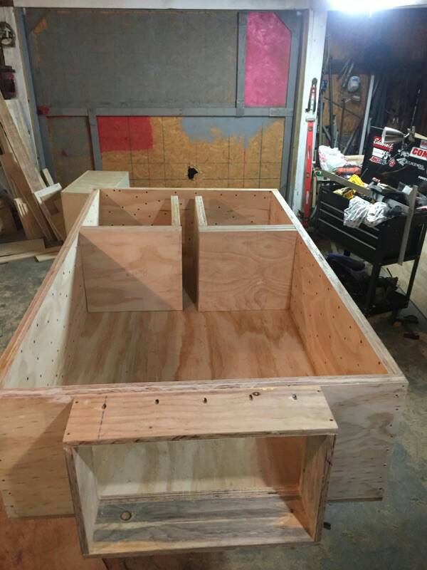

Another build we are working on. build is going to consist of 2 resilient sounds onyx 15's on a ampere tfe 8.0 a js 270 amp alt and another gm 200 amp alt 3 runs of 0 not sure on bats yet enclosure is 2.25:1 ratio series tuned at 25 in the rear and 50 in the front should get a lot of the enclosure done this weekend just got the front done tonight cause it was so cold. Here are some pics.
onyx all the way on the left

Looks like its gonna get rowdy
Thanks man I hope it beats

Good work man looks great do far
Thanks man hopefully it sounds as good as it looks
