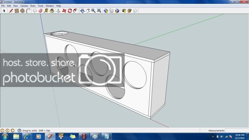

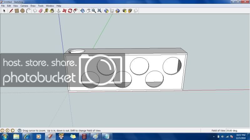

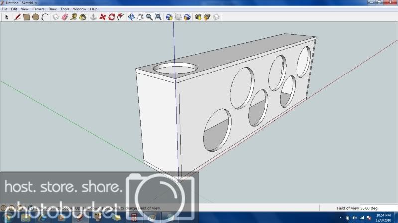

Thanks to black friday, I became the new owner if 6 Kicker 10.CVR.D4 subs and this is the best I could come up with under my constraints (leg room, and no wall).
The box is 4.5 after all disp. (I know its only .75 per sub but thats the best i can do :/)
AeroPort is 8in and 17in long about 36.8hz tuning
Box Dimensions 10in Deep x 20in Tall x 58.5in Wide
On to pics:
Thanks in advance for all of the help.

You could always leave the port external to gain box volume, if you don't mind the ugly factor.
I could but I think ill leave it in first and see how it turns out.

CVR's like larger boxes. I'd sell a pair of them on craigslist and use the same box you have but put the four as far away from the port as possible(I guess that's be driver's side in this case). Four of them would be much happier in that air space than 6. A good box for a pair is 2.5-3ft^3 tuned to 30-32hz.

But six in that box will give you a higher rolloff point, and as a result, less low-end output compared to the rest of the frequencies. You're already tuned too high for those subs, and on top of that using too small of a box which moves the peak in the frequency reponse up higher.
Ehh yea I maybe could make it a little taller and drop the tuning a bit. Whats the best tuning for these subs?
