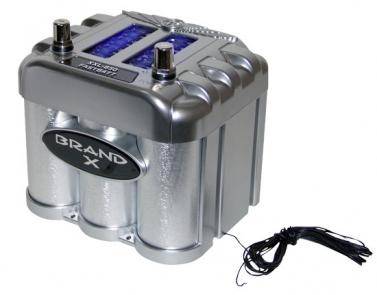

58 Farad Super Capacitor for $80 !!
I think getting all that for a couple of MTX terminators is a joke.
The capacitor is there for one reason, to stabilize line voltage, that's all i expect it to do.
I'm quite sure there is a voltage drop between the battery and the amplifier, the capacitor will address that voltage drop and maintain line voltage.
Maintaining line voltage puts less strain on the charging system, no dips in the voltage = no spikes in the current.
Don't count on my system remaining the same, it will undergo changes until i am happy with it and i am not happy with the MTX subs, a single NVX sub will soon replace the pair of MTX's.. cheers.

Anyone have an opinion on this?:
15V 233F Ultracapacitor Engine Battery Starter Booster Car Ultra Super Capacitor | eBay
I was thinking about replacing my main battery with it
I can't speak for that but i was reading a story about a gentleman who bought one of these to replace his car battery because his headlights were dimming and was not happy with it UNTIL he actually charged it up and started the car with it, now he won't trade it for his car battery. The main battery is only used to start the car and run the accessories when the engine is off, when the engine is running the alternator is the workhorse. The capacitor is steadily discharging and recharging filling any voids in the line voltage and making sure all the accessories have enough voltage to operate correctly no matter the load

the one that Trumpet linked up is just like mine and already assembled for $9 more, that's a **** good deal that i wish i had seen before i bought the kit and then a $44 soldering gun, now that i have the 200/260 watt gun i will find more uses for it, trust me..
A 58 Farad capacitor is (supposedly) enough for 58,000 watts, 1 farad per 1000 watts, please don't hold me to that..

I am curious as to how you plan to wire this up though. The terminal can accept up to #4 wiring, which IIRC is just 4 gauge wire. Given you need one wire from your charging source, and one going to the amp, you could fit what like 3 runs of 8 gauge in there comfortably?
Unless you could use a distribution block to connect the alt/cap/amp and i'm just overthinking this.
lord have mercy, DO NOT try and assemble this kit with the Weller D550, the tip on the gun is huge and not really suited for soldering the LED's or the resistors, a 40 watt pencil iron is perfectly suited for the smaller components but you will need the D550 once you start to solder the cap's in place, remember to pull the LED's up about .5" out of the board before soldering otherwise they could be damaged from the heat, the resistors however can lay right on the board, they don't mind a little heat, just bend them in a U shape and stick the leads in the holes..
It's almost done !!
Been watching these for a while. interested to hear your results and opinions on it once this kit is running.
no worries, it will be wired in with the 4 gauge positive lead, battery positive > capacitor positive > amplifier positive.
Battery negative > capacitor negative > amplifier negative > chassis ground.
