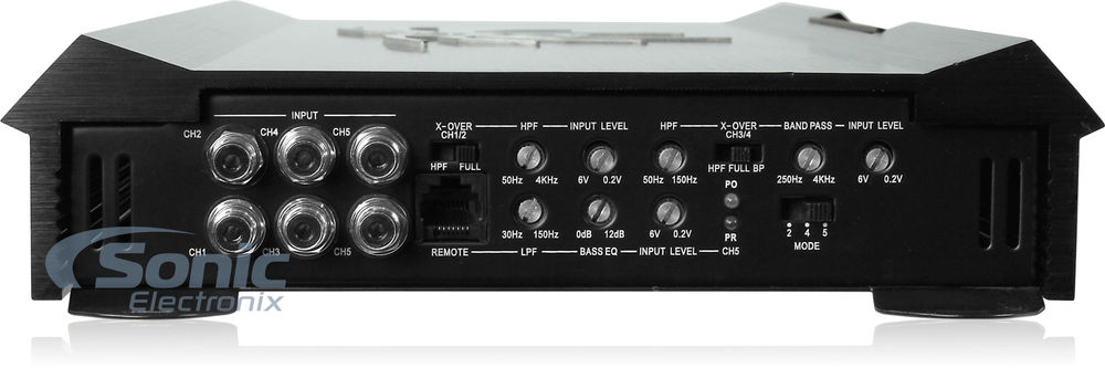

what amp did you get. most 5/6 channel amps have the ability to provide input for 5th channel from inputs to channels 1 thru 4. you shouldn't need the second LOC if that's the case.
Thanks Chipmunk for the hint, can you tell me how usually this would be wired. Thanks again, much appreciated.
notice how the lower right switch has 2-4-6? that is where you say how many inputs you have. in your case, 4. so you have RCA inputs on channels 1,2,3, and 4.
the LOC's you have are fine. they generate the turn-on signal for the amp remote turn-on. just wire up one (front speaker output) for remote, not both.

your amp is fine. it's active capable which is not common.
