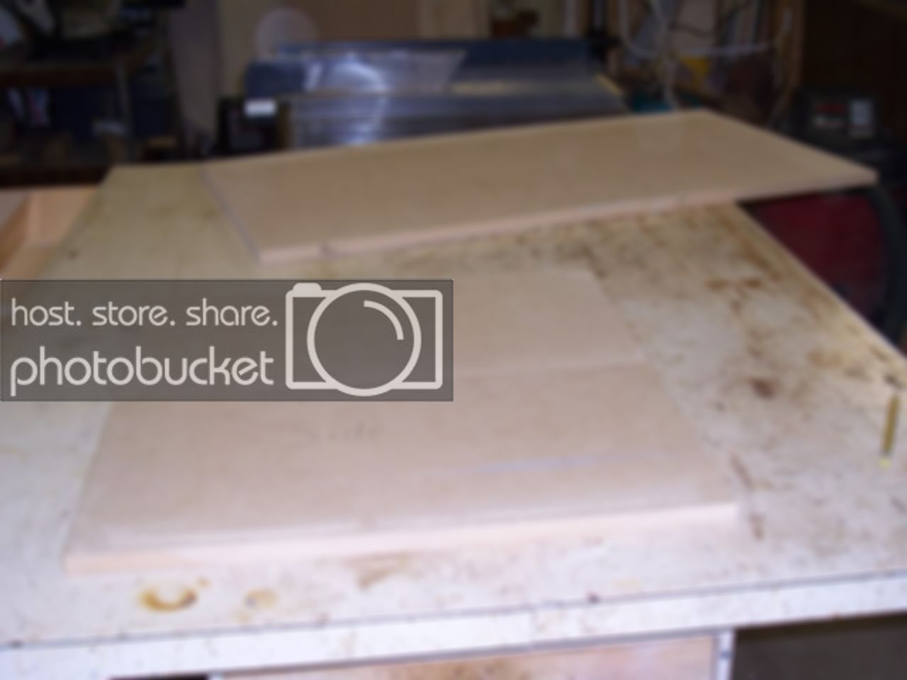

Here's a couple pieces cut out..

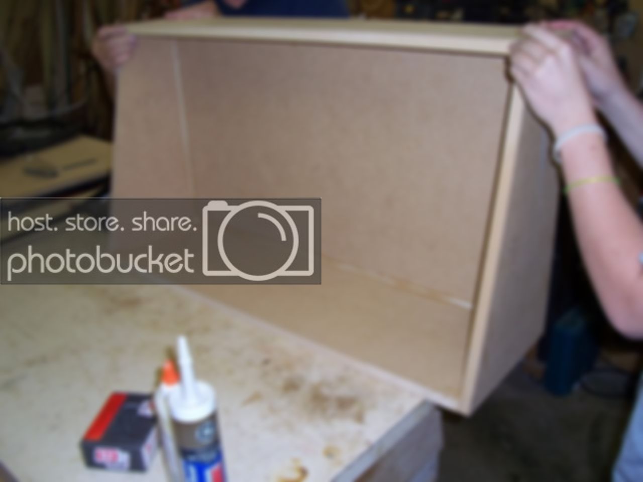

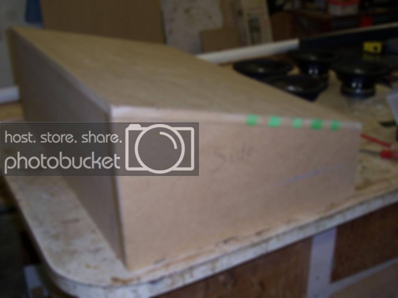

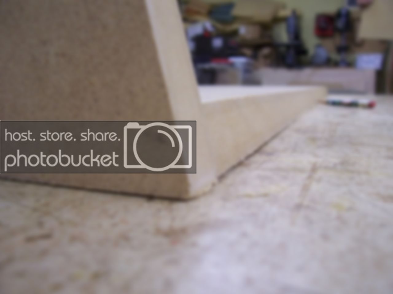

Front and bottom angles match up perfectly

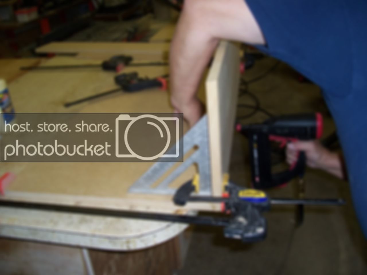

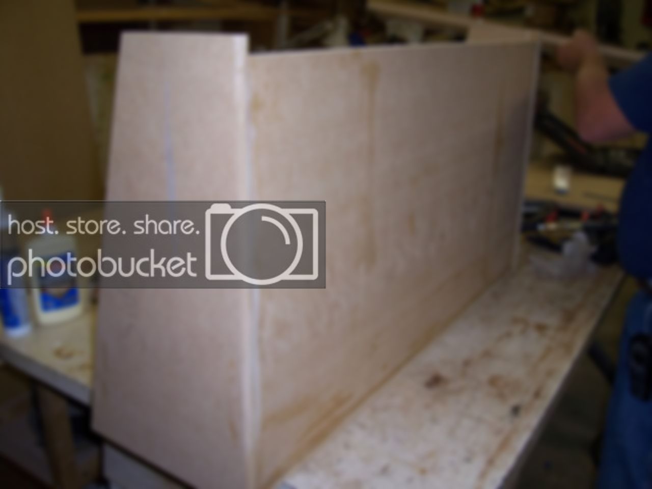

Stapling and glueing the first side on for a temporary hold before it's all screwed together.
Sides, bottom, and back glued and stapled

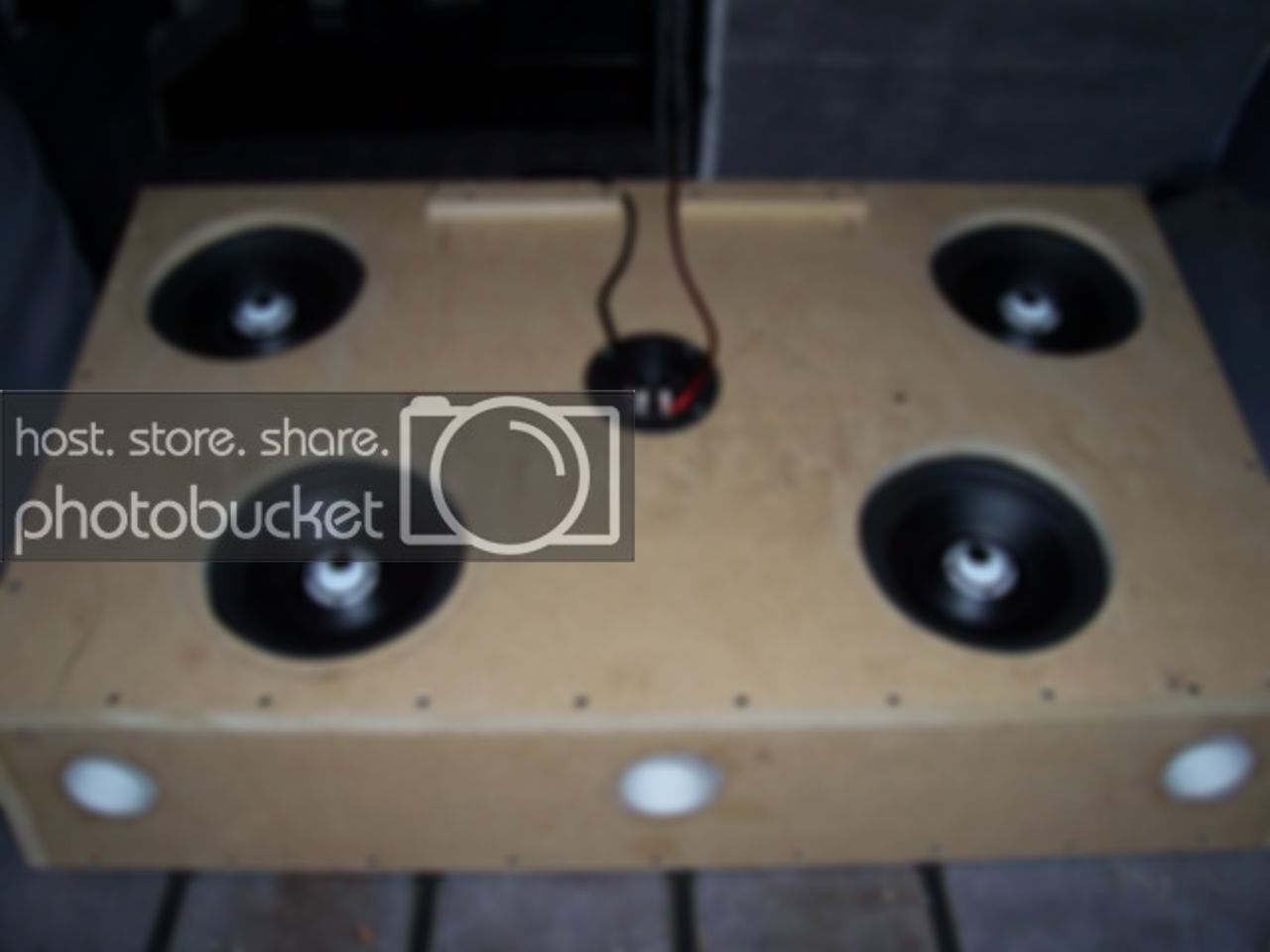

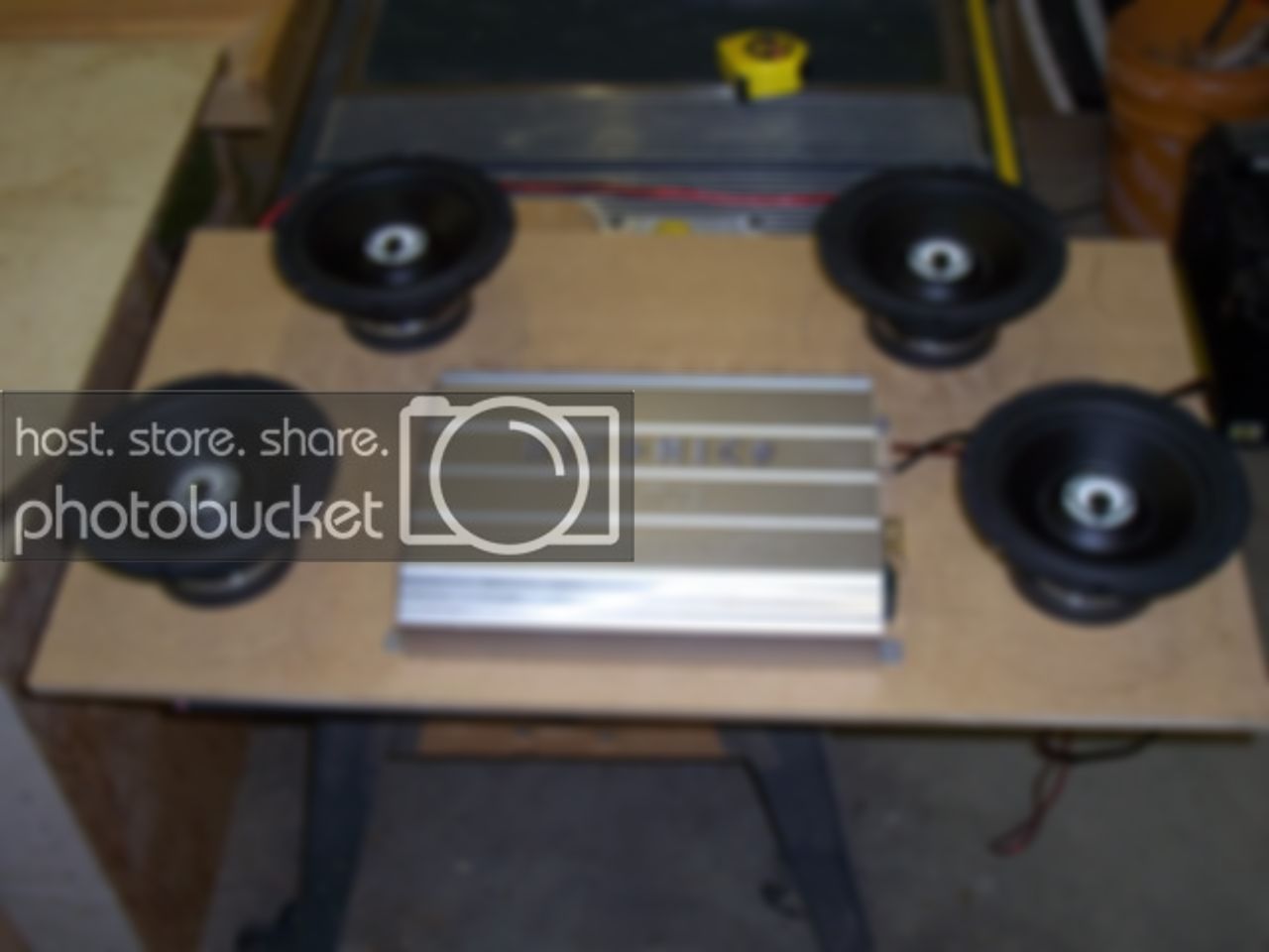

The desired arrangement...

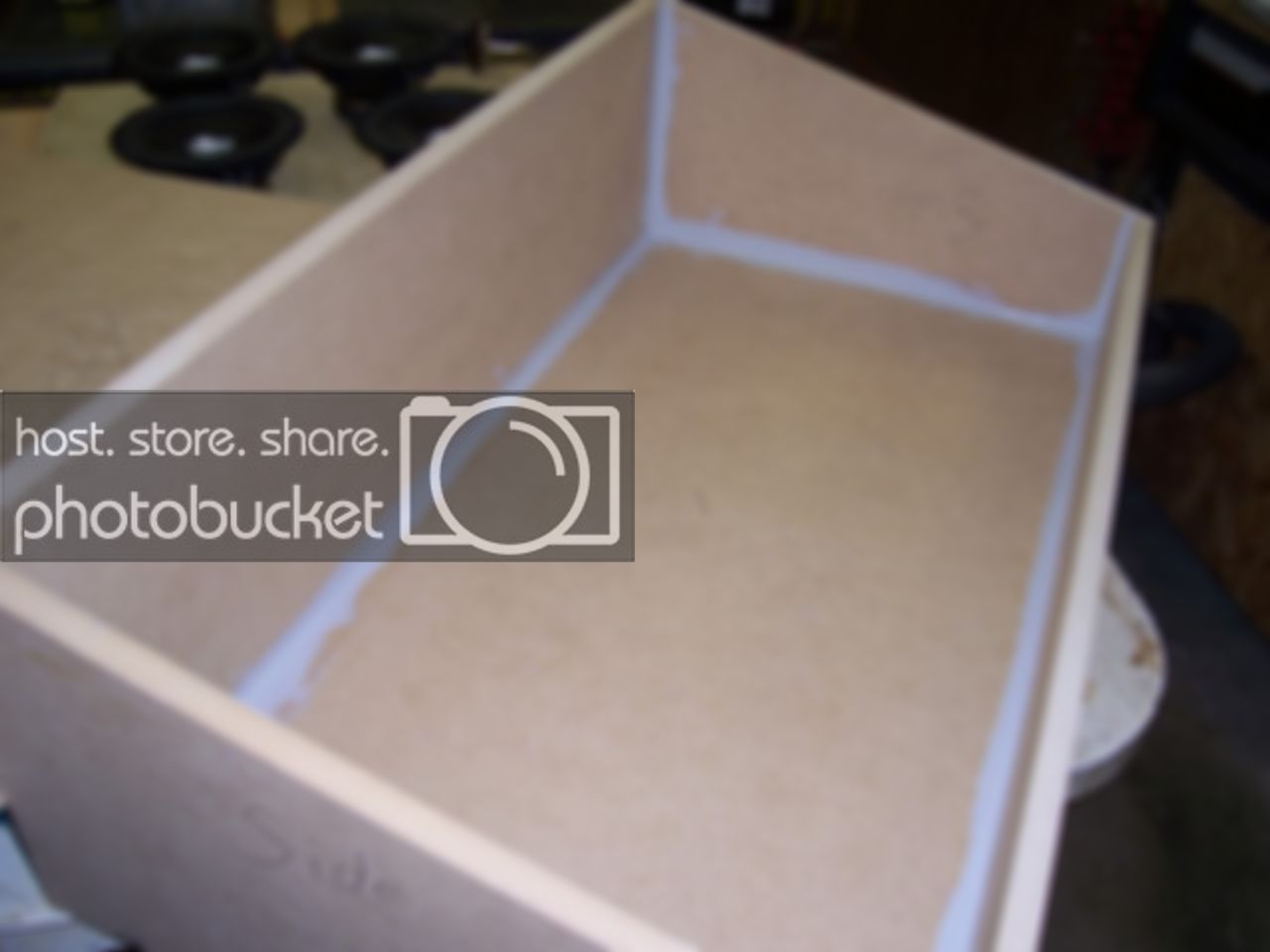

Just a little bit of silicone to seal it up //content.invisioncic.com/y282845/emoticons/yumyum.gif.0556df42231b304b9c995aefd13928a8.gif
THE BOX IS BUILT!.. but there's no holes?

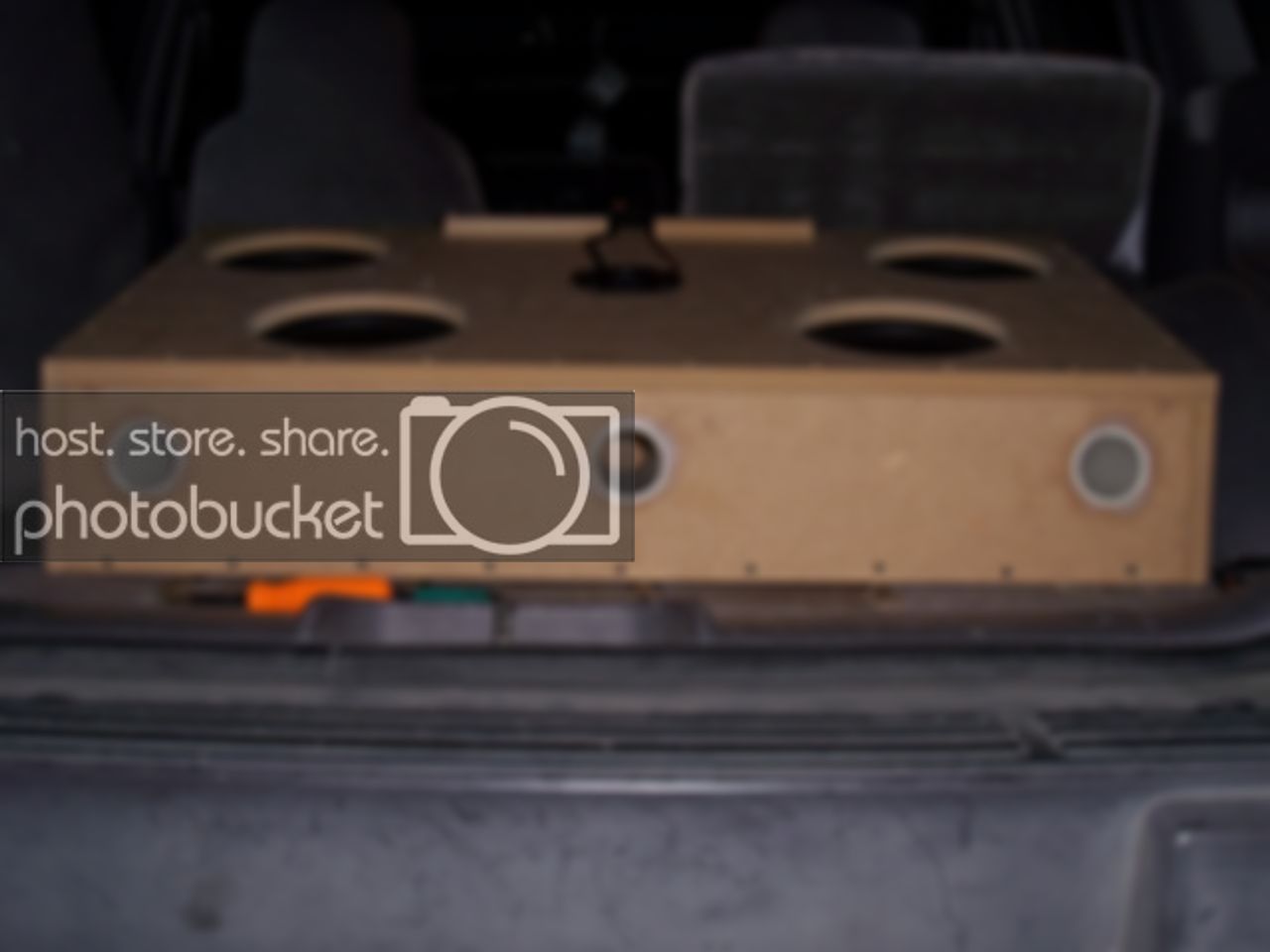

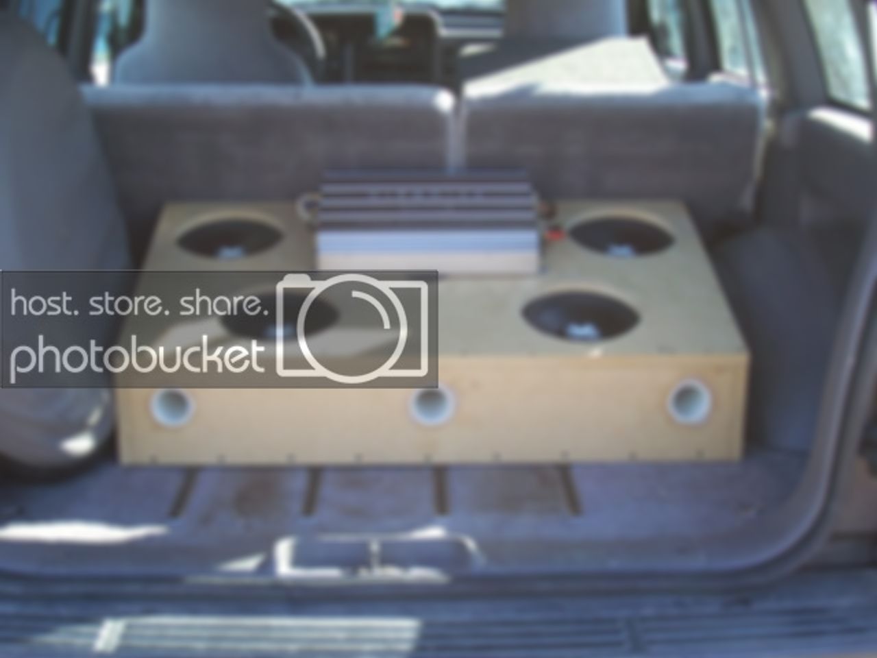

Anyways here's the finished construction of it

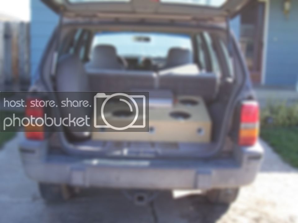

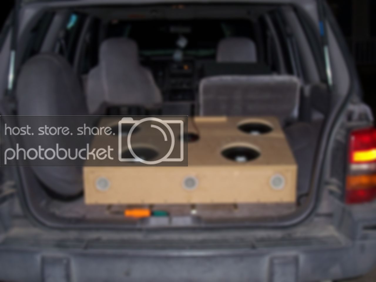

Sitting in the back of my Jeep, pretty tight fit.
View from further back, looks nice IMO.
Closer view of the back... also I realized how bad my bumper cover needs armor-all'd.
So there it is, completely done with the building. After listening to it initially, wow it is loud! Way louder then I could ever expect, and they hit lowwwwwwww! These things sound excellent while pounding.
So you're probably asking how I'm going to get to the subs if I need to.. well... we thought ahead for once. Mounting them from the inside has some advantages.. such as better anti-theft, nothing going to be hitting the cones, and the foam gasket is on the top of the basket instead of the bottom. We decided to mount them from the inside, and decided on a way to be able to take the front on and off. What we did was make our own re-useable gasket out of silicone. We layed down a bead all the way around, then used strips of the real thin plastic that Dillions plastic bags are made of and put them over the silicone all the way around. We put the top board on and let it sit overnight. Next afternoon, we took of the board, and pealed up all of the plastic. Voila, a perfectly fit silicone gasket all the way around.

I hear no port noise at all //content.invisioncic.com/y282845/emoticons/yumyum.gif.0556df42231b304b9c995aefd13928a8.gif

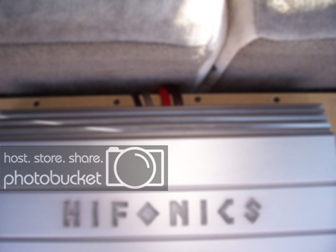

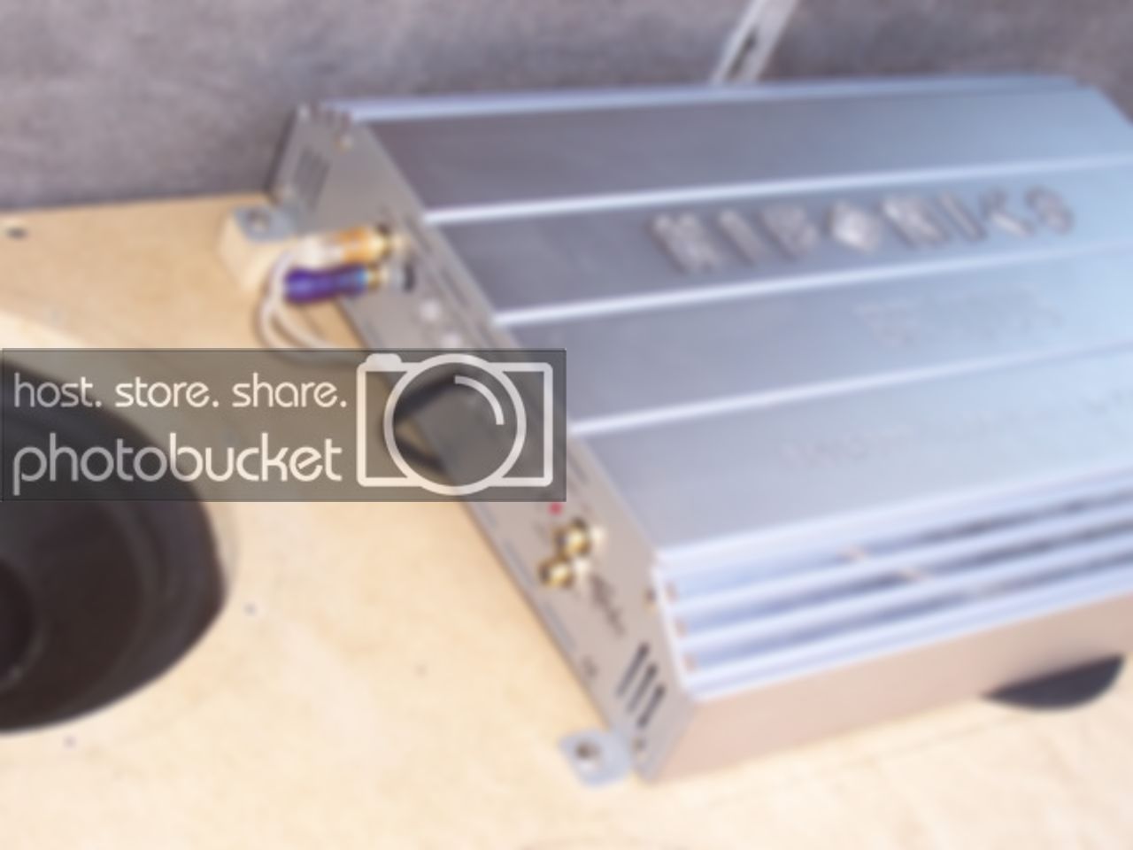

I still need to do a little adjustment on the deck and amp to get it where I really want it, but as of now I love em. Got the amp mounted today //content.invisioncic.com/y282845/emoticons/biggrin.gif.d71a5d36fcbab170f2364c9f2e3946cb.gif
Far back view...

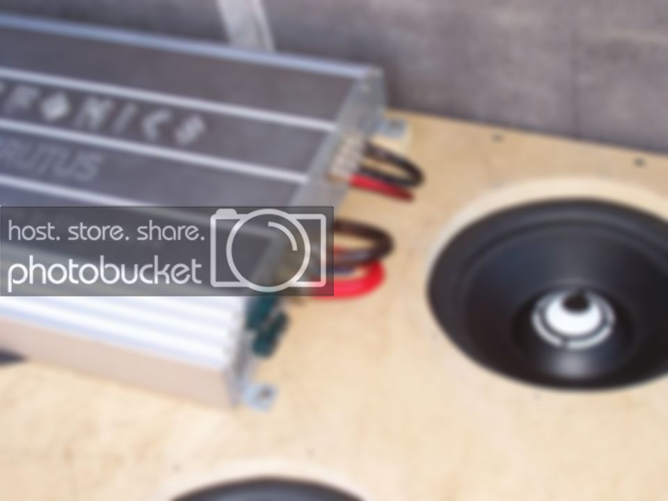

Power and speaker wires, 4ga power 8ga speaker.
RCAs and bass knob wires
Wires run out of the little cut-out, down the back of my seat, and then under the back seat.
Closer view of it all
