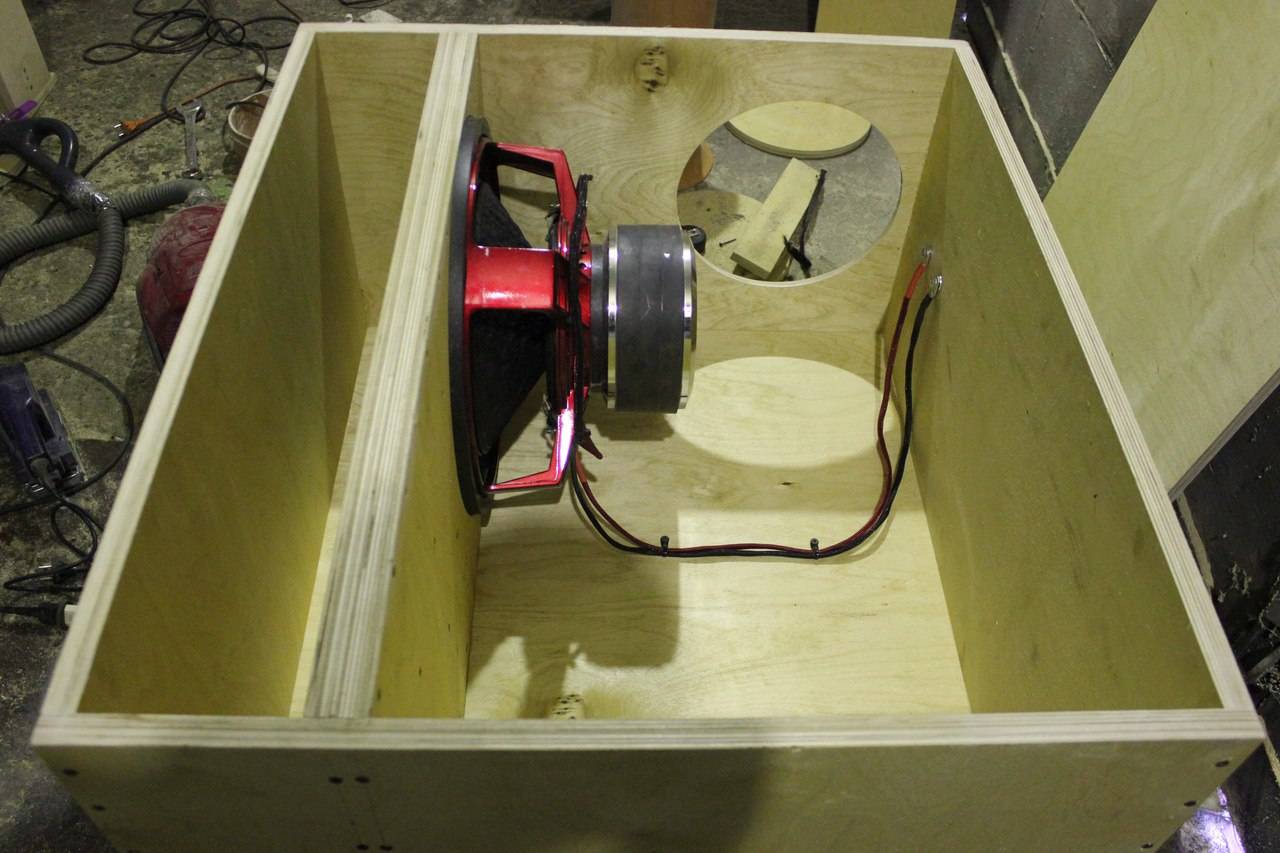

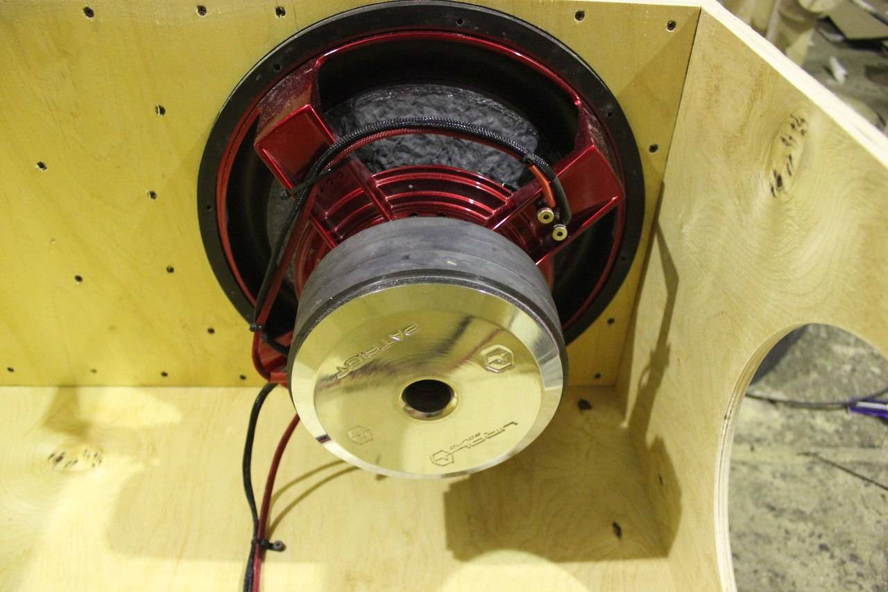

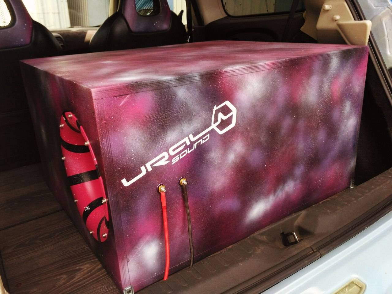

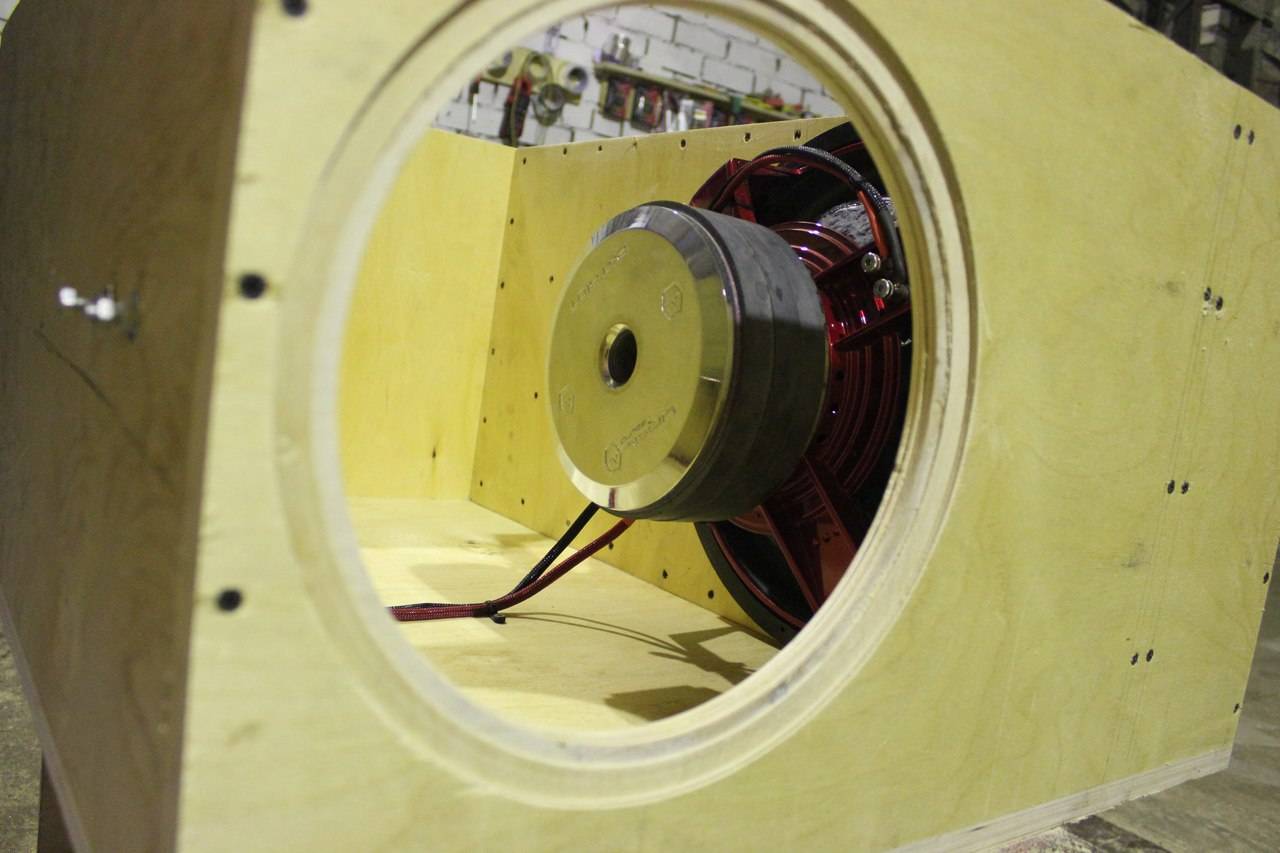

I did bandpass 4th order in Nissan Micra. Closed box is 40 liters, vented box is 135 liters. Port is tube at 200 mm diametr and 350 mm long. Play very good.
Sub is Ural Patriot 15" and amplifer Pride 2k (2000 Watt)

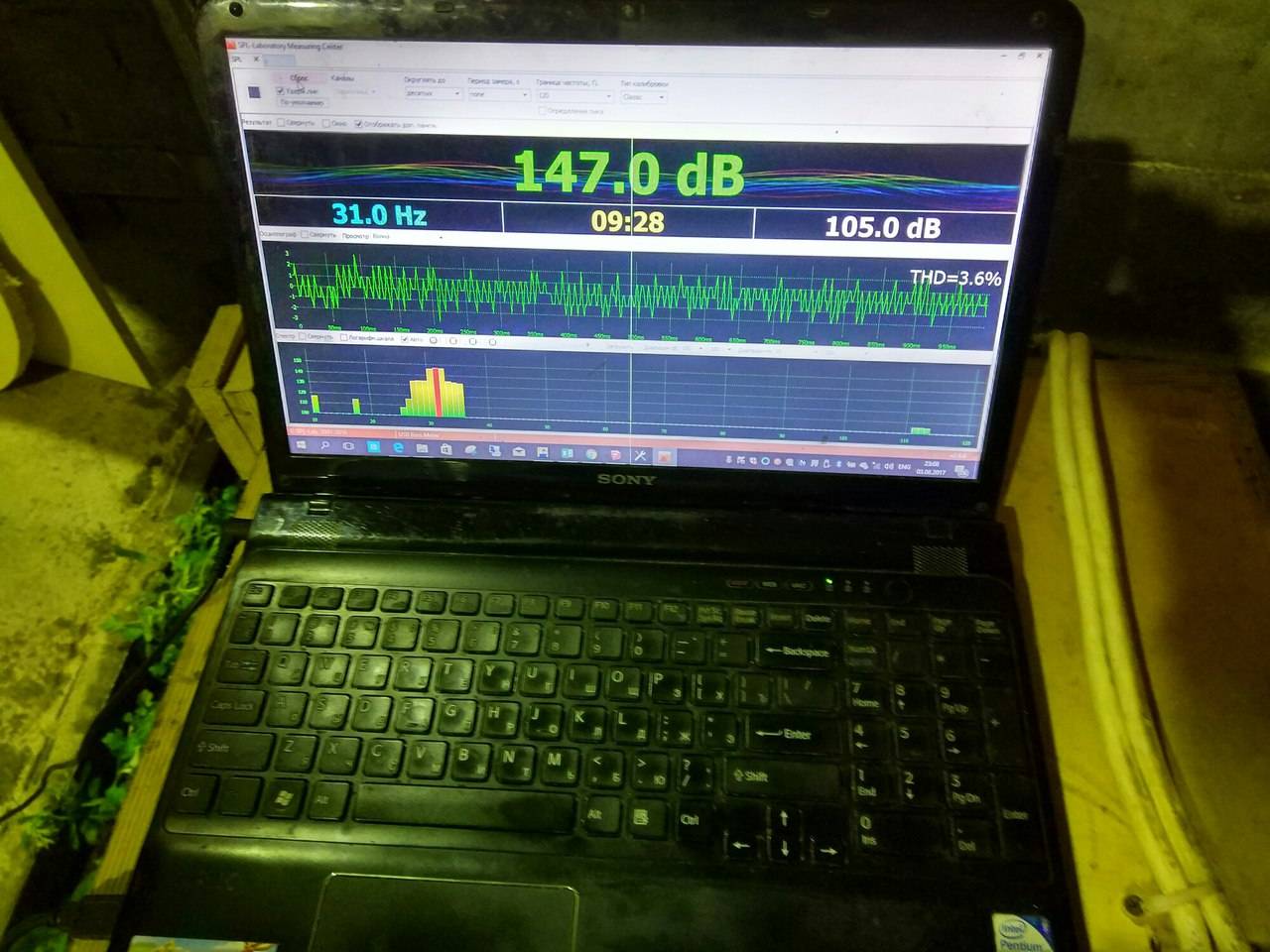

Yes, I'm also experimentation to find perfect port witn SPL-LAB BassMeter

good looking box.
