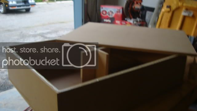

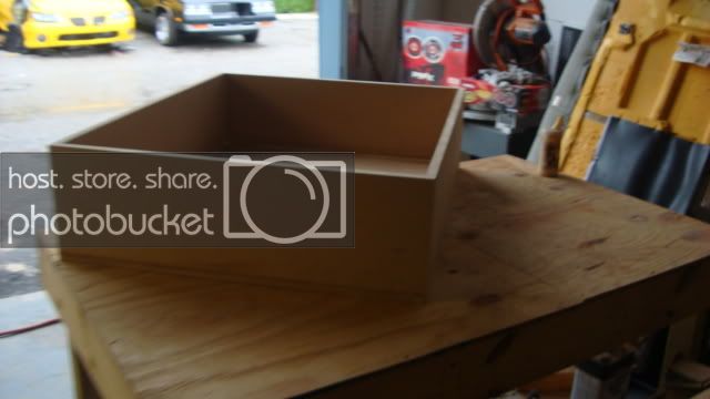

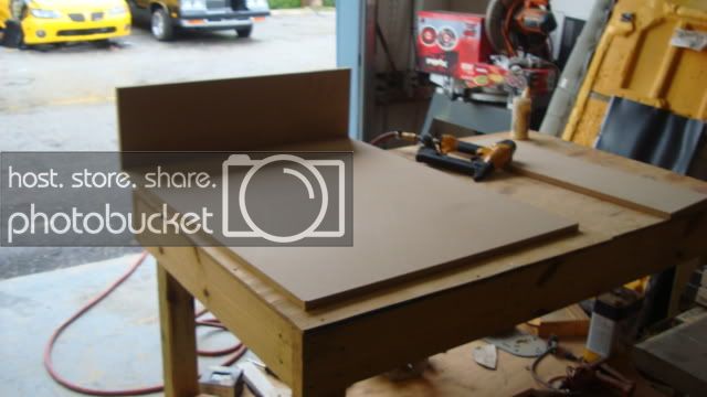

Ok I figured I'd do a build log for this box
it's going into a customers Caddy
it's a 4th order ported up thru the rear deck
it will house 4 JL audio 12 W0v2 on just 1100 watts @ 1 ohm
(I kno I kno very little set up ) but that's what he got so that's what I build
this is just pics of the box and upper chamber
the two faces that are open noew will be removable ane made from lexan
(for show and service for subs if necessary ) it will be installed into trunk in three pieces the upper (up thru deck) then the sealed box (subs and wiring )
then insides will be trimmed out (carpeted in black ) (custom caddy plaque to be added ltr ) then th lexan cover
I figured this thread would be a good warm up to my Tahoe build thread
so here it is I install it all tomorrow so rest of pics to follow
(please don't be too harsh w/criticism)lol

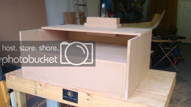

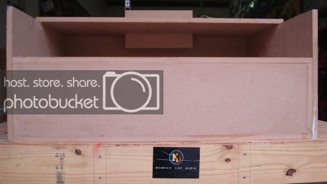

last nite into this morning i just designed and help build a 4th order for 4 fosgate p3 12's in a 2003 caddy stswith 2 hifonics brutus 2010 ( all he had)
and he sounds really good
80
pics ?? really interested
i will get pics up soon...but the box is 2.6 cubes sealed playing into 5.8cubes ported with 105 square inch port tuned to 50hz...and let me tell u..the owner kept kalling me alday today kuz he so happy
80
