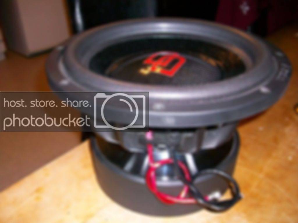

So far I only have the sub and box is getting here monday. Later next week I will have money to buy an amp (any suggestions?). Looking for something around 2k-3k for daily and want to spend around $300. I also will be doing the big three soon will get pics of that as well. Last thing I will probally do is put some deadner in. The back wall needs it pretty bad i know I should do it first but im having bass withdrawls lol!
Im going from a Treo SSX in 3cubes on about 1800w, had the sub and port firing foward and was told its alot louder for a truck to fire up sooo hopefully ill like it better. Traded the SSX for the 9512G. Its still nice and stiff //content.invisioncic.com/y282845/emoticons/biggrin.gif.d71a5d36fcbab170f2364c9f2e3946cb.gif
DD9512G CF dustcap D2
3cuft. @ 35 hz

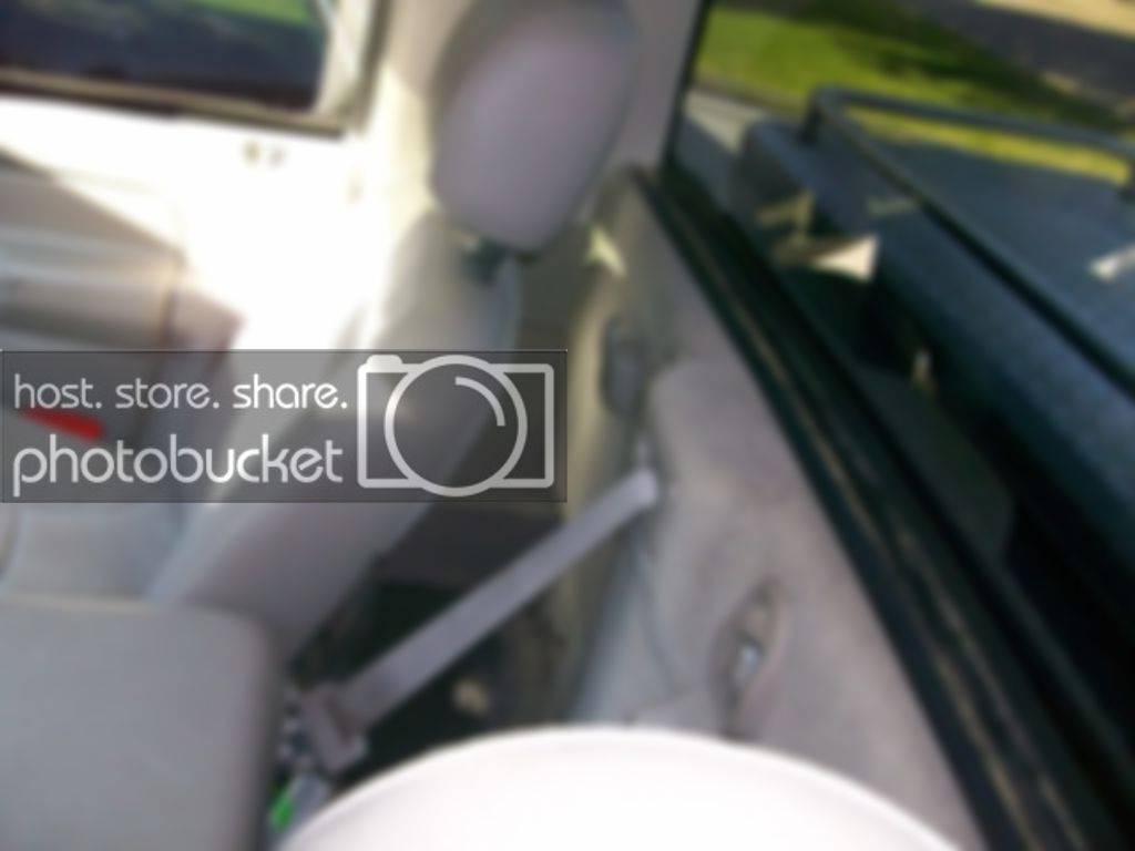

Deadner on back wall

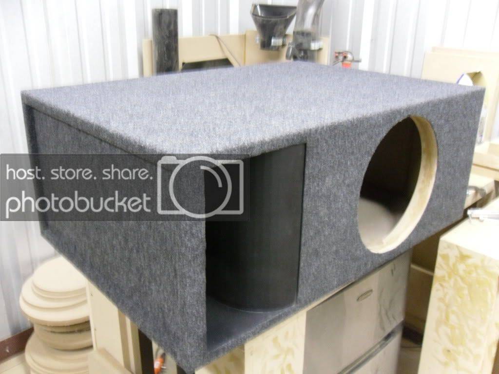

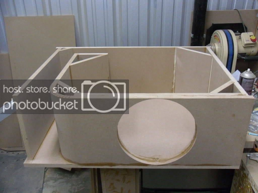

Box built by pioneer_saturn, going to have the port and sub firing up.

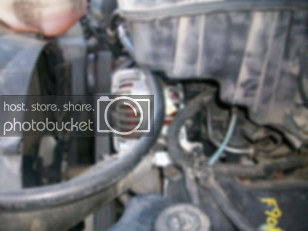

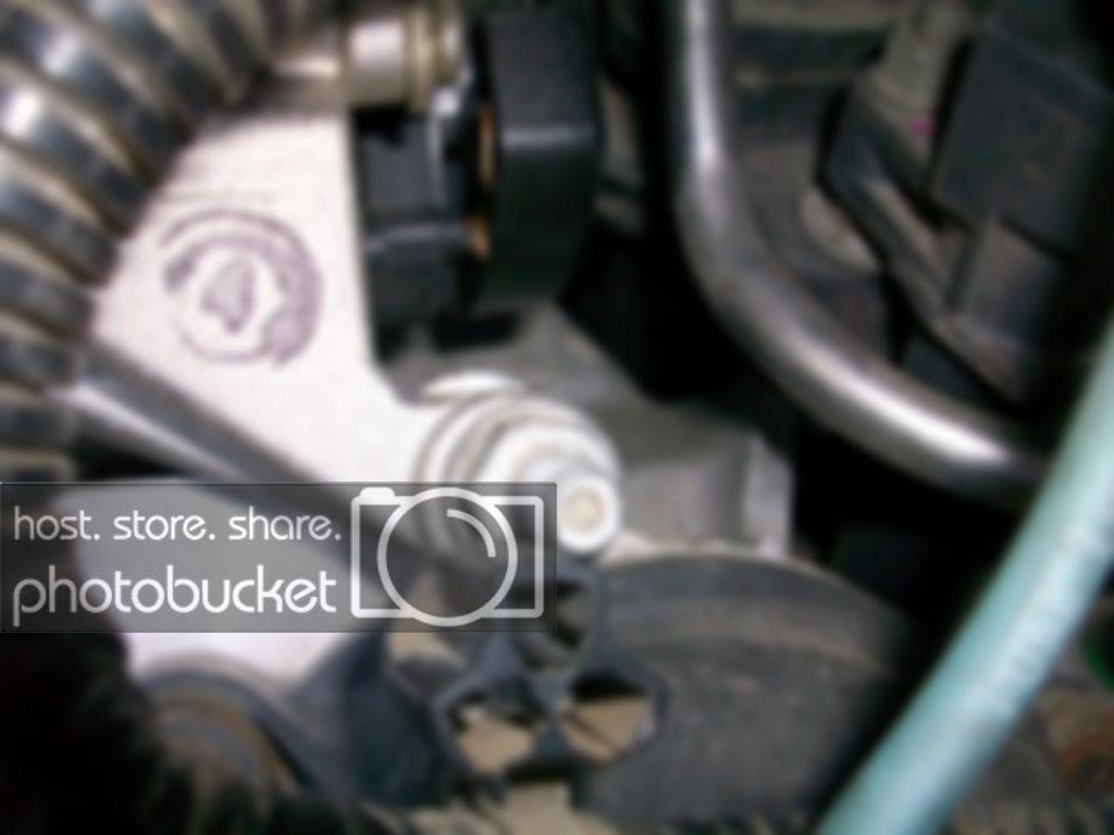

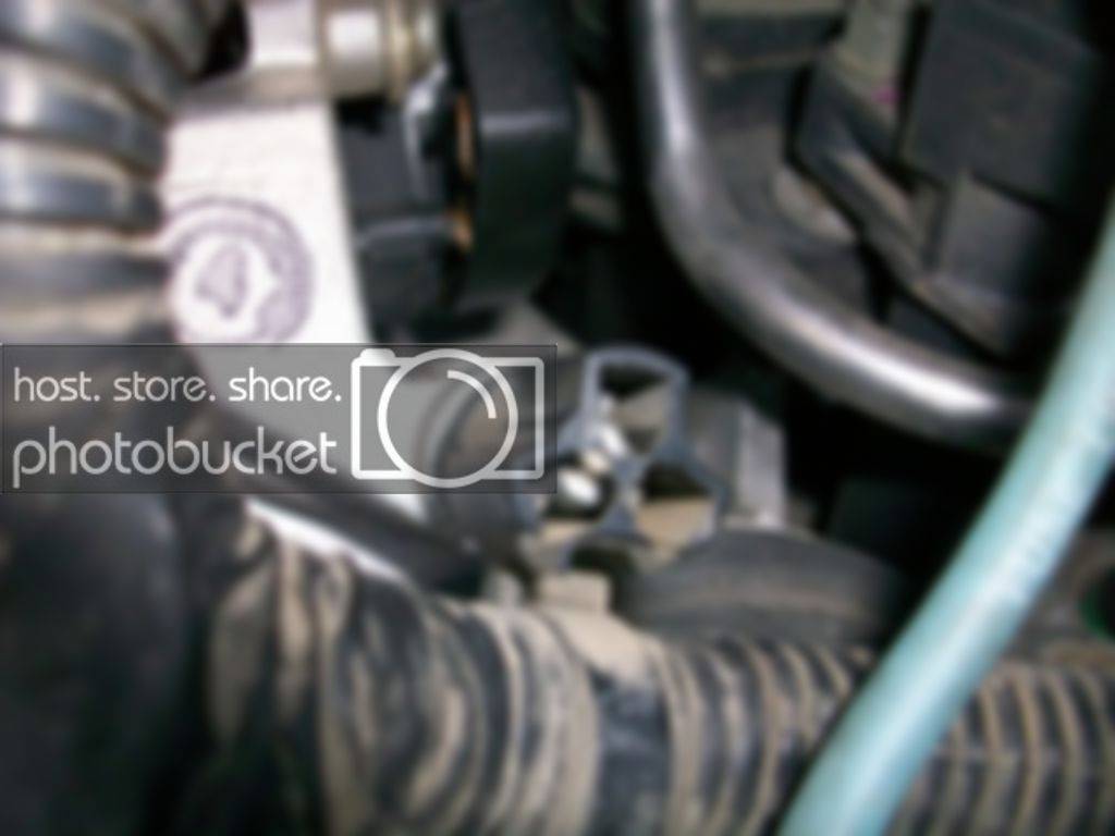

Is this the pos on my alt? Put the dmm on it and connected the ground on dmm to the neg. on battery and didnt get any reading. I hope this is it cause I think I have to take off alot of crap to get to it if it isnt.
What happened to your Audiopipe? BTW box looks good!
he didnt wanna put the money into his electrical..and now is looking for 2-3k for 300 that's gonna drop voltage also...dude you have to upgrade electrical..and no thats not the positive..thats a ground point...your positive will have a wire coming directly off the alt.
here i a pic. farthest to the right...is the back of your alt...thats where its at. lower right corner of the first pic.

Yeah have quite a bit of room back there. box is 13" wide so it will work out.

your positive is on the top of the alternator... you have to remove the airbox. For the grounds there are 3 of them in the rams, 1 to the body right next to the battery, 1 to the engine block, and 1 to the frame. 13" wide box is going to get on your nerves, or your passengers nerves i guess depends on where its going, i never went deeper than 10.75" in my dodge and even that was pushing it sometimes. Goodluck
okay thanks. Yeah I had a 13" deep box and it wasnt that bad. It did push the seats up quite a bit but the box wont be behind my seat this time so i dont care //content.invisioncic.com/y282845/emoticons/biggrin.gif.d71a5d36fcbab170f2364c9f2e3946cb.gif That stupid 2" hump on the back wall gets in the way big time.
yeah on all my boxes i had to cut a channel in them to go around that hump
