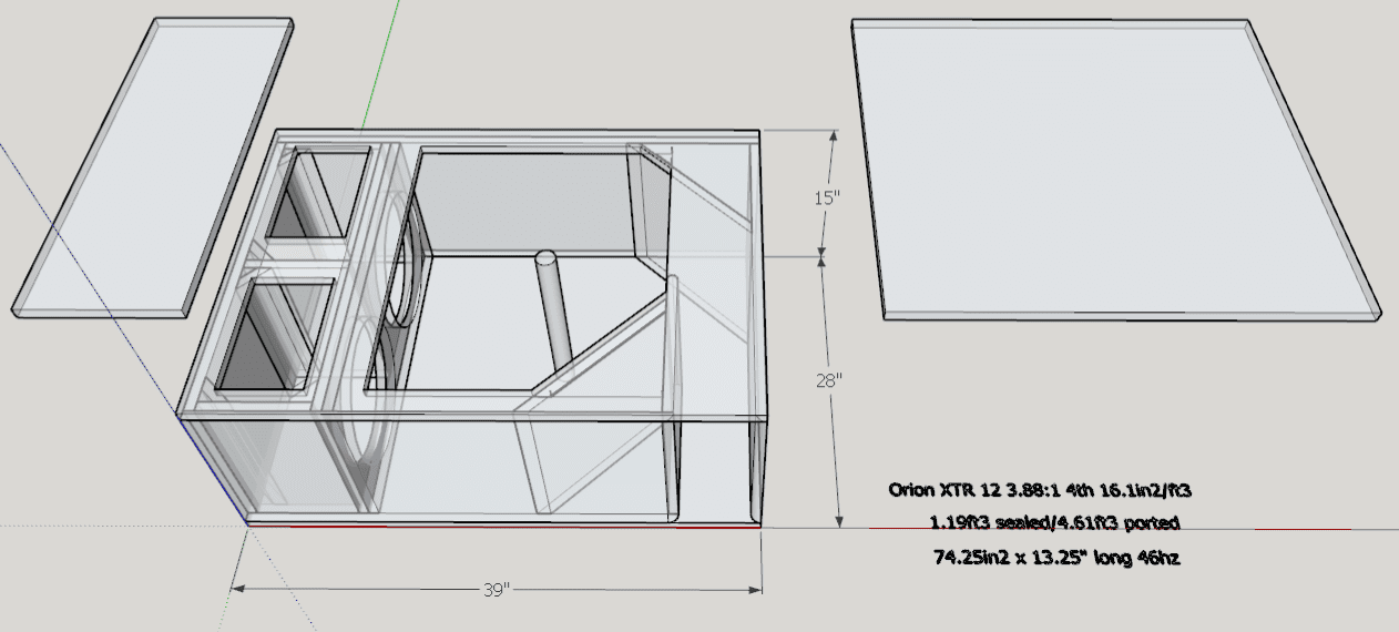

Something like this?
1.19ft3 sealed/ 4.61ft3 vented around 46hz
Haven't drawn 1 up in Sketchup before... the removable top was something I had to add... lol
Not really sure if this'll work tho... really don't understand what to look for modeling up a 4th, seems like the sealed side is kinda large and that made the whole thing HUGE.
If it's off lemme know, I'm wanting to learn 4ths anyways and practicing Sketchup is making me better at it.

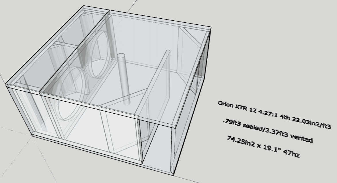

1 cube sealed 2 ported 70in^2 tuned to 45
Thx... I saw the sealed bein' smaller really controls that excursion problem it had the 1st few times...//content.invisioncic.com/y282845/emoticons/thumbsupwink.gif.129404938effda6ad9cca39e7f4b58a3.gif
That quote got me lookin at it
Sealed side is too big, anything above .75cf allows the subs to exceed xmax on 1200rms. Not good.
