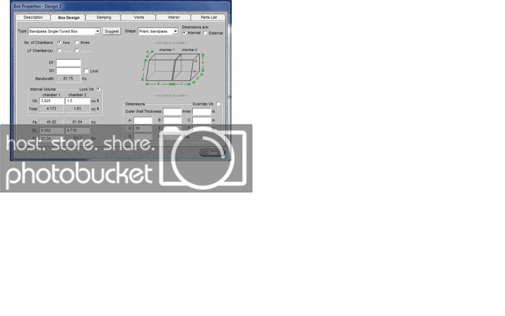

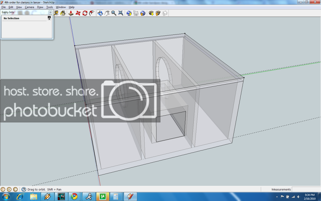

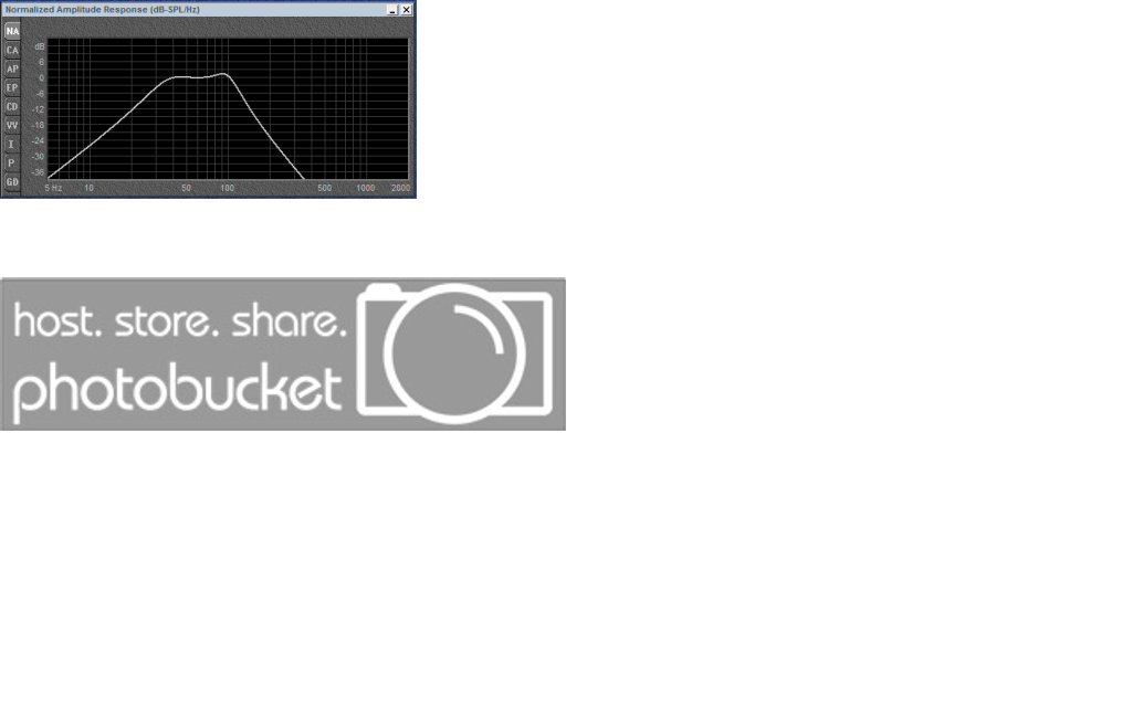

This is my first attempt at a bandpass enclosure. This would be for 2 clarion pxw1251 subs. Will be for the trunk of a 2010 lancer, probably facing the rear because i dont have a rear seat that folds, once i make it fold things will change.
