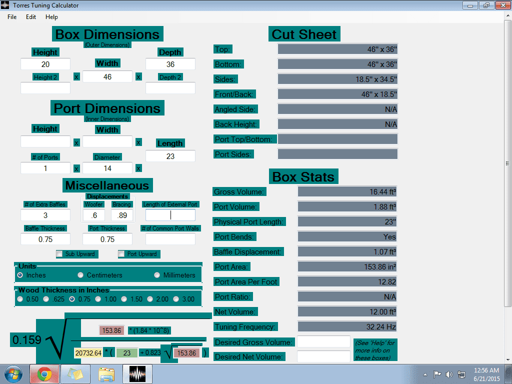

I do believe you should go for two 18s with a round port man. Well worth the jump if you have that much space. I played with some numbers with torres box calculator and I'm being very generous with a lot of bracing for a rock solid box, you'll still have close to 12 cubic feet even after all that bracing/port/subwoofer displacement.
