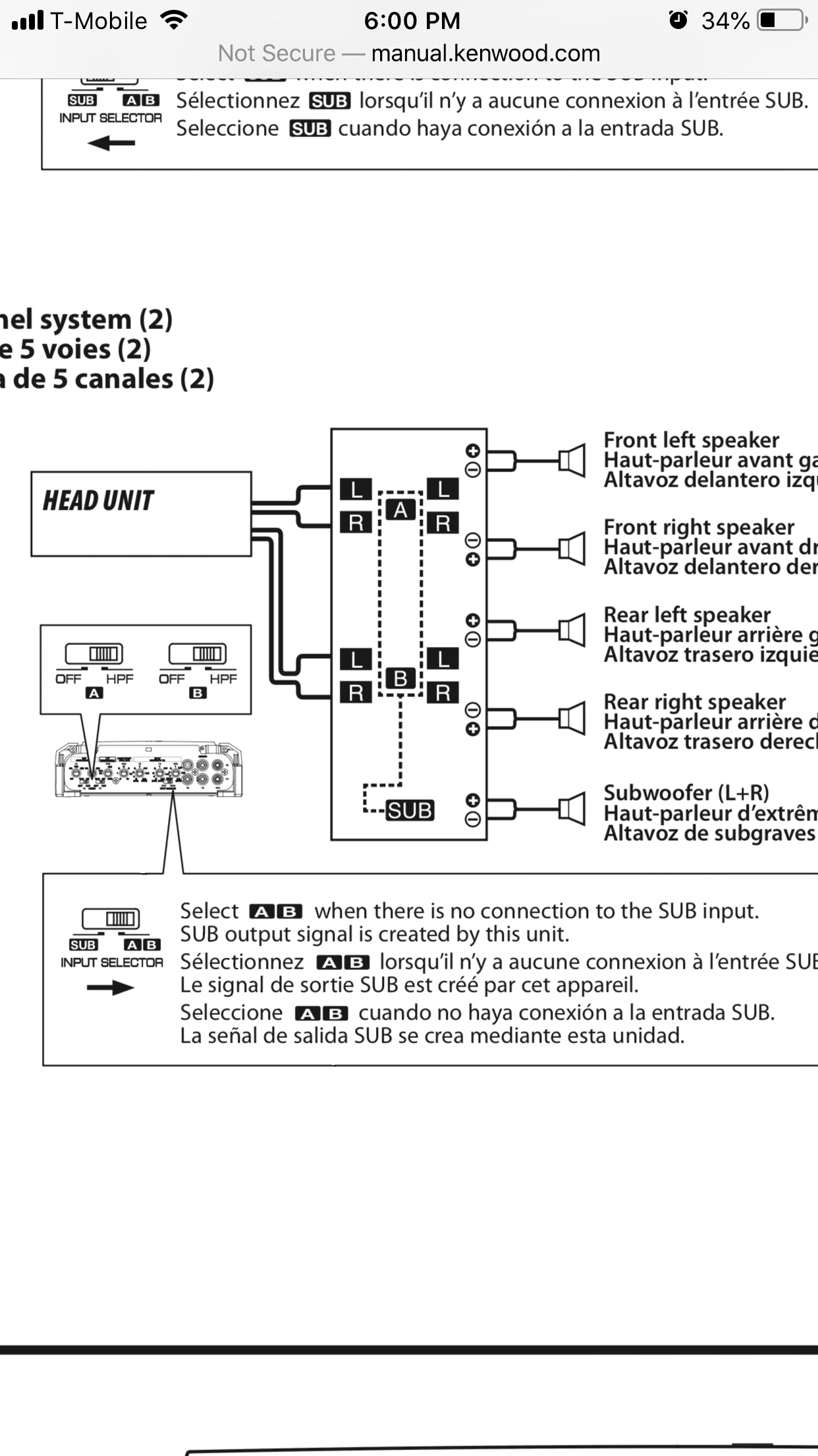

But by any chance does your sub have an option to generate a sub signal from the 4 inputs?
It’s usually a dip switch. It tells the amp where to get the signal from. I can post a picture in a bit. Kinda explaining what I mean. English isn’t my major lmao
Kinda like this. Sorry for spamming the thread. I didn’t know I could post an image from my phone
