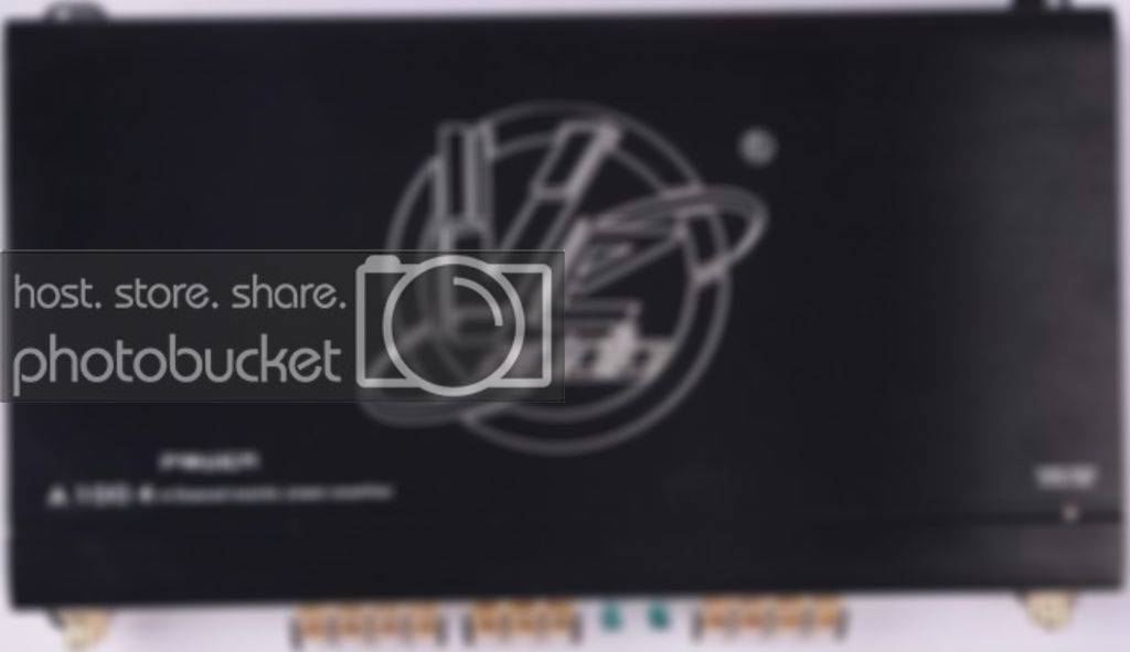

Just in case you like compact size with Class AB functionality.
Gold plated controls, brushed aluminum housing.
Power Supply can accept below 8v.
Tested to withstand 0.25ohm operation in stereo mode and 18v spikes for brief instances. Very durable.
It is our SQ Brand - VE Audio.
