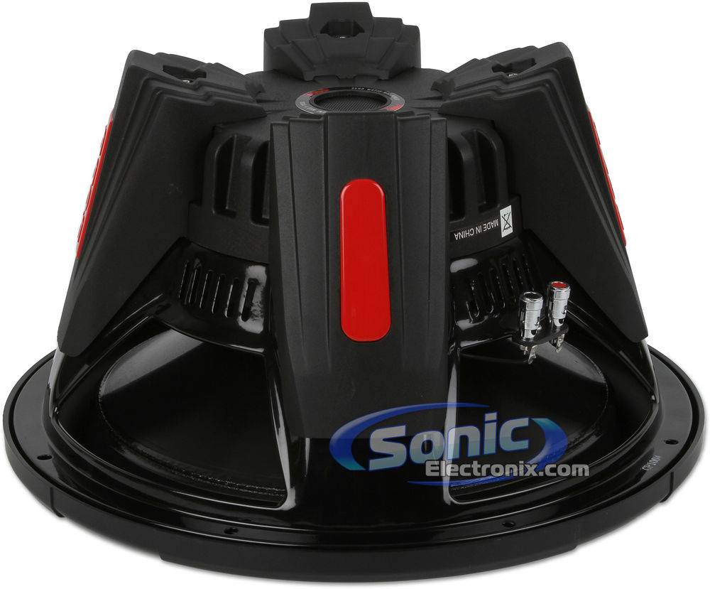

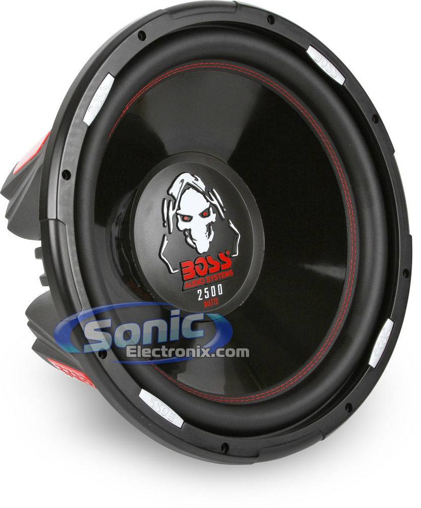

These are the subs OP is talking about running 1,500 watts each to.
