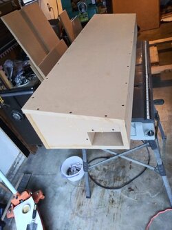

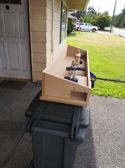

Was given an opportunity for a local guy to build him a ported box to fit under the rear seat of his SUV. Modeled it up in Sketch up and got done with it a few days ago. Still gotta cut the mounting holes as I'm waiting for true measurements from the guy once he gets the subs.

Did you design the enclosure or just build it?
Port looks very small, why didn't you make it the full height?
Thought it looked smallish myself but don't know anything about designing. He got the design from someone else, I just built it....and noticed 2-3 dims that were off. Imma tell the guy not to go thru with him again. Wasn't even given a 3-d drawing, barely any pics showing what it will look like. Supposilly, the port is tuned to 35Hz but it's 10" in length. I hate to see the actual tuning from a few gurus on here and have the guy dissapointed and build a new one.
I haven't asked him what amp he's going to power them with but I will when he comes and picks it up. I def didn't design the enclosure. I don't know if I should release the actual dims on here and have someone look into the specs on it and let the guy know he'll be disappointed with it or wait until later then he'll tell me it sounds like crap.
if the airspace is high, with a small port like that it should be 35hz just might run into compression when you put a lot of power onto it.  If its a low powered setup then small port area is okay.
