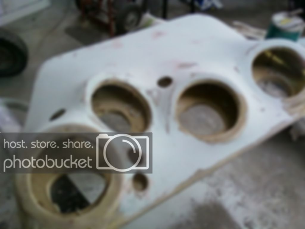

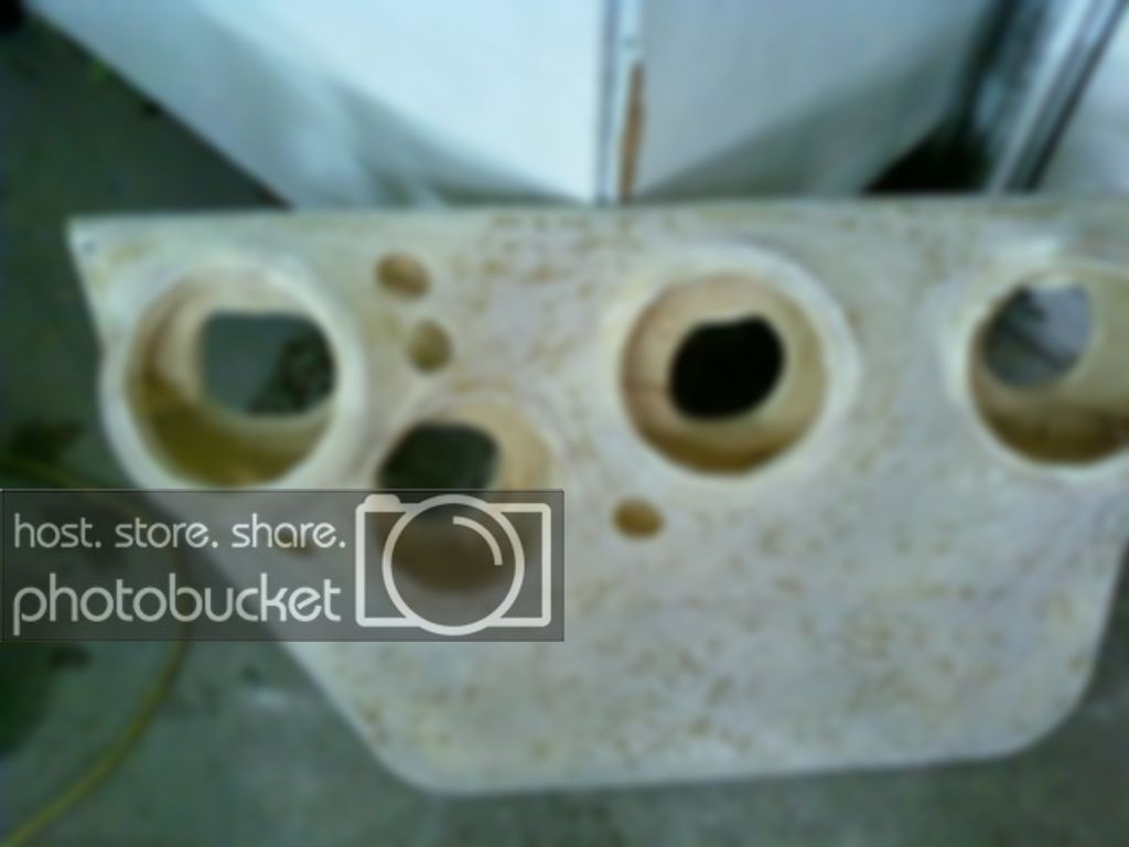

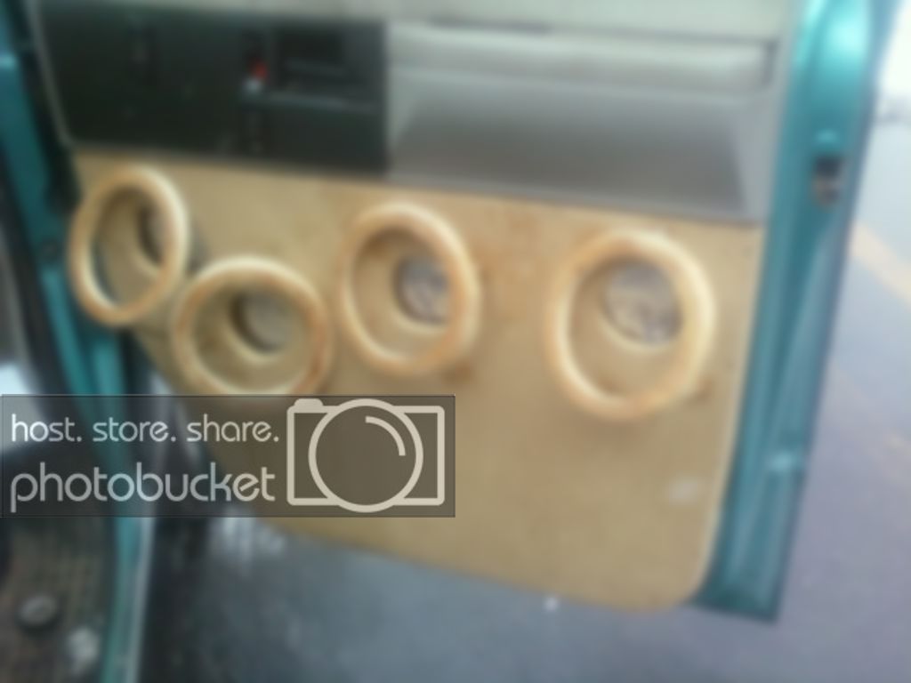

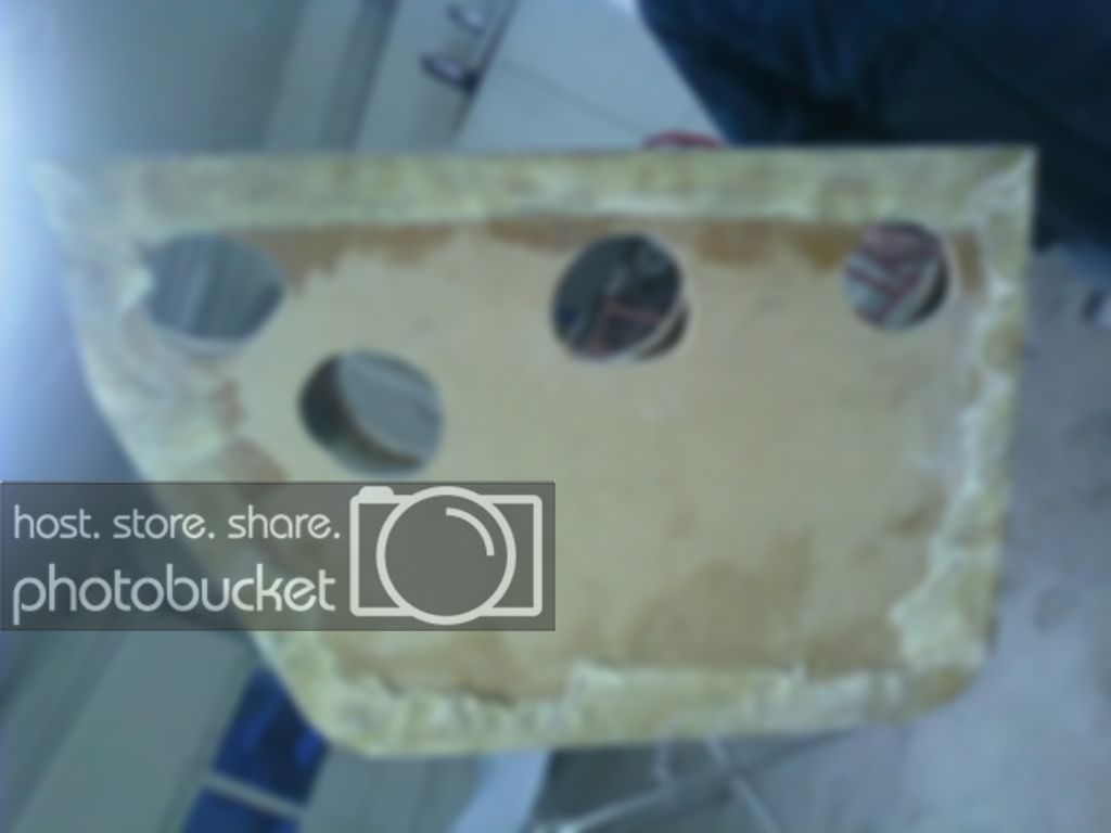

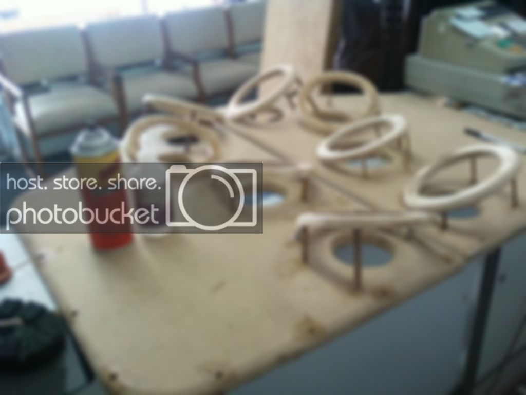

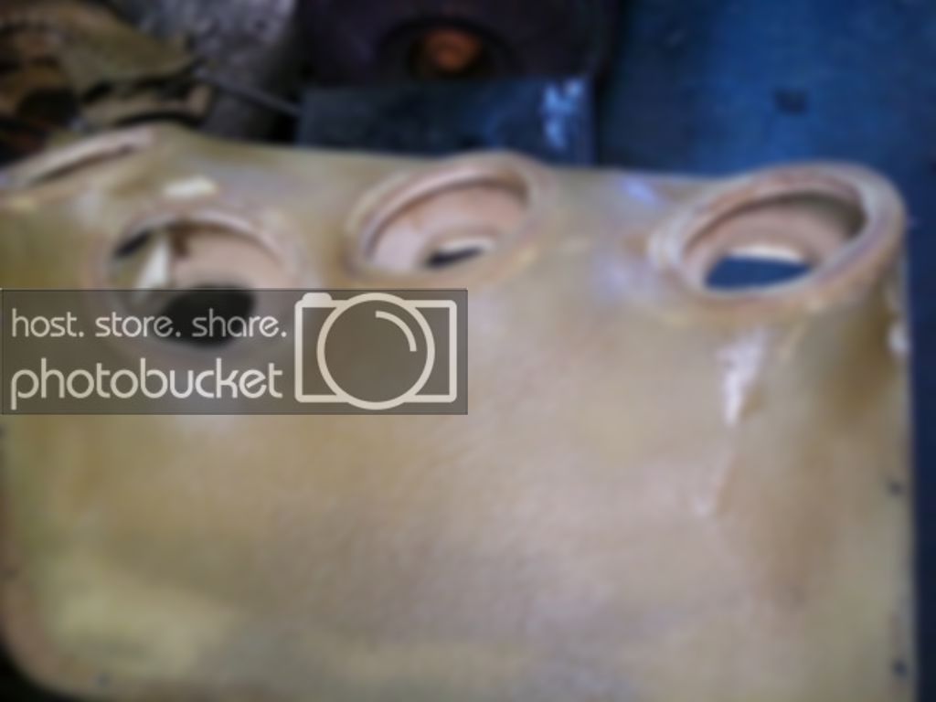

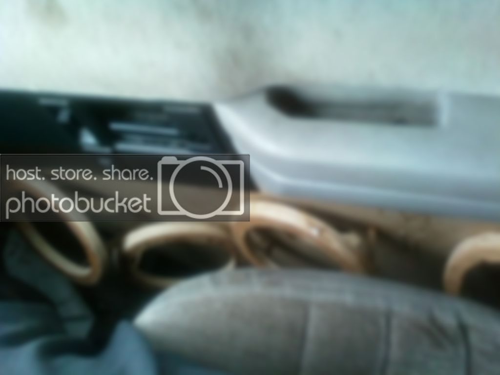

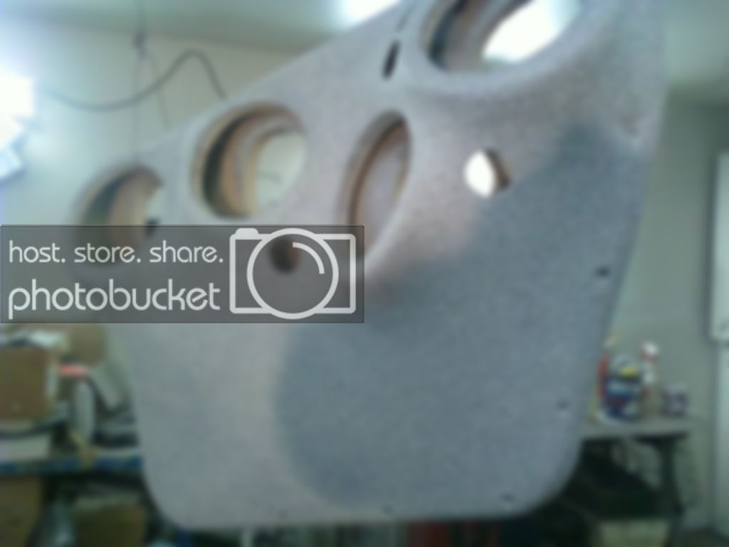

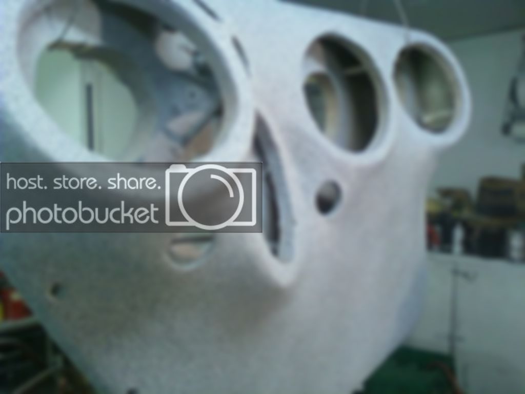

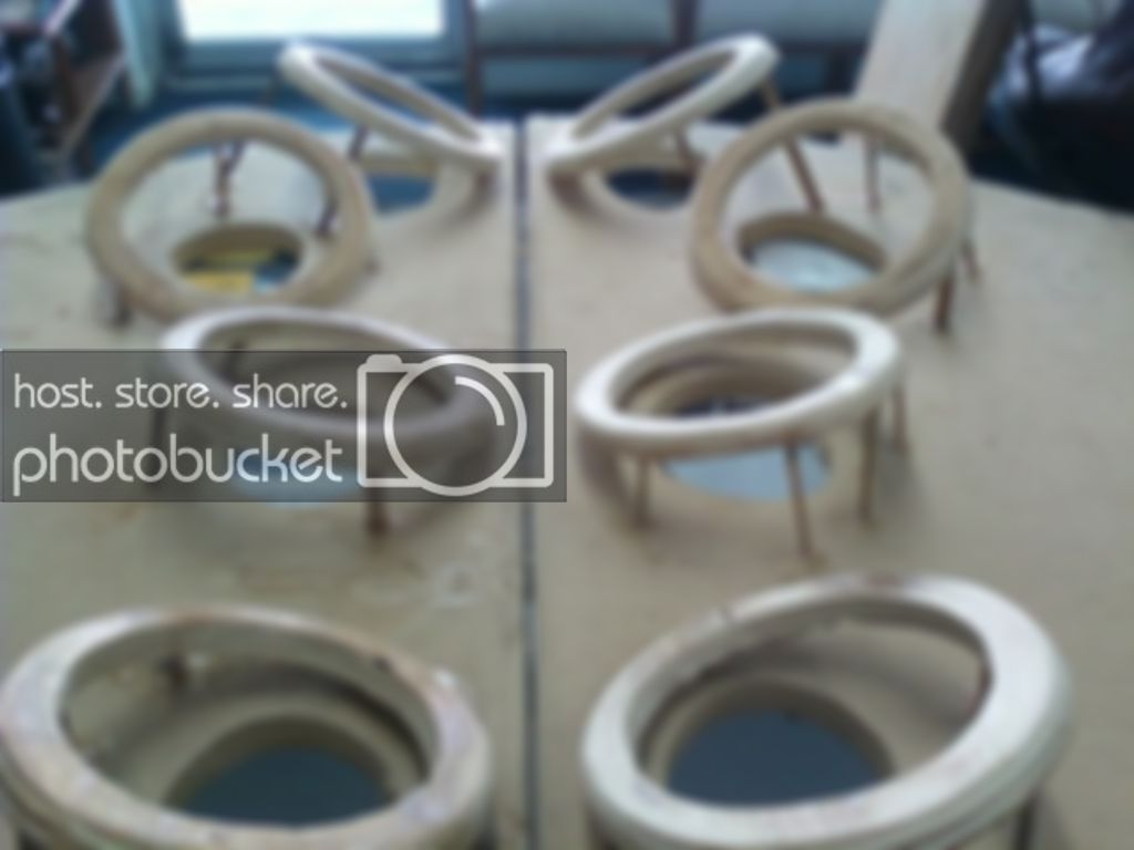

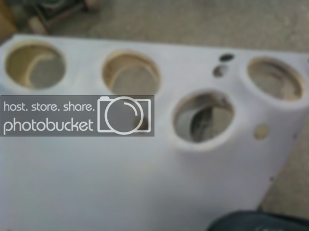

i'll show the material. and how i wrapped it. its wrather easy believe it or not. just when your going big like this you have a lot of dry time and materials and actual fiber glass is needed.
i started with a stretchy material. like a kids blanket type material(fleece). just a plain cloth thats a little fuzzy. it holds the resin good.
1.) get a base form ( like the mdf i originally had on the doors to start),
2.) set up your speaker pod, (the mdf ring angled and supported behind)
3.) take a piece of fleece and stretch it over the top around the back side,
use a staple gun and staple it into the back side after you stretched it over your pod on the front and pulled it tight.
4.) once its all tight and your happy with the attachment, placement you can mix up some resin and hardner and start soaking the fleece all the way through and let dry, one more coat will make it really stiff.
you might not even need fiberglass.
