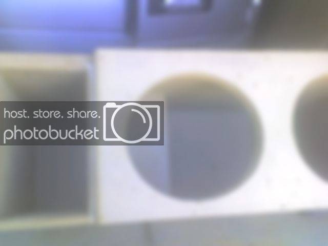

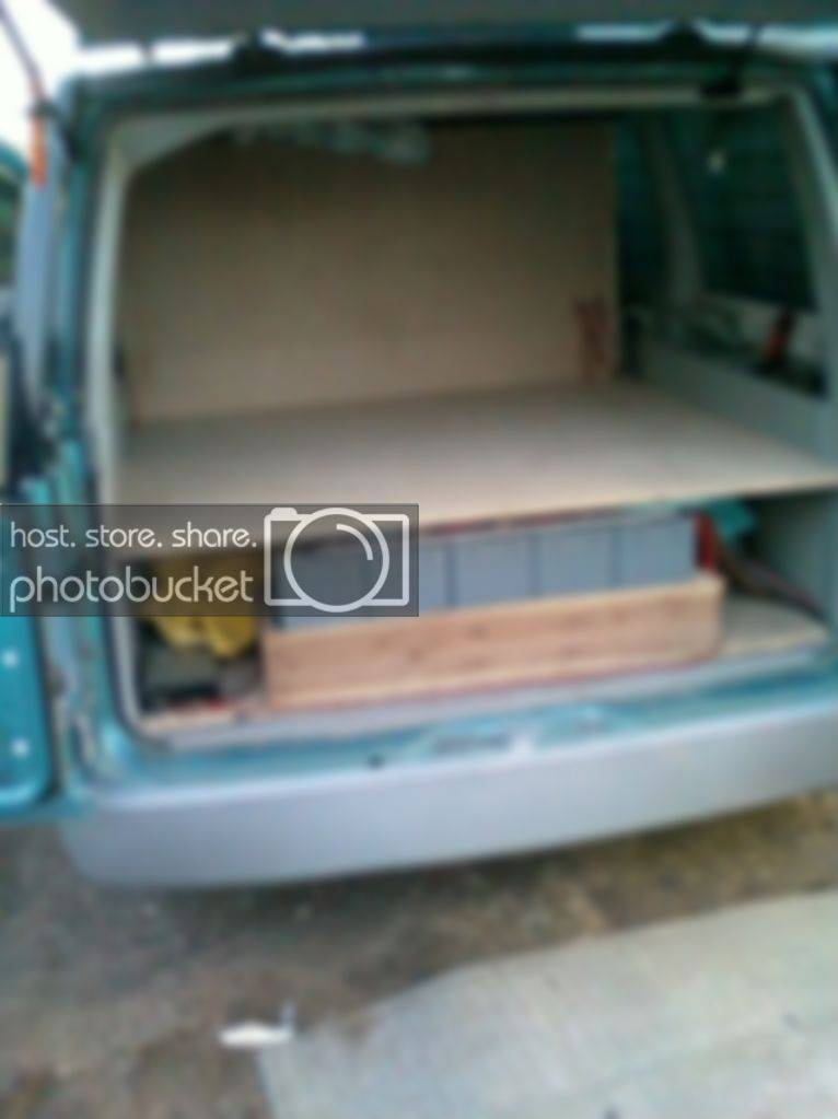

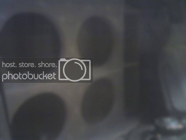

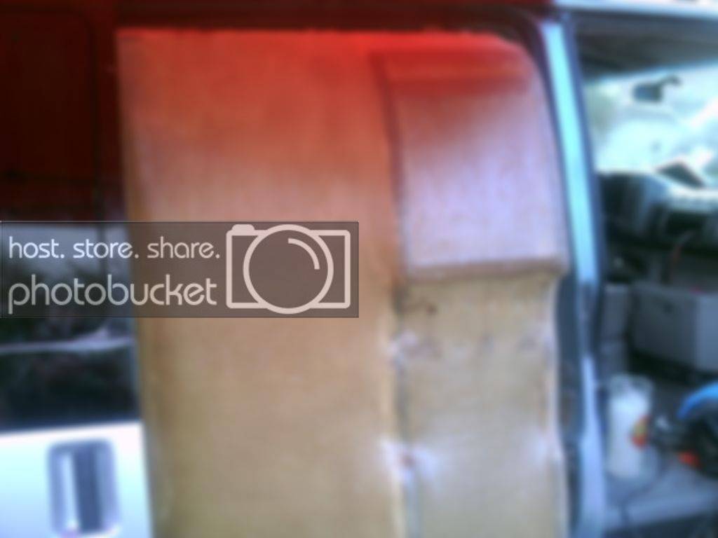

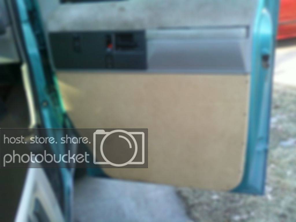

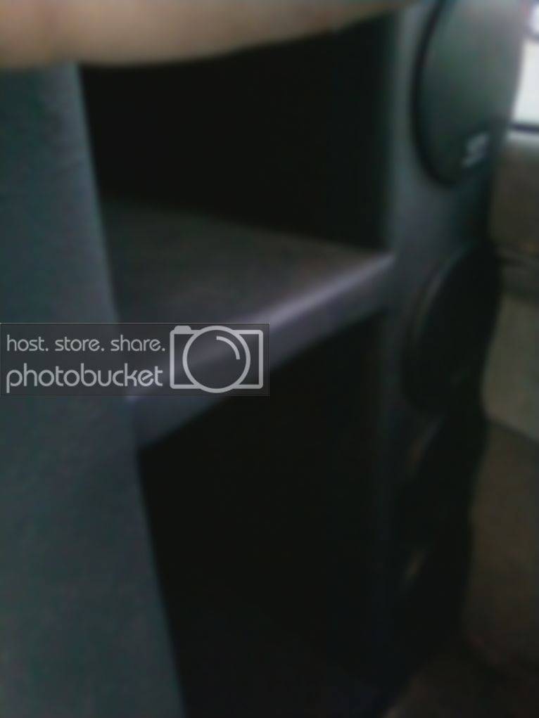

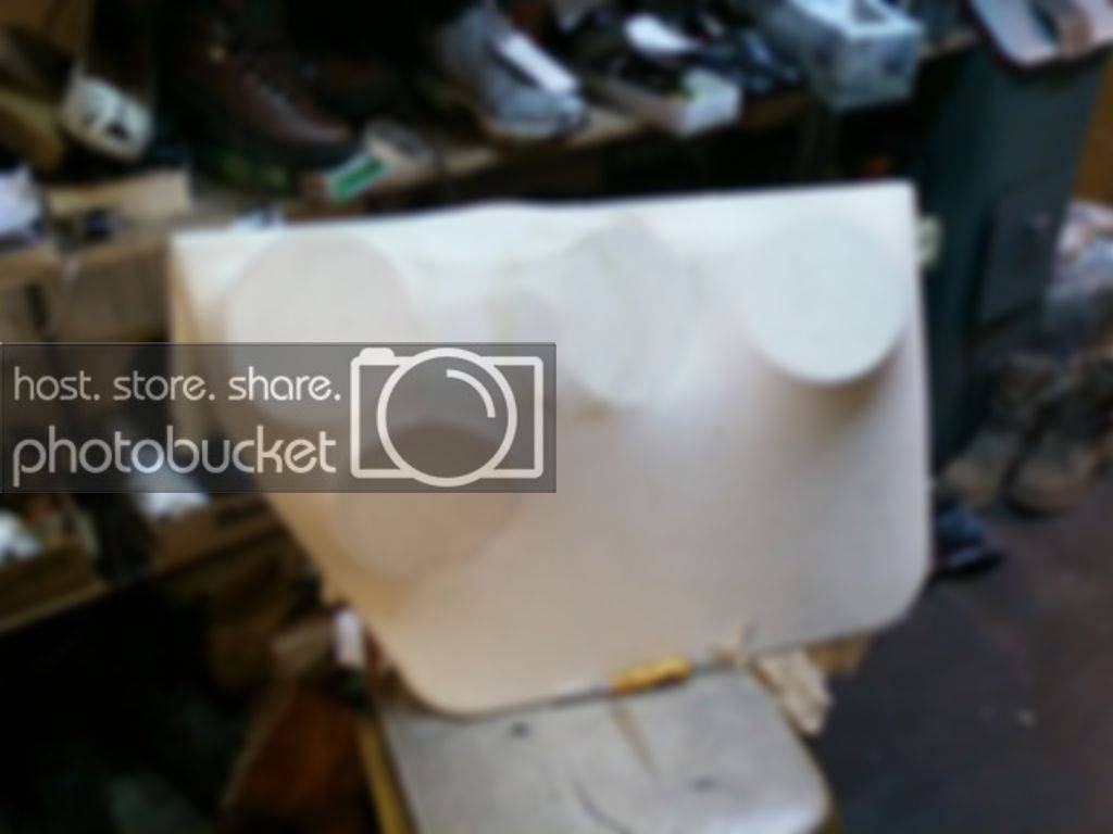

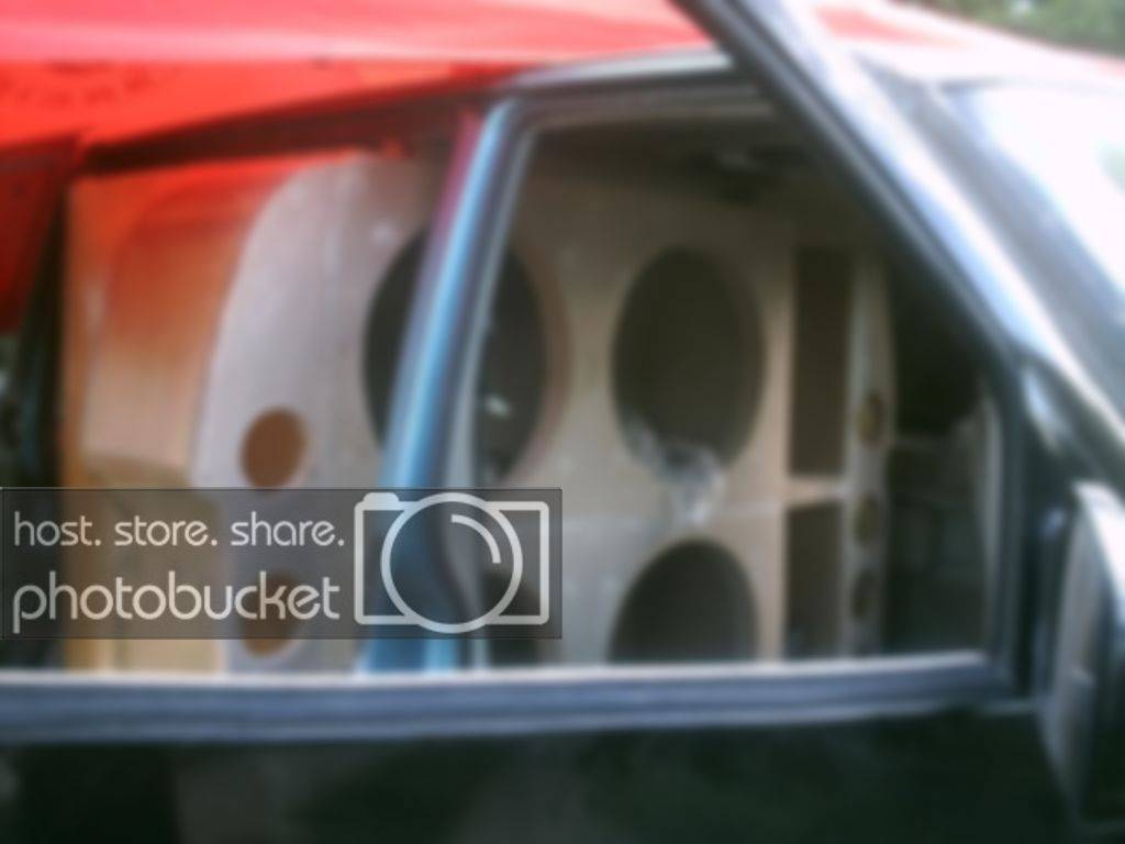

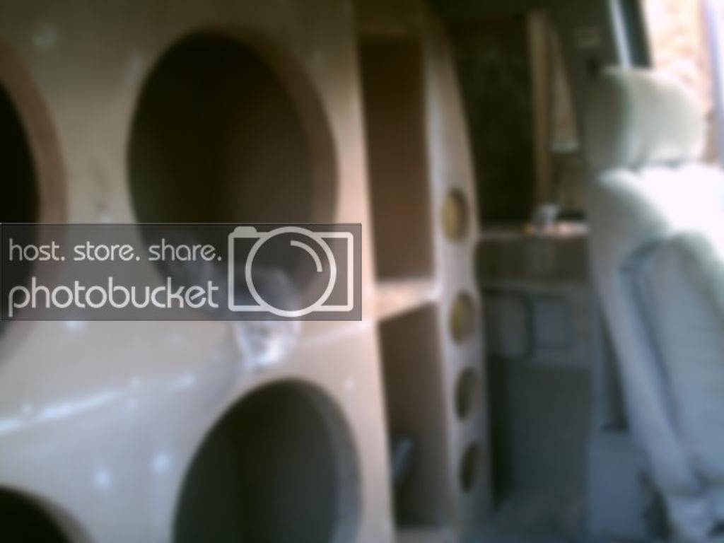

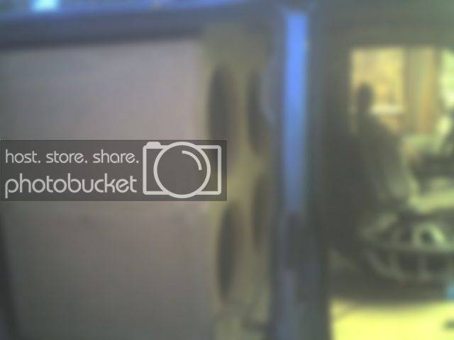

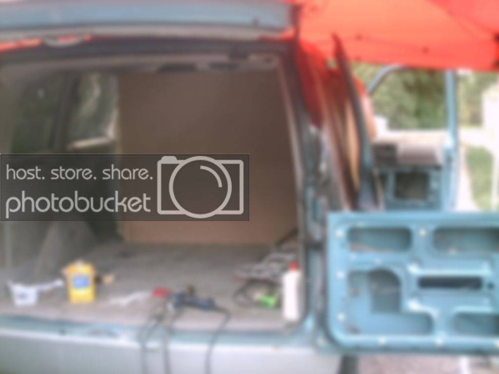

here is a new build log of my shit. just got the door panels started, and took a few pics. i still need to arrange them a bit different so they are not so close to the seat.
just got my Soundigital 16kw amp.

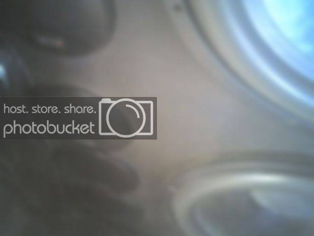

got all 8 mb quart 6 1/2s and tweets for up front
have 4 sets of mb quart 5 1/4 with tweets on each side of the box in fiberglassed pods that form to the shape of the van.
2 4125 mb quart 1000W 4 channel amps running my mids and highs.

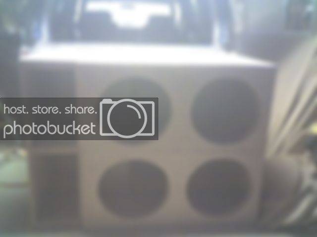

4 custom built konaki 18s in 30 cubes with port tuned to 27 hz

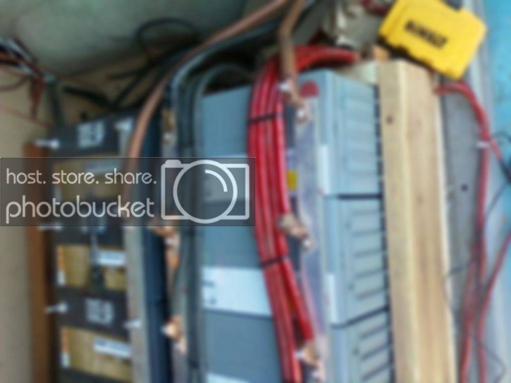

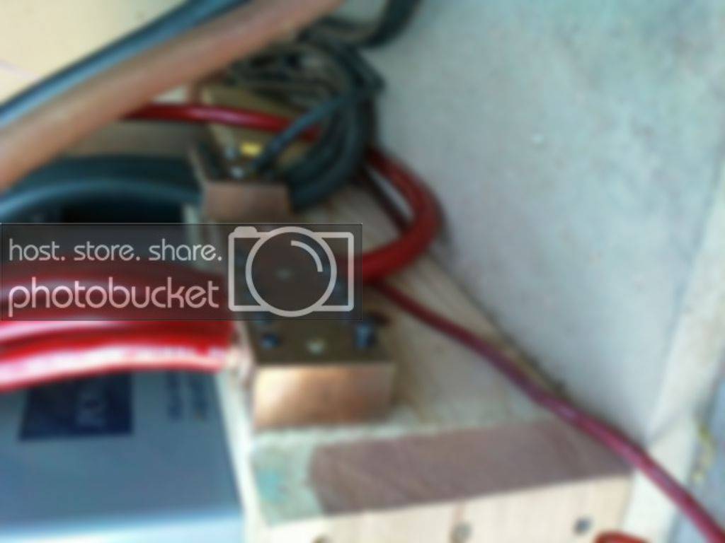

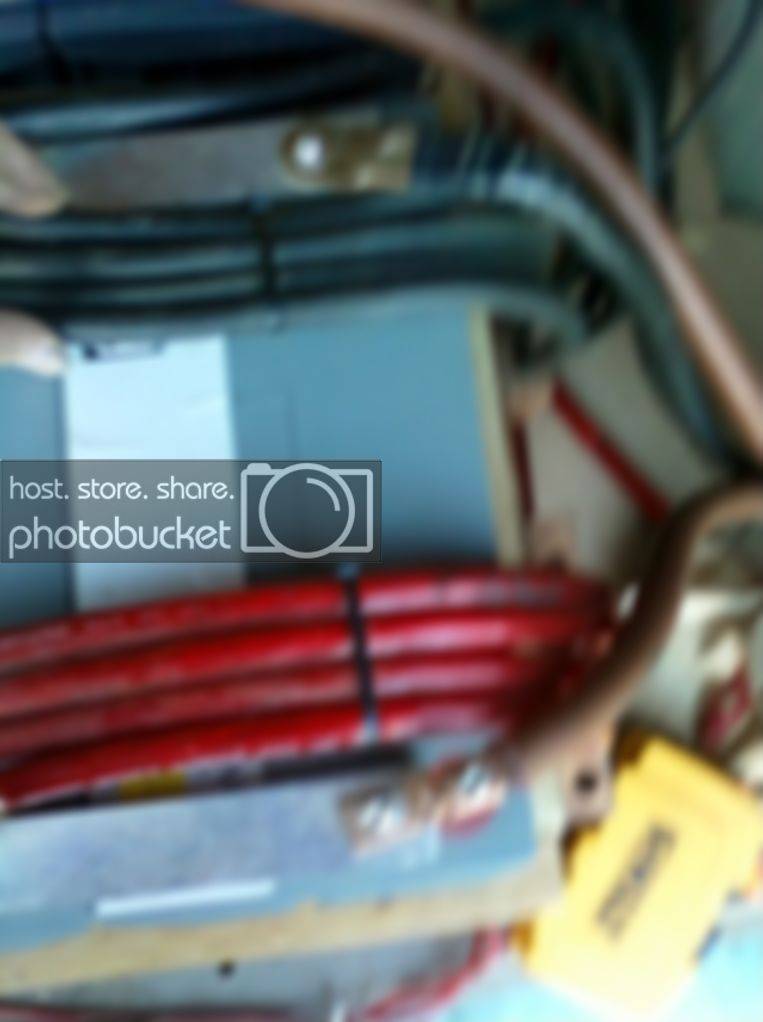

11 135Ahr batteries, 2 runs of 4/0 from the alt to the battery bank.
200Amp externally regulated 12-18 volts alt.
8 guage remote with failsafe circuit breaker and toggled to the main remote off the head unit which can be switched to just the circuit breaker (in case i put my amp in protect while doing my run i can just switch off the remote and turn it back on and have my amp running within 5 sec.)
2 layers of sound deadner stacked on the doors and another layer behind the door panels.
did a 155.2 legal with my old amps 2 hifonic goliaths at 43 hz
