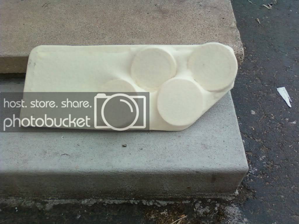

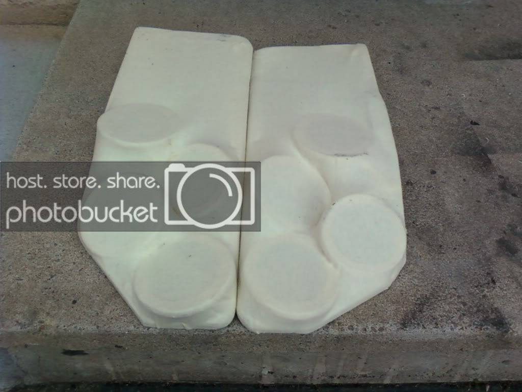

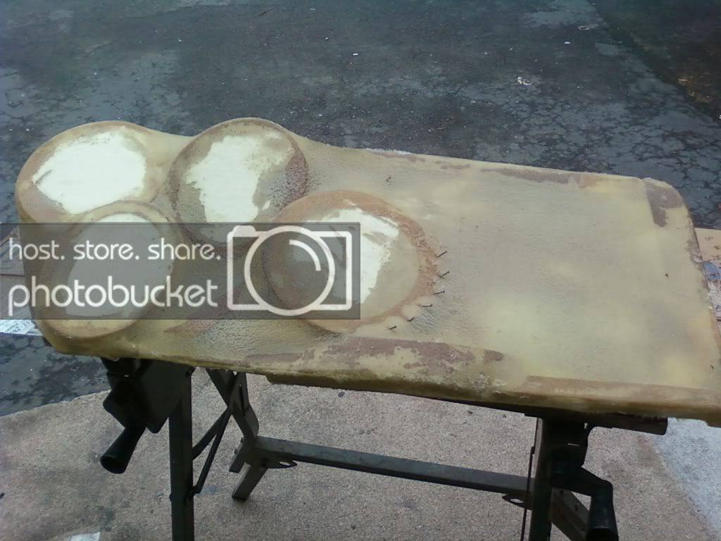

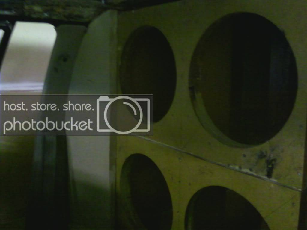

4 15s Walled in a Grand Cherokee
sub-FATHER
Resurecting this sport

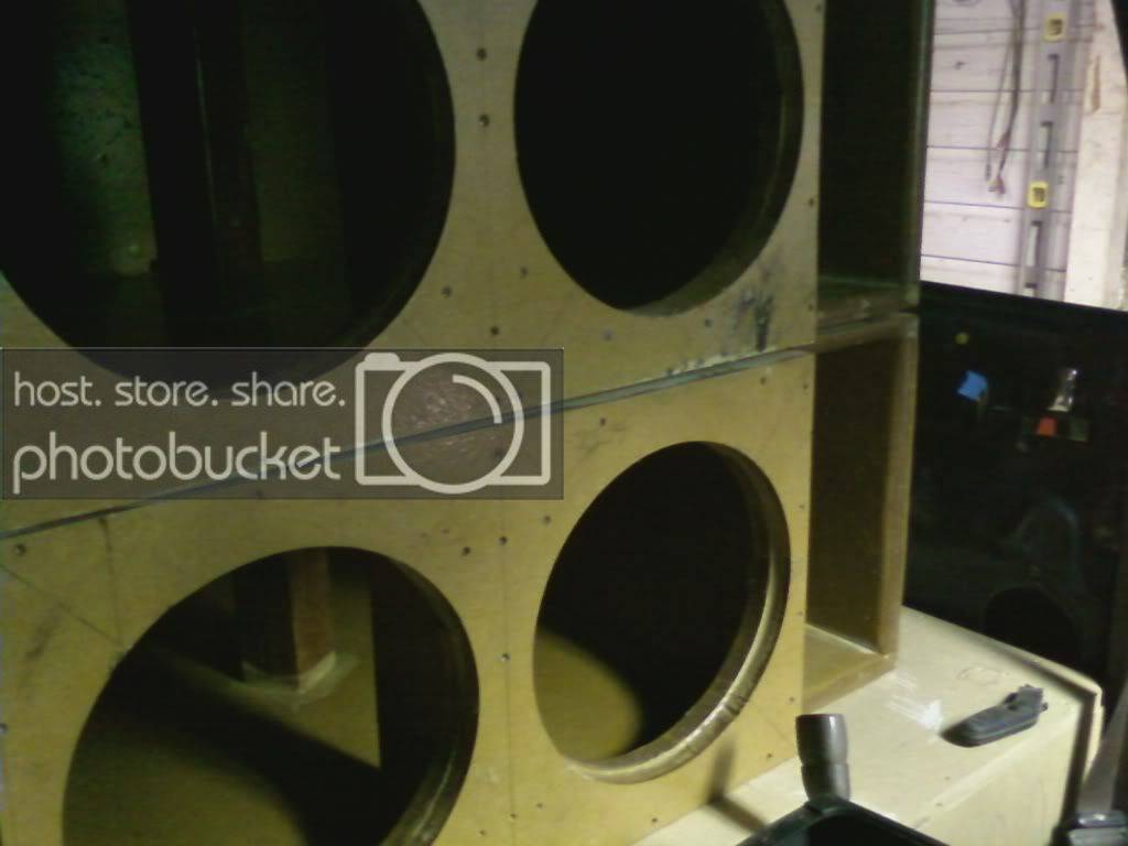

4 custom built 15 inch Rockford Fosgate power Hx2 subs
(8 layer flatwound coils with 4 stacked rf medium spiders each)
(Carbon fiber caps)

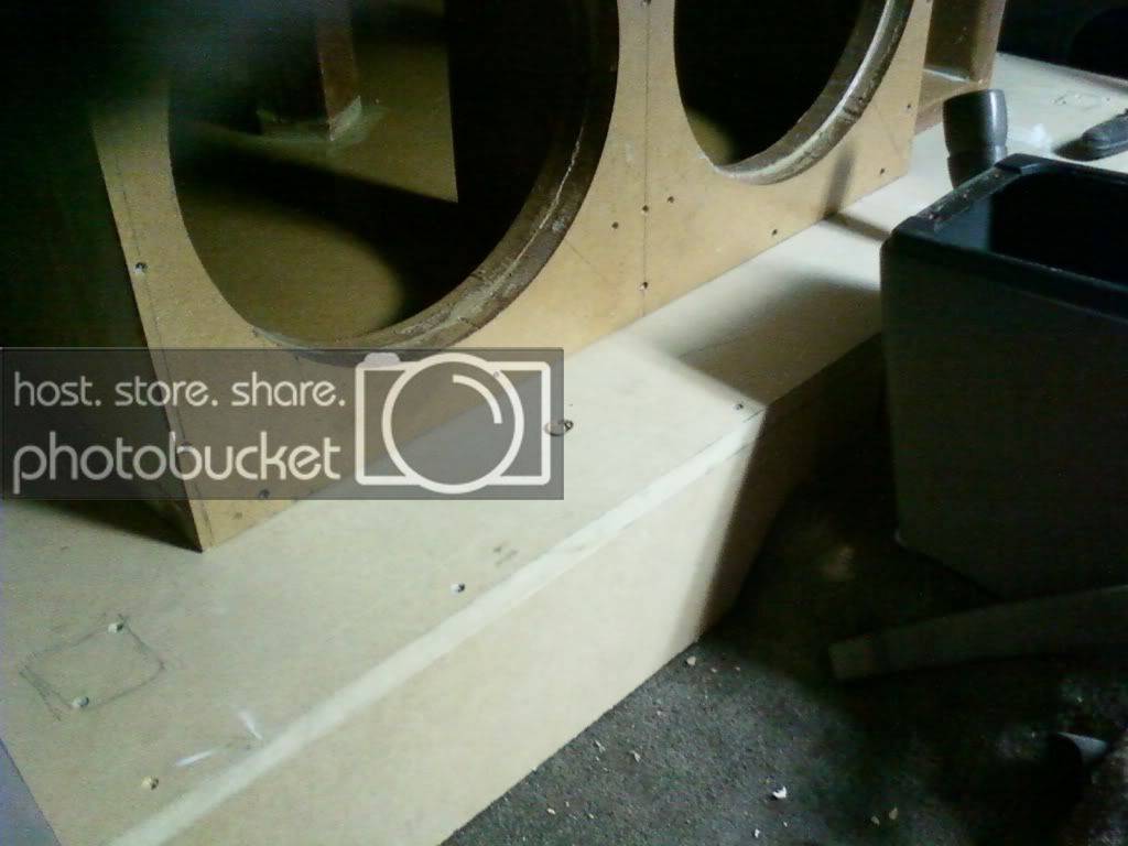

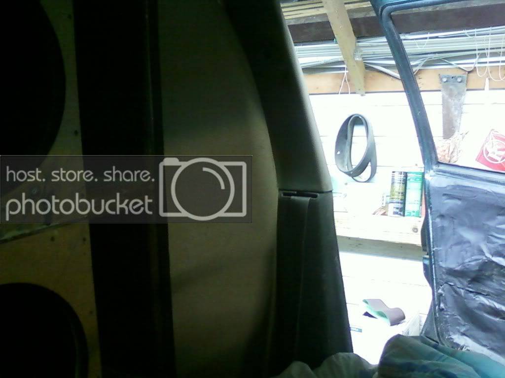

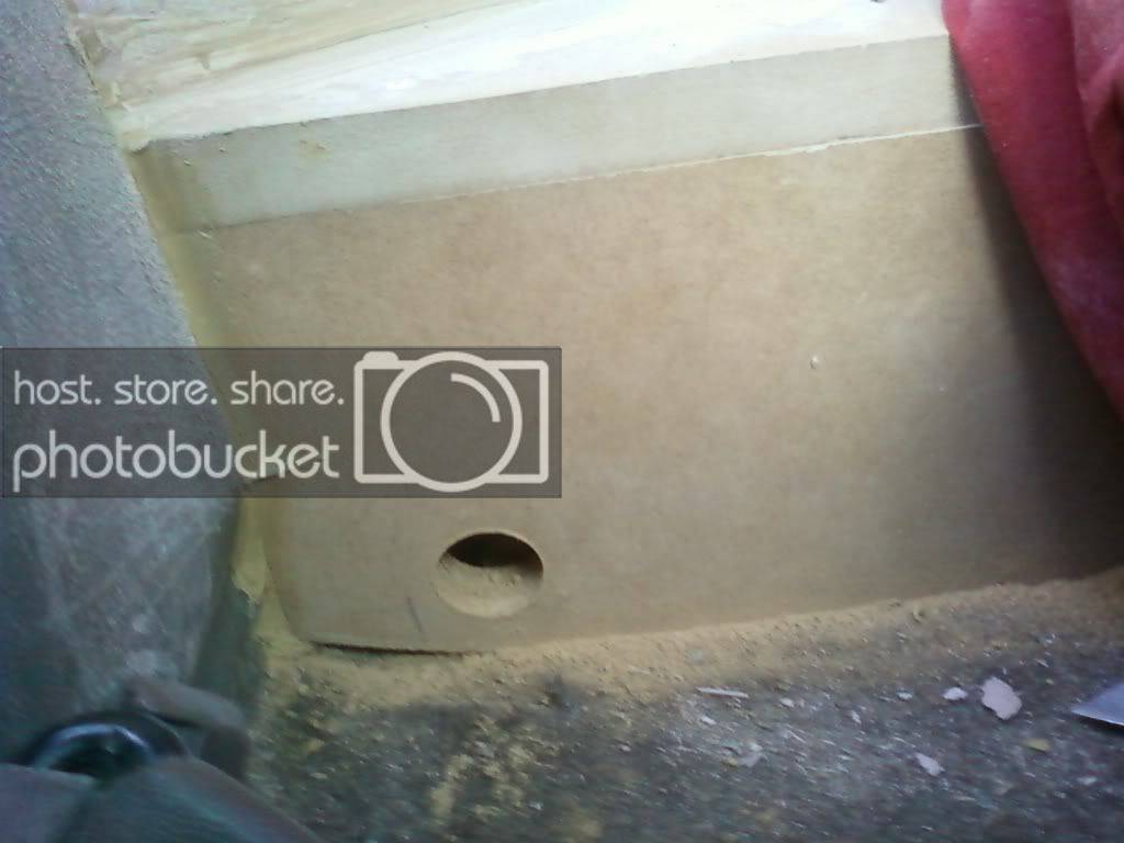

box has each sub has 5.2 cubic feet to work off of, 10.4 in each chamber and tuned to 35hz

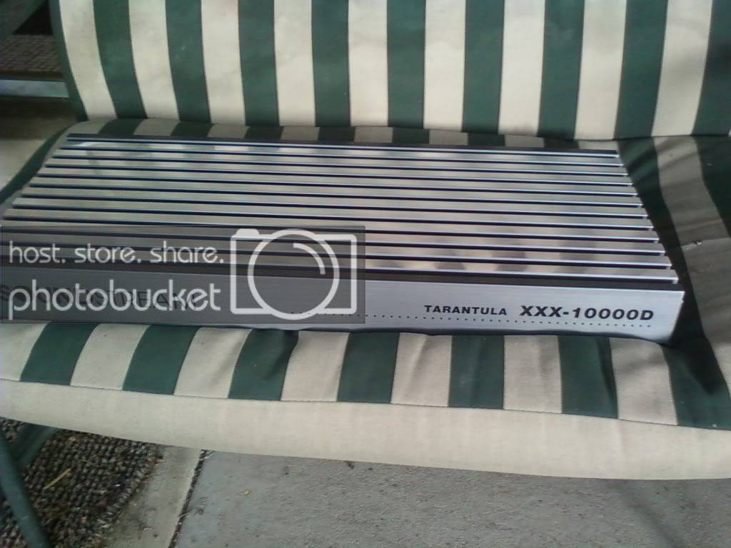

1 Soundstream XXX10000
2 alpine 4 channels MRV-f345 amps
mids?
tweets?

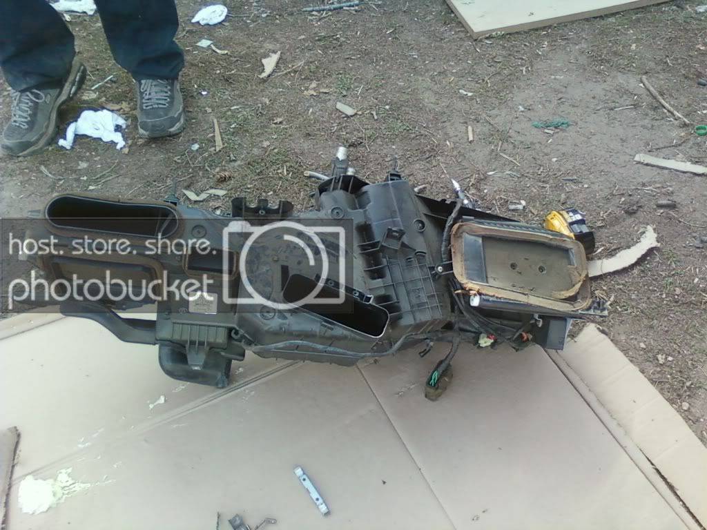

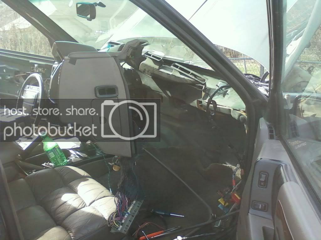

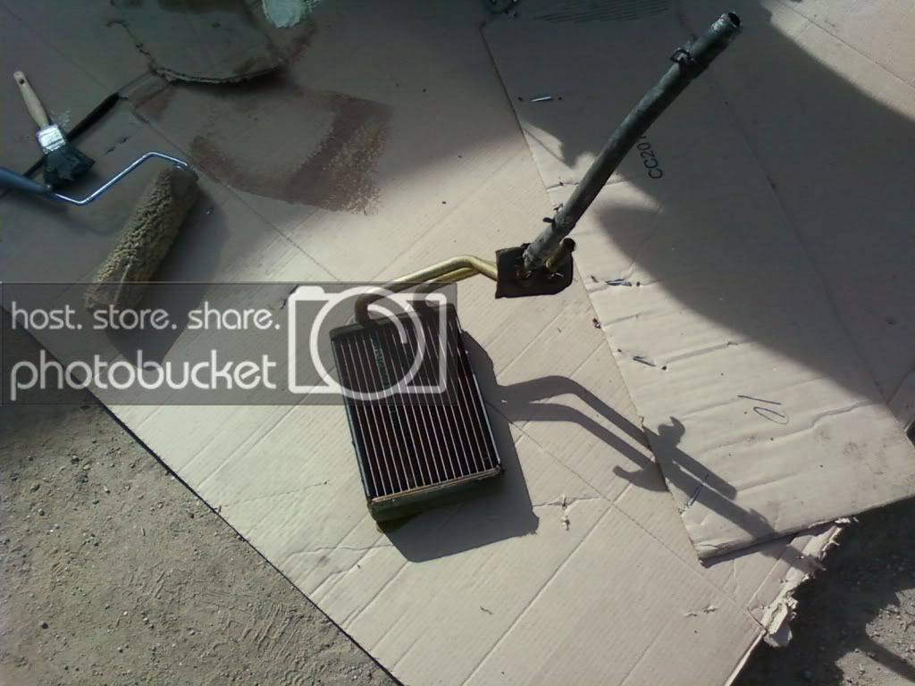

So here we started with the heater core

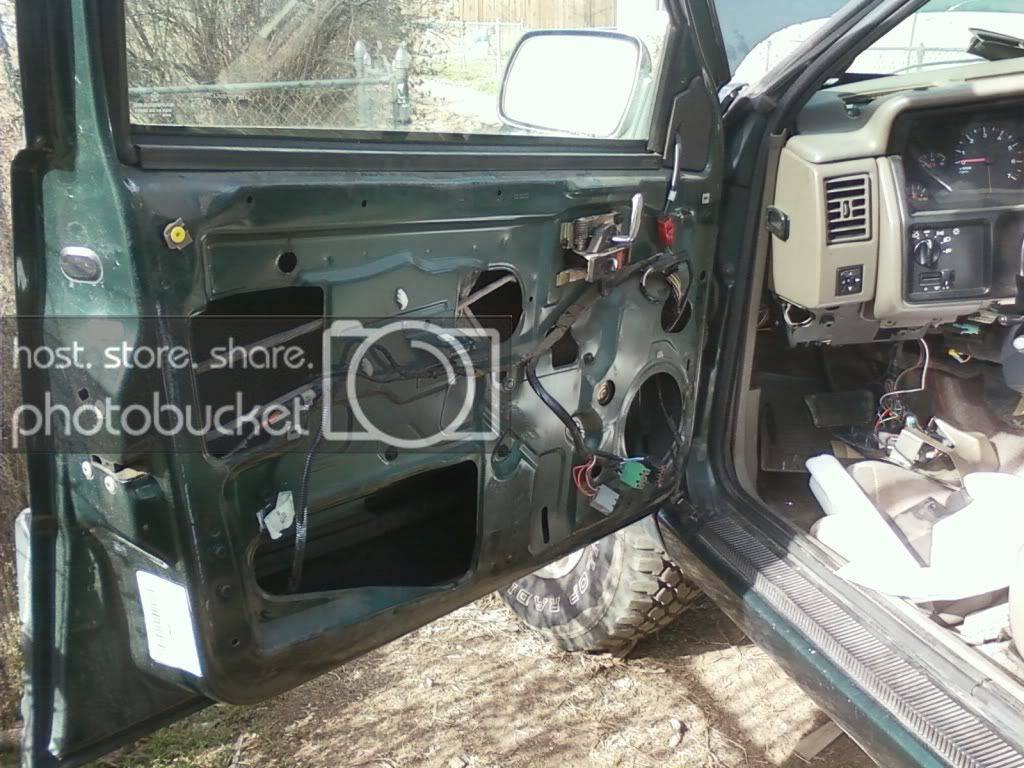

Sound deadening

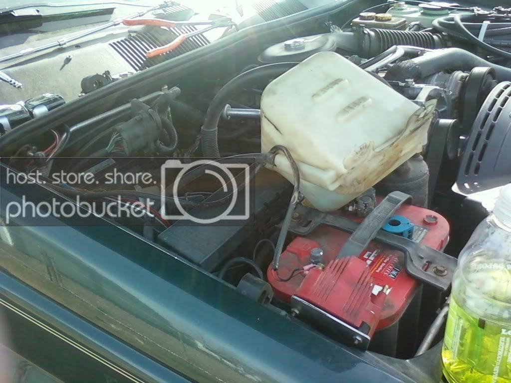

Running Power wires through the fire wall. 2 runs of 2/0 directly from the 240 H/O alt

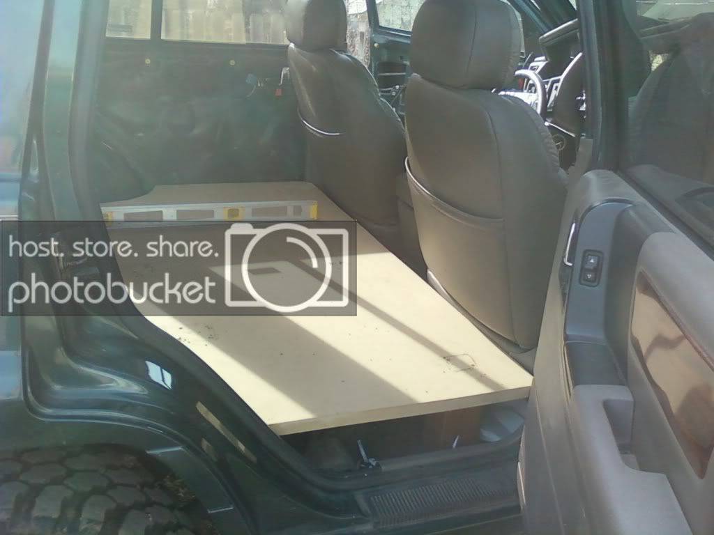

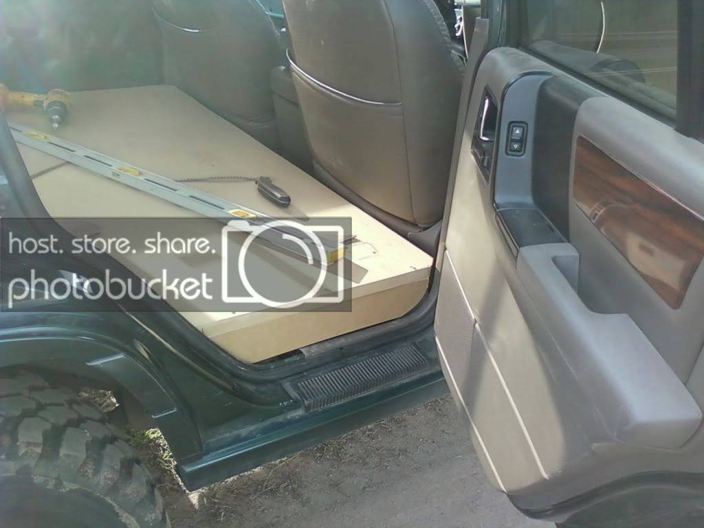

4 custom built 15 inch Rockford Fosgate power Hx2 subs (8 layer flatwound coils with 4 stacked rf medium spiders each)
(Carbon fiber caps)

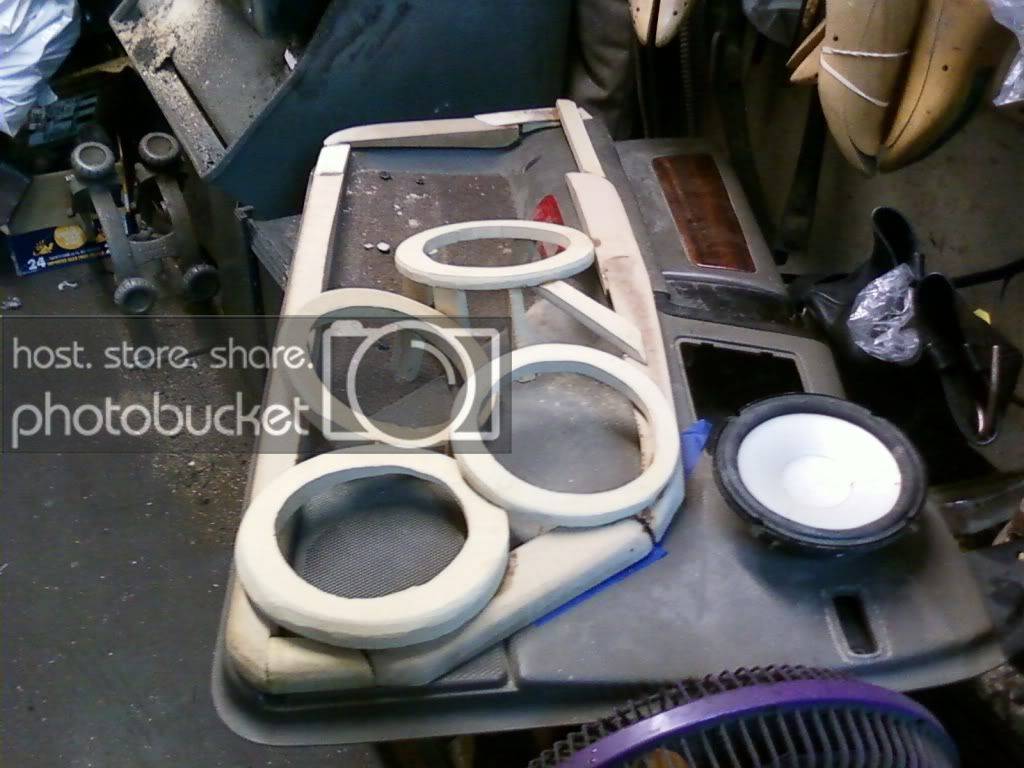

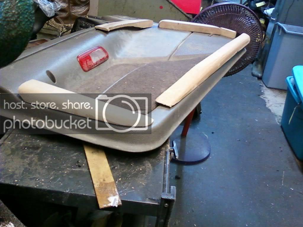

mids?
tweets?

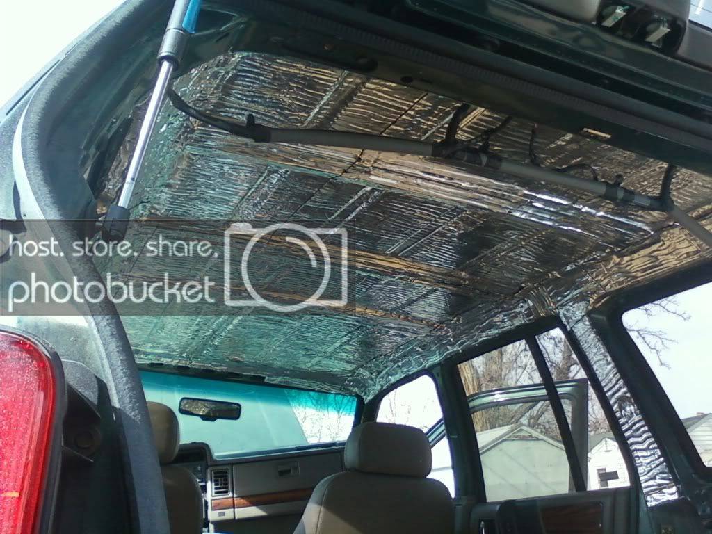

Sound deadening
