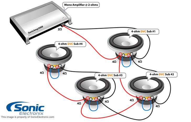

I have 4 kicker comp 12" subs and a 1000w SSL evolution monoblock amp thats 2ohm stable. i want to spread 1000w throughout the build, puting 250 watts per sub. now i want all the subs to run off the monoblock at 2 ohms, how would i go apon wiring that.?
If the subs are DVC you might can do this
That is 1 ohm.
If your meter is showing you 2 ohm then try this.
