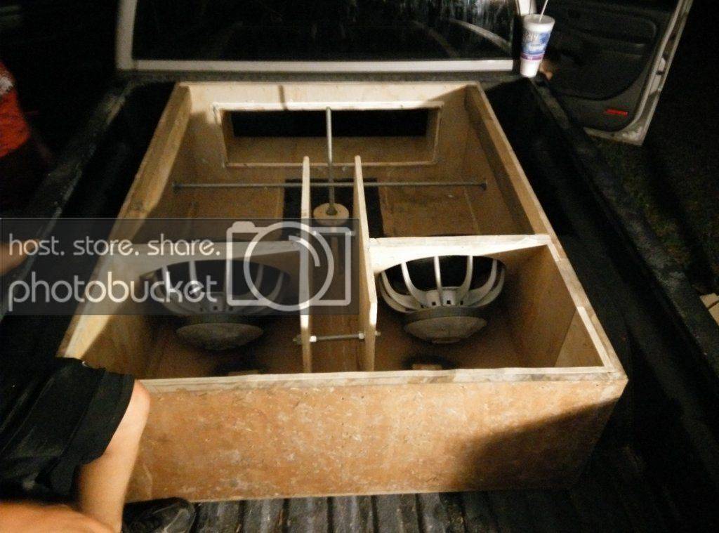

The bandwidth was amazing on this 6th we did. Team mate is really good with 6th orders. I loved it.

It was designed and built by Jason Medlock. I don't have any tips for you as I'm still new and learning about building 4ths and 6th orders and I was at work when this one was being built.

awwwww... there's something to be said for having fun with something like this imo. @mlstrass; sounded really good with his...

and holy god was it loud lol.
