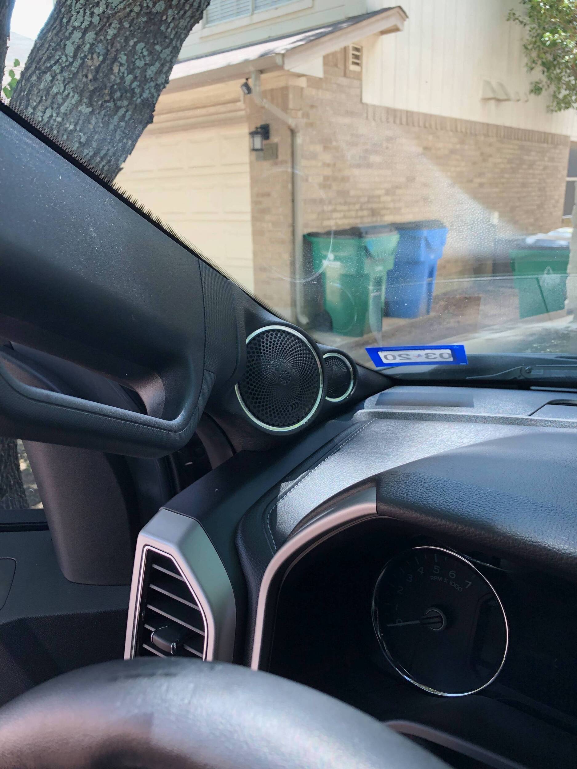

also.. I would put the crossovers either under each seat up front or under dash so they get some air to keep cool. DO NOT PUT THEM IN THE DOORS> Can Possibly get wet and get ruined
