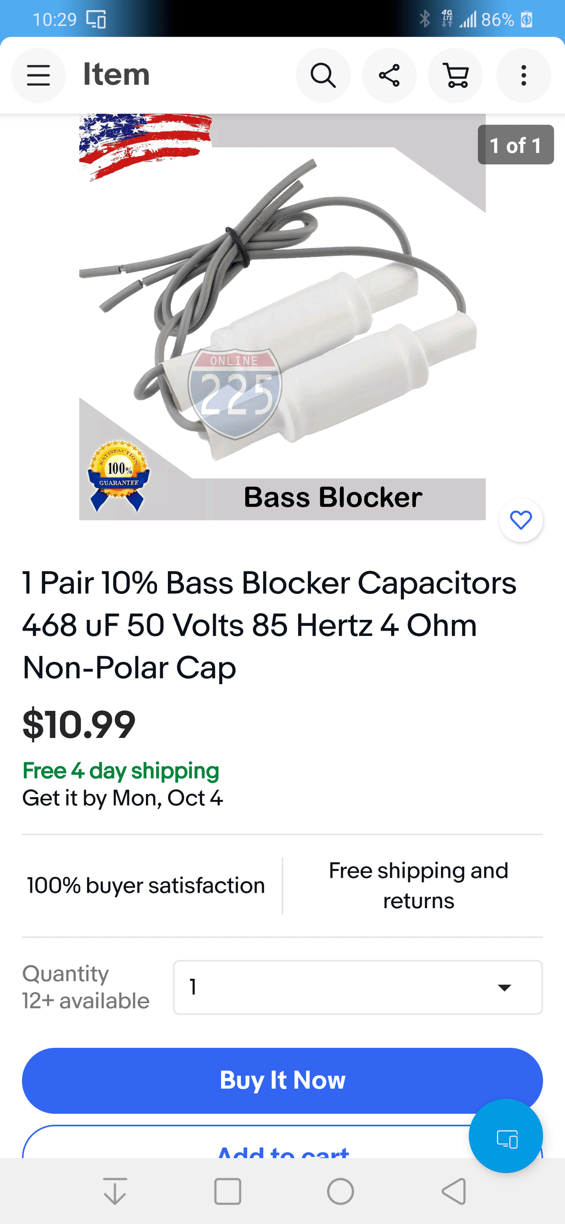

Just like Popwarhomie said, add bass blockers to the positive speaker wires behind the radio to protect them from anything under 80 hertz. These are them-
After that, you can turn up the volume without distorting them too bad. That is in ebay.
