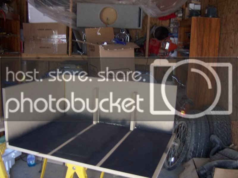

this time i decided to be a little bit more creative
it is for 2 Type R 12's running off a BXI2006 ( I believe) going in an older model Eclipse.
it is triple slot ported and tuned to 35 HZ, with 60 inches of total port area.

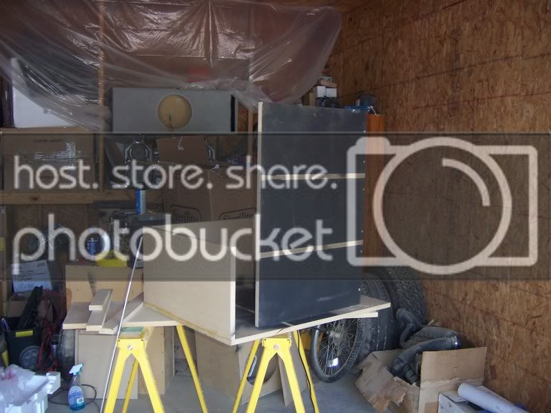

thats an inital pic of the port wall....

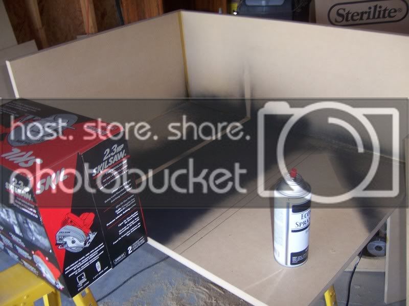

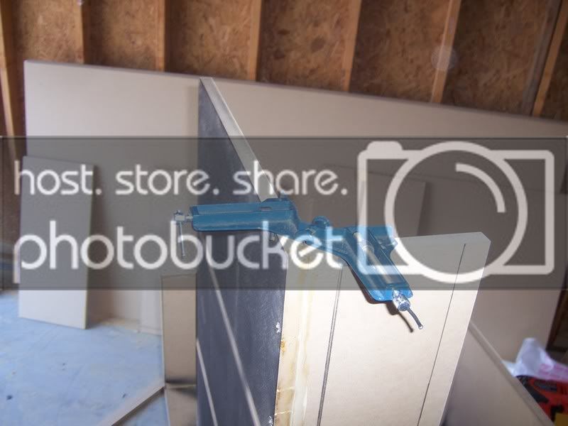

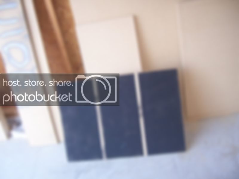

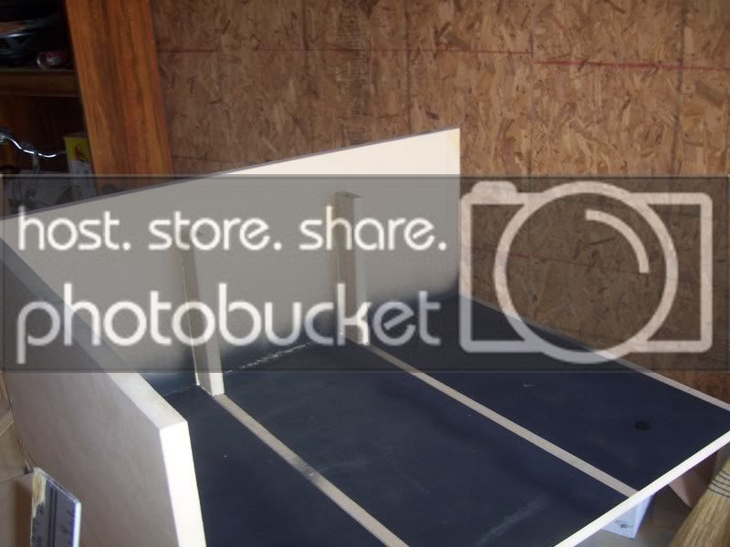

here are a few more f the build process.
Putting the port together
